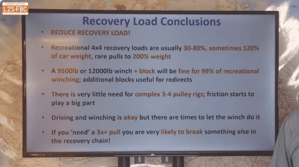

Since you haven’t responded to others I reinforce, go bigger than 8K for a few more bucks. The 8K became popular in the 2,700 lb CJ days. Your 4Xe weighs ~ twice as much.

A fully loaded overlanding build on 4xe will weigh around 6000-6500lb, heck even the lightest 4xe configurations hover around 5750+
I would advise getting a 12k pound capacity winch if possible. 8k winches are ok for light jeeps like TJs etc.. gas engine JKs and JLs usually call for 10k winches as bare min given their weight.

Thank you all for the input I’ll be checking a few other spots and try to find a 12k winch instead
