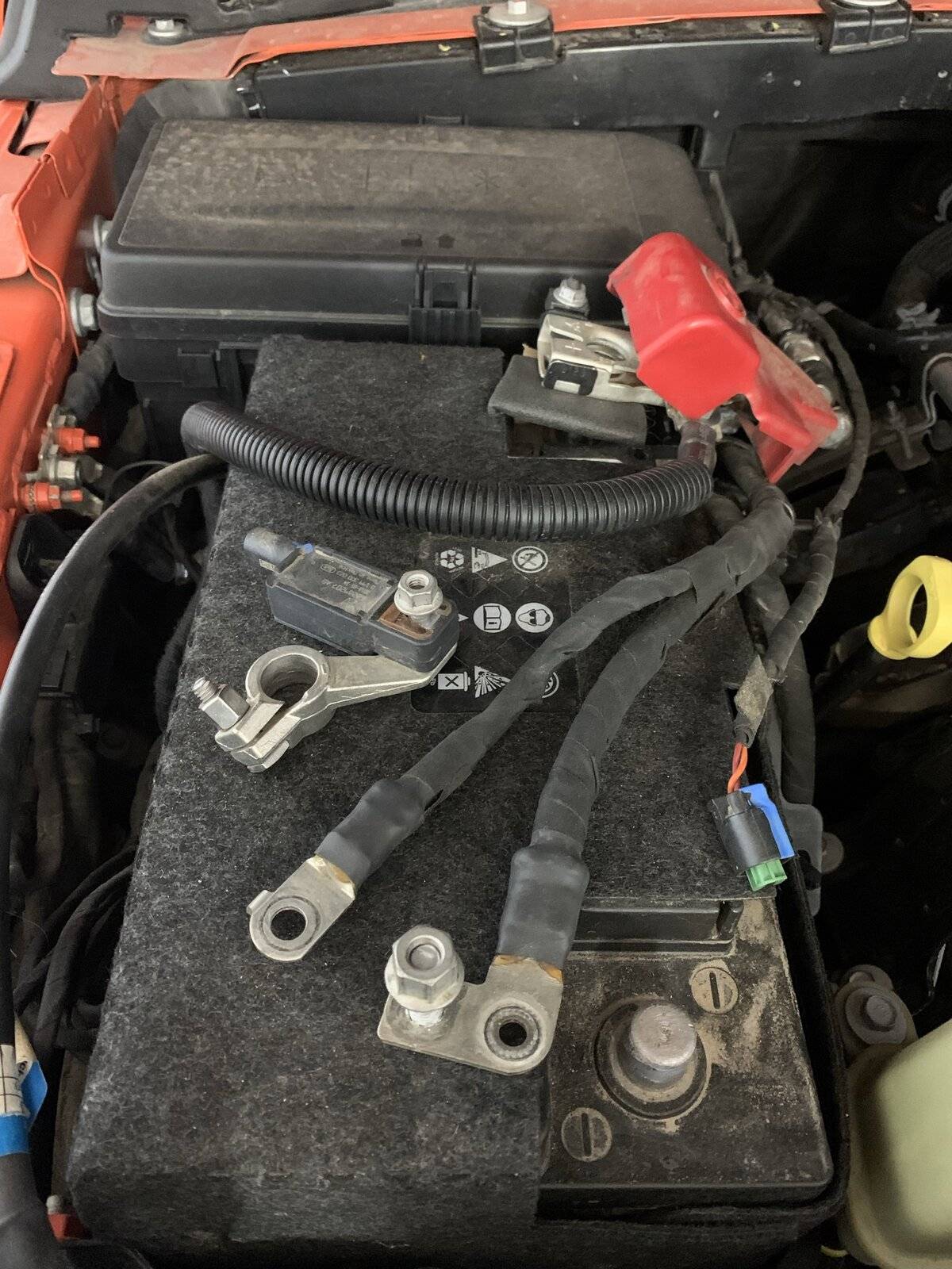

if I disconnect both the battery terminals on my battery, is the aux. battery still going to be connected? jsut want to make sure I don't fry my electrical system when hooking up my winch
You need to disconnect and separate the 2 wires on the negative side.

My plans were just to disconnect the terminals from the upper battery. I was just wondering if that was going to disconnect the auxiliary battery as well
No.
Do as @jludave said and separate the wires on the negative side as well.
No. Disconnect and separate the 2 negative battery cables. Keep them separate so that they don't touch.
You don't necessarily have to disconnect the positive side, but do it just to be 100% safe.

True. But if the wires being added/connected touch somehow, or the installer's tool touches something else that's metal, or there's a short in the winch, etc...
These things can happen.
These vehicles are very sensitive to anything electrical.
