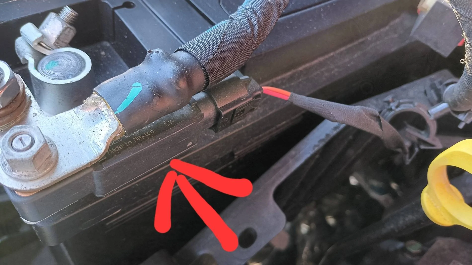

@azjl#3
You talking about this?
Its factory, I don't know what that's for. The positive terminal has a fuse on it for the winch.
