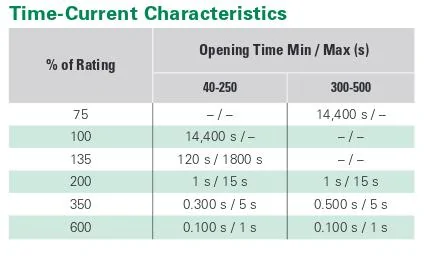

It looks like that chart is for Class T fuses from BlueSea but the table below is for Class T JJN, TJN and A3T fuses. I’m not saying this is *the* table for my fuse but the numbers are similar. They match up better than your graph.
With you running a 500 amp winch with 500 amp capable cables, and perhaps a stock alternator, I’d go with a 500 amp ANL fuse and certainly not a Class T slow blow. If you get in a pickle where safety of the circuit is a lesser concern, you can always stack your lead on the hot side of the fuse (absent a short) and hope for the best.
I didn’t go with ANL even though they’re cheaper by a long shot but I’ll be damned if I can remember why….LOL
You could still see up to 15s at 600A before your fuse pops, like I said you 650cca stock battery won't output that kind of power for that kind of time. And your alternator doesn't put out near enough amps to keep the battery from discharging in a hurry. I wouldn't test it with the sensitive electronics in the Jeep, but I'd bet you could take your fused lead right to the negative post and not blow your fuse.

Yeah for mine, the math came up to maximum 10 seconds.
Assuming our battery is 650 CCA, that means it is rated to put out 650 amps at 0 degrees for 30 seconds while keeping voltage above 7.2 VDC. As you probably observed when you were using batteries for welding, the amperage was mucho higher and lasted much longer than a few seconds. It’s that green arc flashing, plate warping, copper melting opportunity that I‘m looking to avoid.
