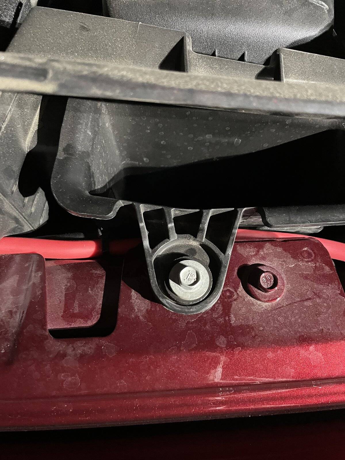

I also have a Warn EVO 10S and ran the wiring the same way. There was enough wiring to go around the air box not over it to get to the battery posts.
There really isnt a need for one and most people do not have one and are fine. When the winch is no running there is no current draw, minus slight draw if you have a wireless remote that does not have a switch for the winch side receiver, but that draw will be very small over all and your jeep will have no problem living with it. Those that install one its more as a peace of mind thing than anything else.

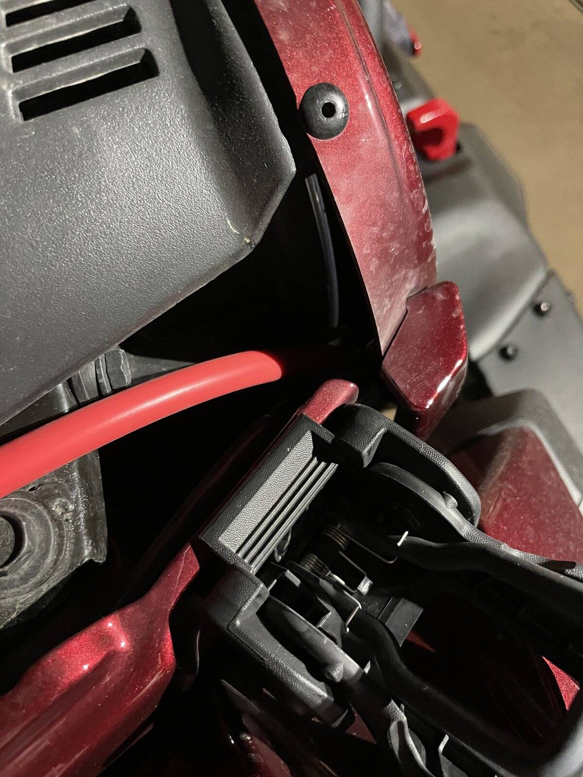

On the issue of wrapping the positive cable, I ran it through heater hose. It wasn't easy and made routing the cable more difficult but I never worried about the insulation on the cable rubbing through. It was probably overkill and I think I will use split loom this time. It is important to secure the cables pretty well so that they are not rubbing on any metal.

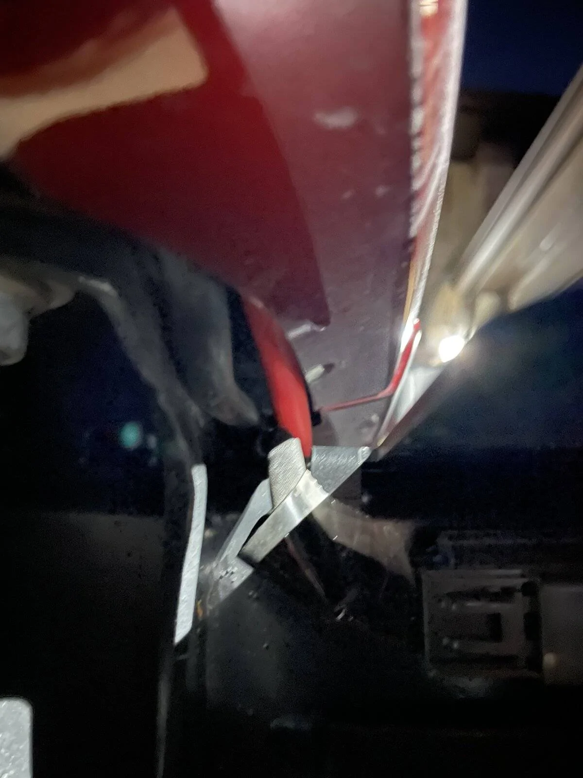

The wires through the fender channel with a metal hanger is a must! I also unbolted the air filter and ran the wires under there.

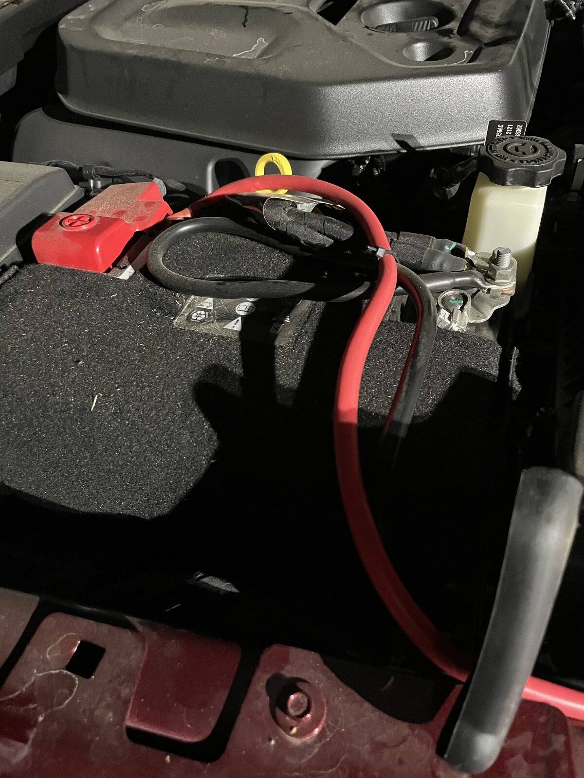

I'd consider a Blue Sea terminal mounted fuse right at the battery for the main supply line. You can get them up to 300A and they are relatively slow blow so can handle some spikes above that when winch in use. But if the cable shorts somehow it will blow and protect you from a direct battery short.
Then from that into the interrupter and the rest of the install as you have it.
