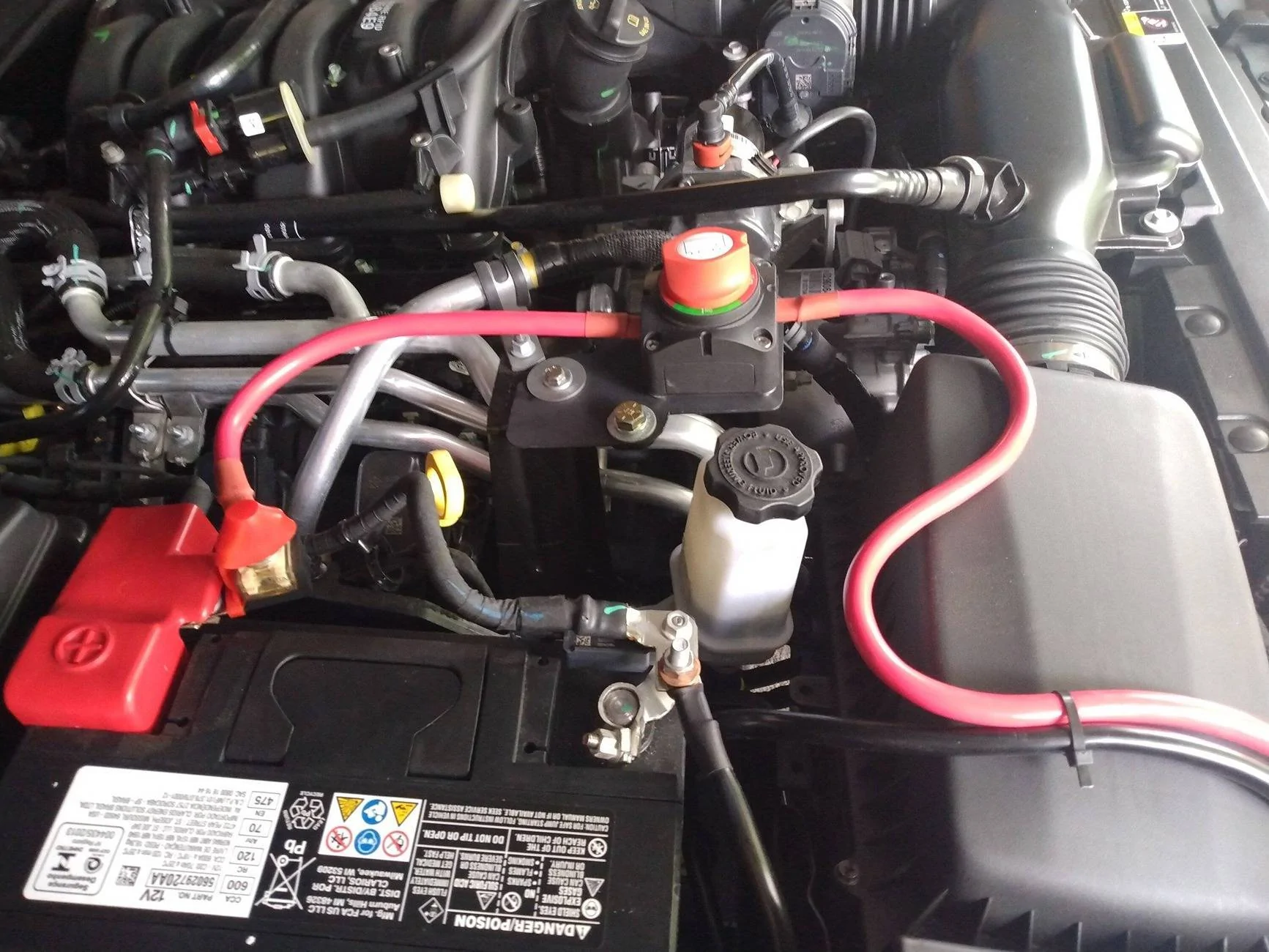

This is my current set up. (see photo) I have the cut off switch installed that came with my badlands winch. My previous badland winch did not come with a cut off switch, this was new to me. I almost decided not to install it. It seemed unnecessary but I had read an article that said something about, if a winch has a short it can drain a battery even when not in use. Around that time, almost 2 years ago a gentleman on the forum recommended installing a fuse for the winch to protect the wires which made sense to me so I bought this marine grade 300 amp fuse block & a spare fuse. The thought had occurred to me, why a fuse wasn't included but I figured better safe than sorry and I've always used some type of inline fuse on everything I installed in a vehicle, especially directly wiring it to the battery.
After reading articles the winch fuse is hit or miss, which came as quite a surprise to me, doesn't set well. I guess its fair to say had I known that, I probably would not have spent the money on it. Since I already have it and its been installed for almost 2 years now I'm going to leave it there. I don't believe its interfering with anything. From my inextensive reasearch regarding the amerage for the badland 9500 winch, I'm seeing max draw is 300 amps. My fuse is 300 amps. In theory the fuse should pop before the wires fry. In light of the new information I read, I question this theory and I'm not really sure how I could go about testing it. If it means hooking up my winch and throttling it to its max capacity over & over, stressing it out, stretching the rope to the thickness of kite string, hoping nothing snaps, or my front bumper doesn't come off. I'm not sure if I'm up for that. I am however wondering if I install a lower amp fuse. Maybe 150-200 amps. Do a few mild test runs to see if the fuse pops. Would this give some indication that the fuse is doing what its supposed to do?
It looks good John.
Like you, I don’t know how to conclusively confirm function short of direct shorting the fuse.
I guess a guy could put the fuse between jumper cable clamps and let ā€˜er rip.
I fear that’d be a great way to damage the battery and anything else that might dislike the clamps connected but yeah, you could confirm your disconnect and cables didn’t melt before the fuse flashed open.

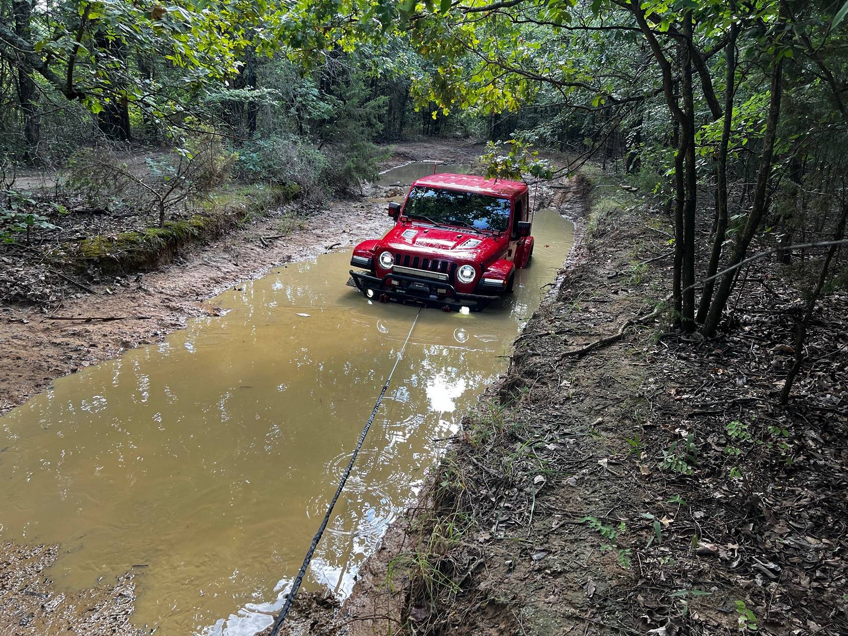

Here’s a picture of my differentials getting lubricated with Oklahoma clay. The suction would pull your shoes off. I was more focused on getting out than measuring amp draw but it ā€œfeltā€ I was close to stall on the initial tug, less once moving.
