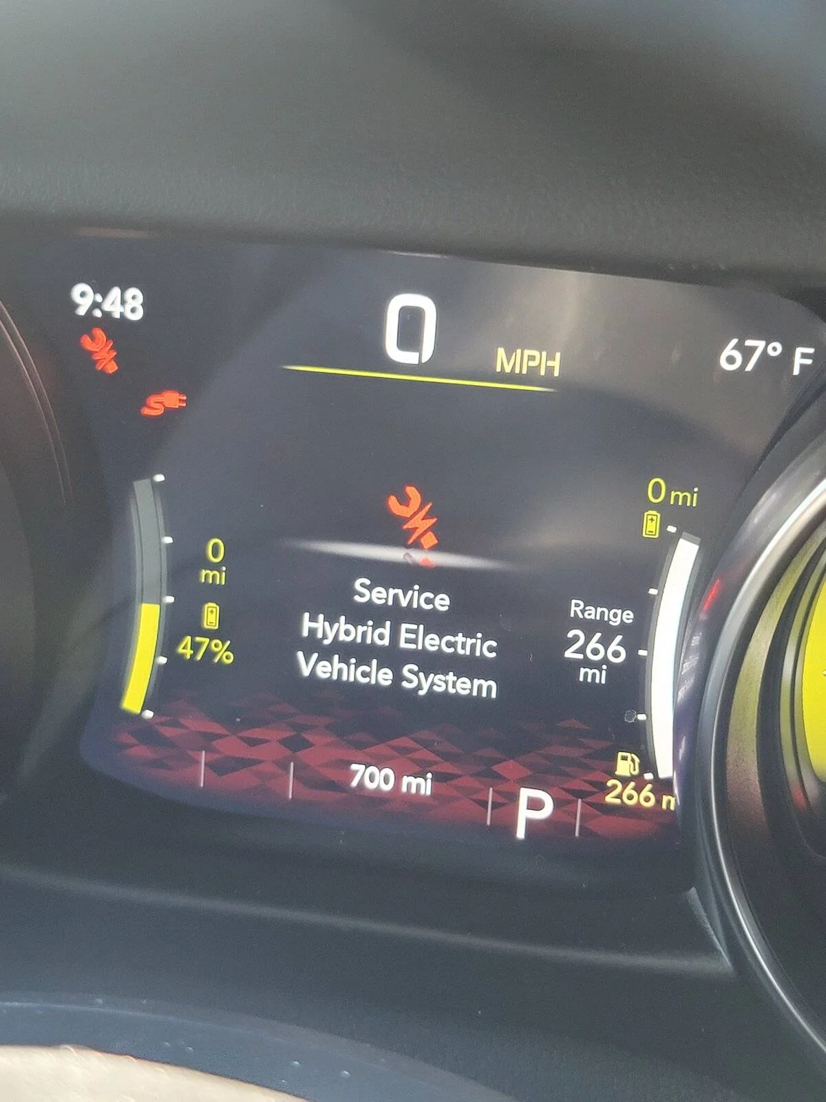

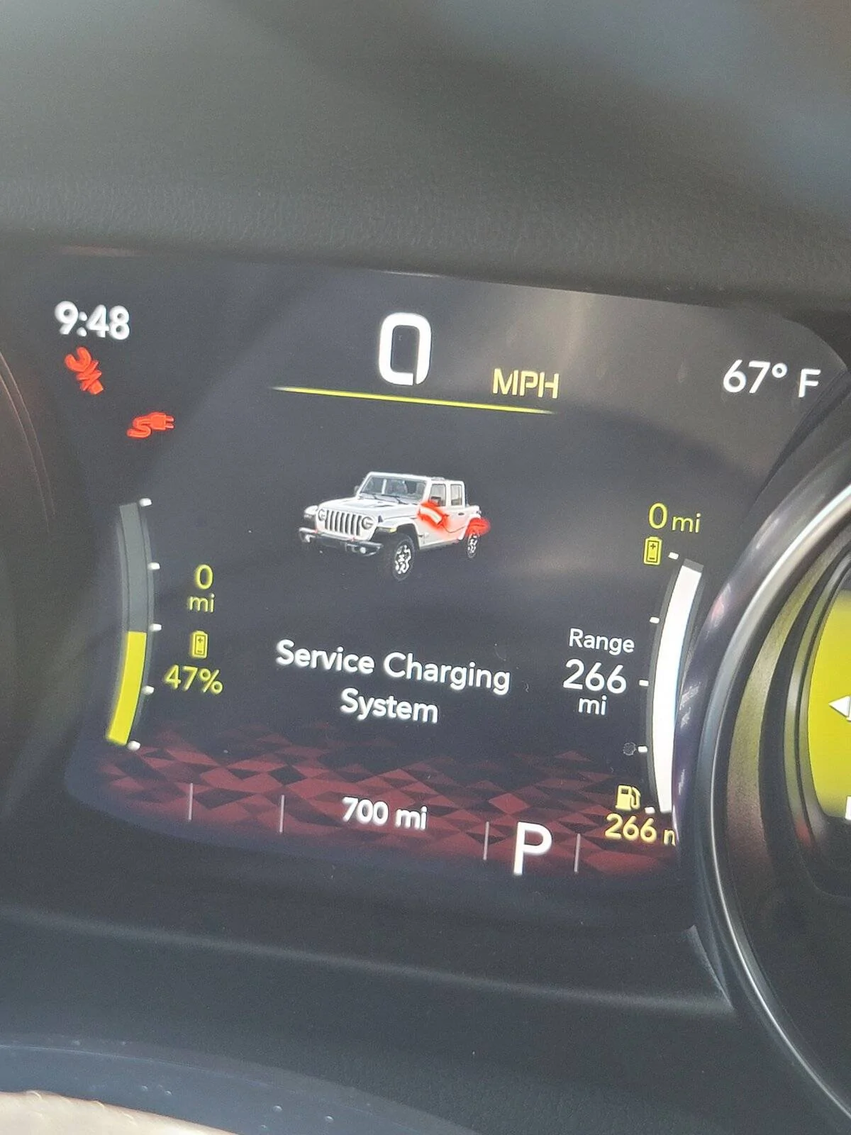

I wanted to add my JLUR with 700 miles to the list. Drove to get a MRI done got the service hybrid system error and it won't start...waiting to get it towed to the dealership.
Note not my first problem...roof rails had to be replaced with a crack and leak. Side alert indicators werent working as well....and yes all fuses have been checked.

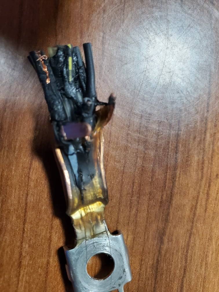

Little by little, Jeep is getting to solutions. After a long investigation, this harness:
was identified as the problem for a 4xe owner who's on the "Jeep 4xe Fans" facebook group. This is a lug where the wiring harness bolts to ground under the drivers' seat. According to the author:
"The factory crimping of a ground wire harness cut one wire preventing it from grounding causing the 4WD SERV light never to turn off. Since this part is made by a machine, Chrysler stated this will affect at least 1,100 recalls"
Jeep Wrangler JL 4xe Check Engine Light Issue (CEL) 4xe grounding lu
(reposted with permission)
Ours is part of the "high voltage cable" recall but have not had any issues yet fingers crossed.
