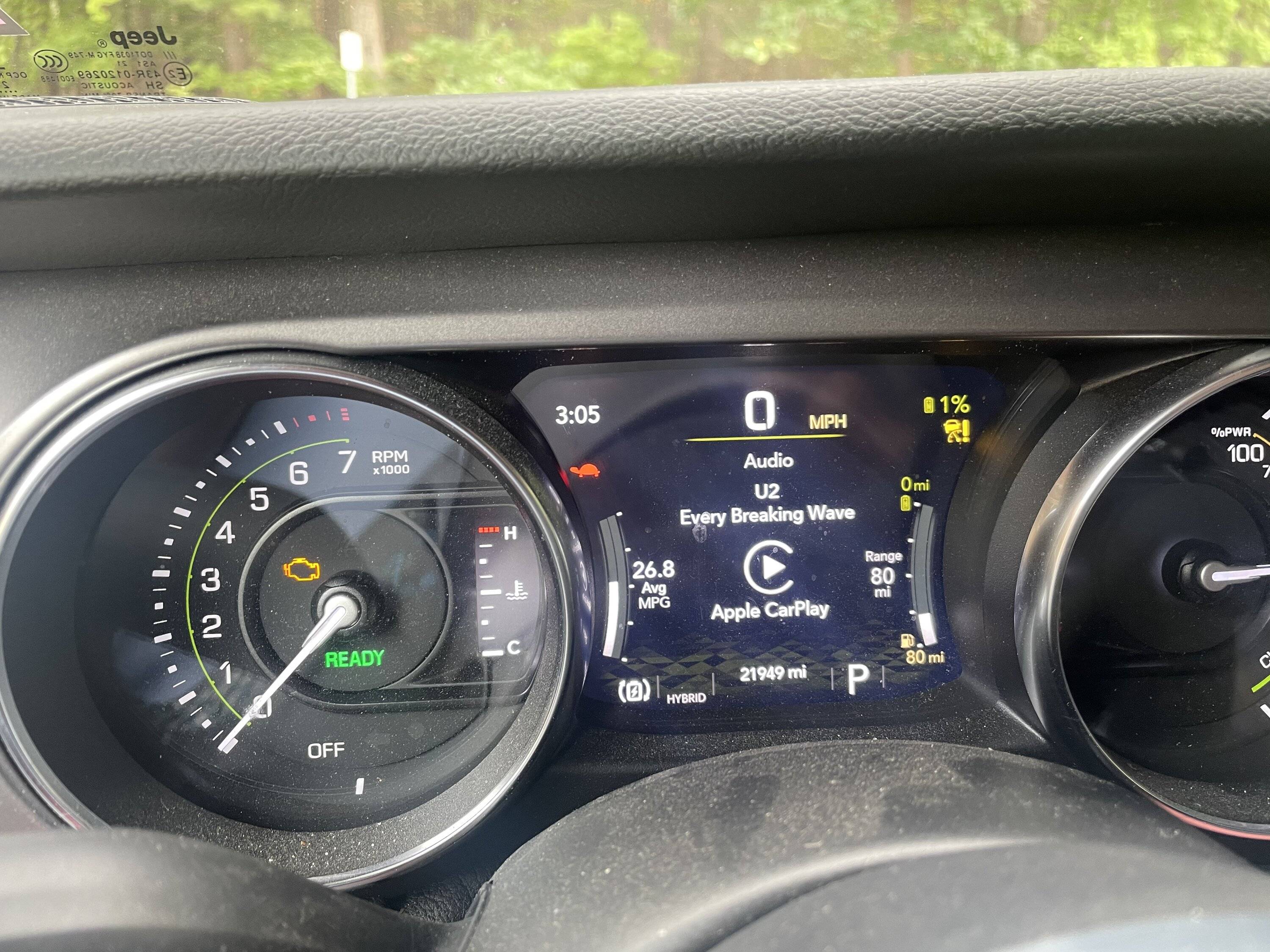

Hi everyone,
I came back home after being out for 8 days, and my Rubicon 4xe did not run. The red turtle, check engine and acc lights came on. I am also experiencing an extremely loud fan noise, even when I connect the level 1 charger. I checked all the fuses and it’s still not working, I am planning to tow it to the dealership tomorrow. Any advice??

pull the negative terminal on the 12V battery, and keep it disconnected for 10 minutes. Then reconnect it, and plug your charger in (assuming it reaches - don’t use it with an extension cord unless you have a very heavy duty one). Good luck. My happy day was when Carvana bought my 4XE last month….

Hi there! We are very sorry to hear of your concerns and would recommend a dealership visit. If you need an extra layer of support while there, please let us know.

Did you check the 12v battery? It may have died while you were gone. The main batteries are terrible across Jeeps lineup.
