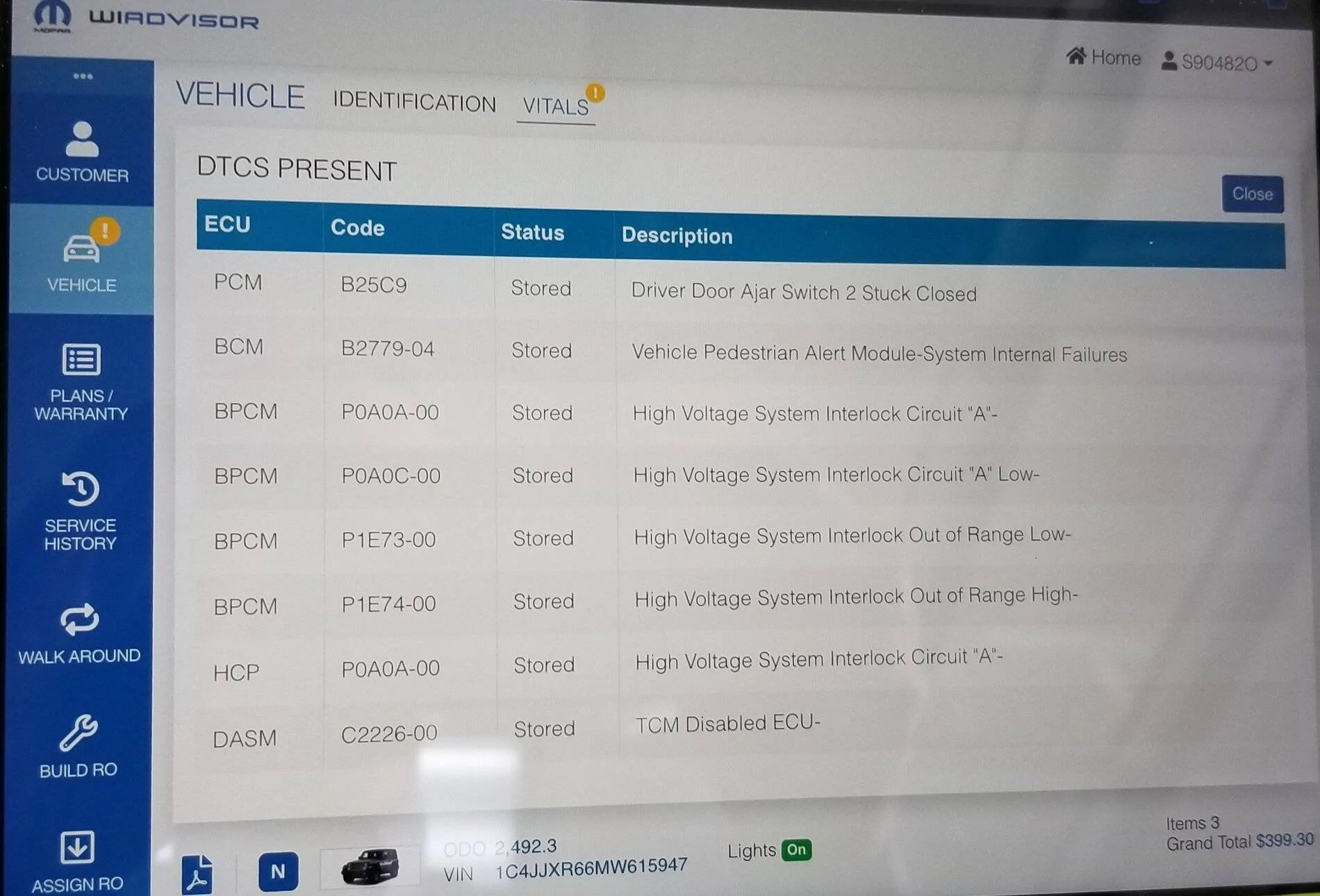

I brought my 4xe to an area dealership nominally for an oil change and get the codes read. The service advisor told me these engines are filled with break-in oil and so I really should wait for more like 7500miles rather than the 2500 I am currently at...of course this advice may have been related to their online appointment system snafu. They gave me an appointment at 4:30, but all their technicians go home at 4.
Regardless, he was able to read the stored codes for me. Most revolve around the HV System Interlock. My guess would be a bad connection or malfunctioning sensor to me. Note there are both High and Low range warning messages.
The vehicle has been driving normally - with the exception of the auto park repeatedly triggering (see code B25C9 below) while I was slowing to a stop. My Jeep was rolling on 37's at the time and filled with a 37" spare and all the stock tires & wheels.
Also, I suspect the Pedestrian Alert Module failure occured when the tire shop disconnected my spare tire mount in an attempt to place a 37 there...I told them it wouldn't fit, but that message never made it back to the tire tech's.
Jeep Wrangler JL 4xe Check Engine Light Issue (CEL) 20210702_CEL Codes
The service advisor suggested I keep the battery charged up to near full capacity and run it on gas as much as possible. Right...Kind of defeats the purpose of having a plug-in hybrid.
Trouble codes (see image above for descriptions):
ECU Code
PCM B25C9
BCM B2779-04
BPCM P0A0A-00
BPCM P0A0C-00
BPCM P1E73-00
BPCM P1E74-00
HCP P0A0A-00
DASM C2226-00
My plan for now is to keep driving it and make sure I have sufficient food and water and my hiking boots in case it leaves me stranded out in the woods somewhere.
ECU Code
PCM B25C9
BCM B2779-04
BPCM P0A0A-00
BPCM P0A0C-00
BPCM P1E73-00
BPCM P1E74-00
HCP P0A0A-00
DASM C2226-00
