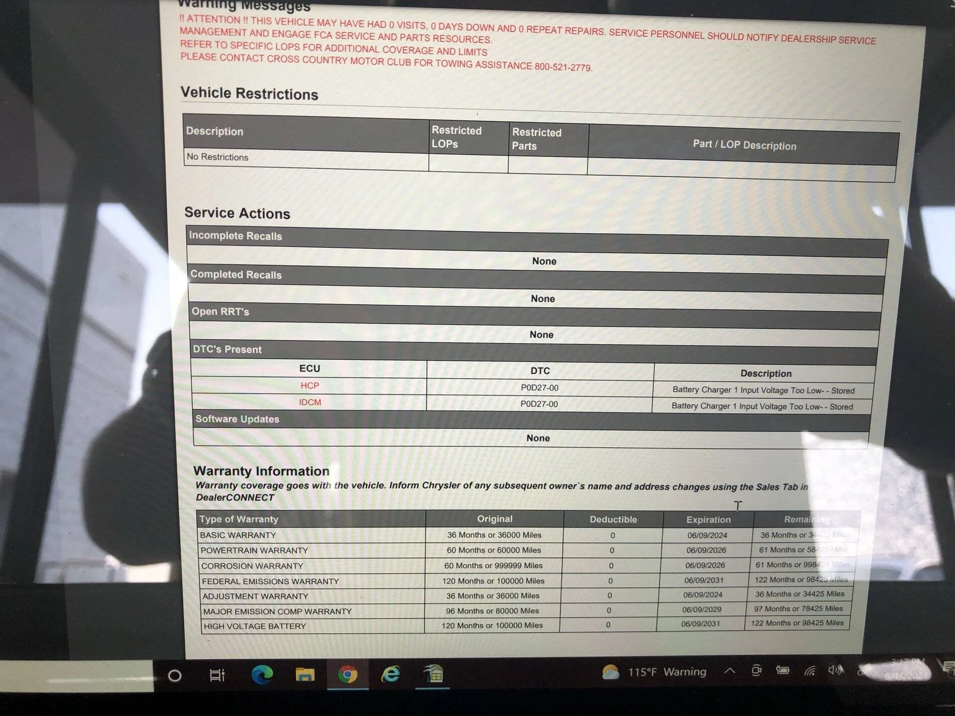

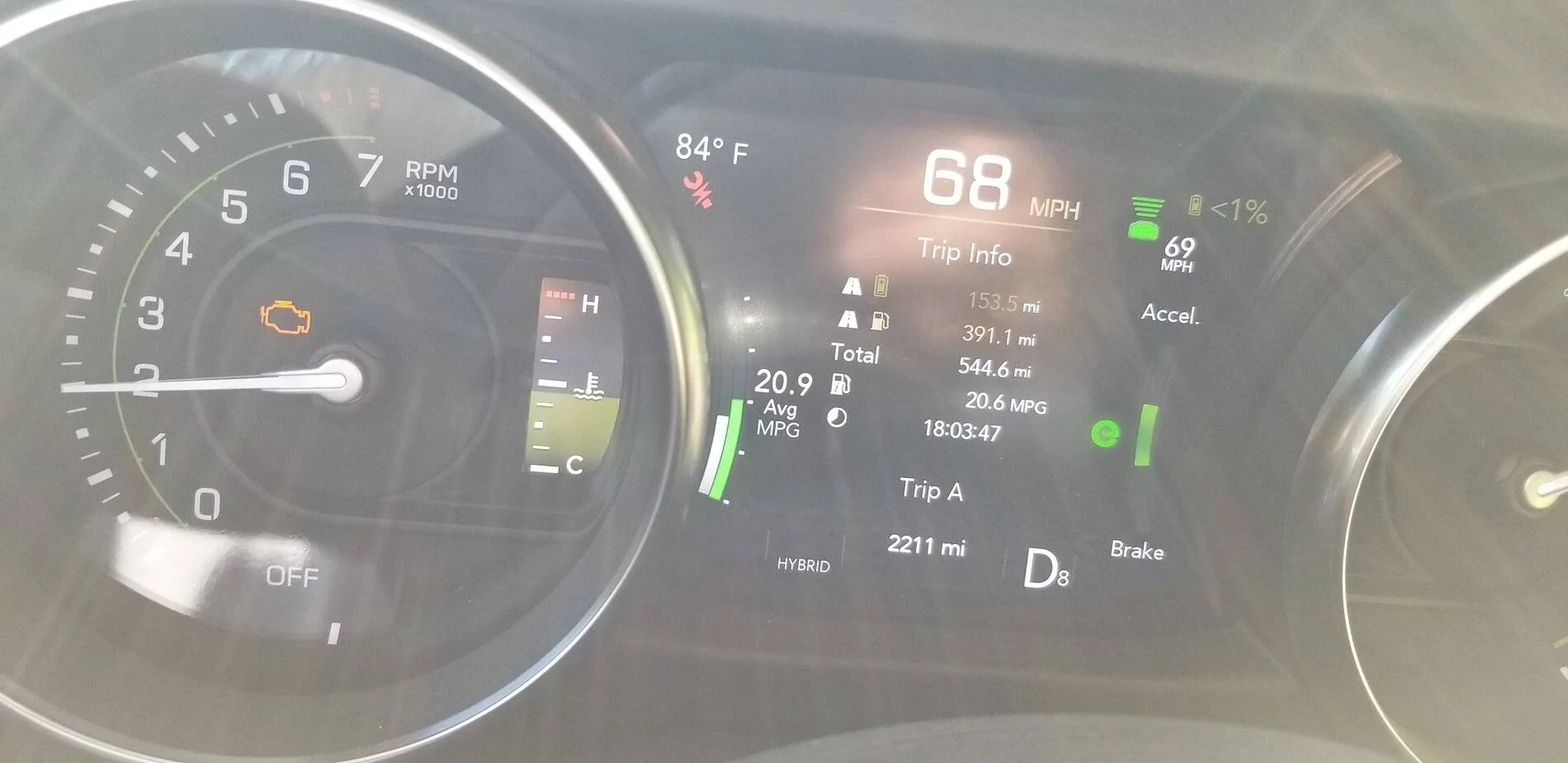

We've been having some hot weather up here when this occurred; much hotter than normal. The first time I saw the warning light, I was about 10miles up a steep, forest road with 4 passengers and all our camping gear. The second time, I was alone, but it was about 105F driving on hot asphalt at the hottest part of the day. I wonder if the battery just got too hot? It will be interesting to see if the dealership can pull any stored codes.

Thanks for the suggestion. The battery reservoir (and BSG reservoir) look to be right at their max. level.
Please keep us updated!
