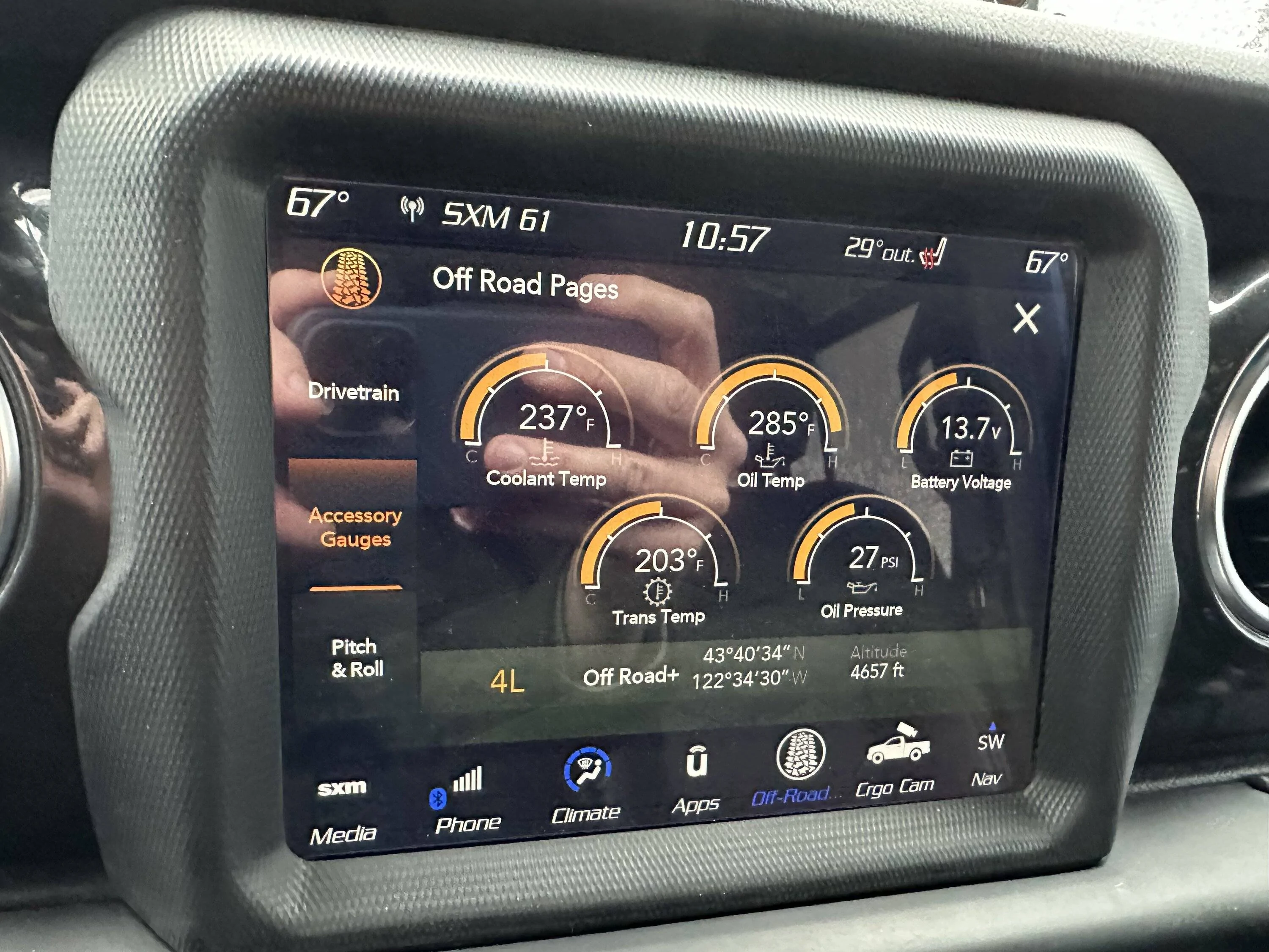

Anyone done a cooler yet? 285 seems excessively high.
Looks like Jeep is calling the thing the oil filter screws into an “oil cooler”. With the lines coming in/out of it, it seems likes a relatively easy spot to plumb an external cooler to.
Curious what were doing at that time? Ive only seen mine go up to 230, the highest ive seen for an NA engine was my C63 which was 245 but it had a cracked mainfold plate which also cause the idle to be higher and rough.

Playing in the snow. And yes, I clear the grill every time I stop. (I was leading and plowing when it got that hot)

Correct me if I’m wrong, but I believe the small cooler is inside the filter adapter and most likely just a coil that gets hot coolant circulated through. It seems adequate for general use but doesn’t have much extra cooling capacity if the engine is being worked hard.
I’d love to add an external air to oil cooler. There isn’t much room behind the grill but I think one could be slipped in.
Off-road with a coolant temperature of around 230F I notice my fan kicks up to turbine mode. The oil temp will be higher, maybe 250F. The fan then runs like that until the coolant is down to around 200F, then repeats that cycle. The oil temp seems to move roughly in parallel.
Are you noticing your fan running full tilt with those temperatures? Kind of amazing that even with 29F outside air temp that the cooling system might be approaching its limits.
Yeah, fan ramps up, but….
I hear you. The hottest I've seen mine is at 10 mph. Will be interesting to see how it does with my 2500lb camper heading up a 6% pass at 100F this coming summer.
