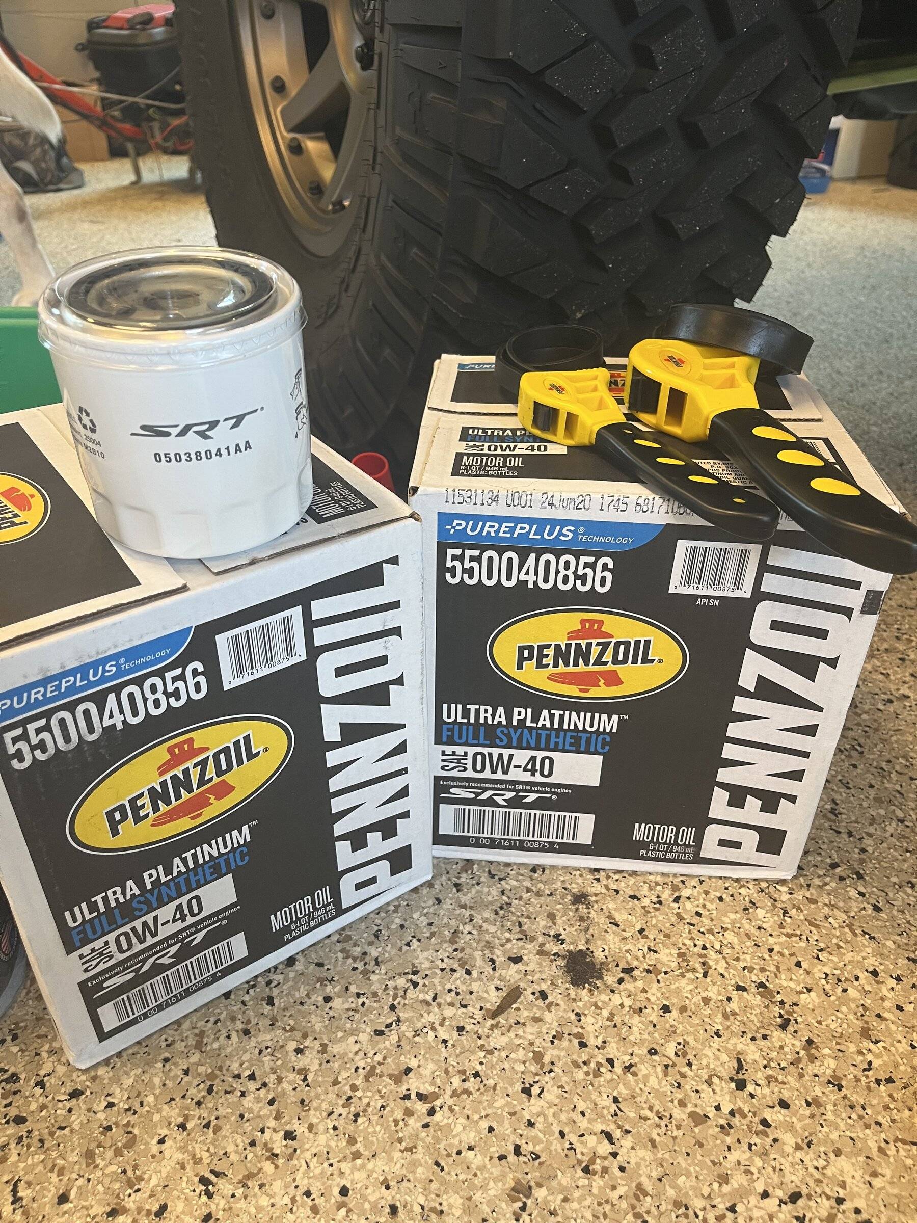

I’m going to use the MO-041 on all changes. It is bigger and kind of a PITA to screw off/on but I’m a fan of the extra filtration. Did the initial change at ~1100 miles and will do them every 5K.

No issues. Just did my second oil/filter change with this setup.

Just read a very extensive explanation of all the filters that will work on the Hemi engines. The 041 has some advantages and there doesn't seem to be any downside. They have more filtering material inside, and they have what looks to be a more stout and reliable bypass valve. I'm going to switch away from the stock filter at 500 miles, have a Blackstone test done, and use that as a benchmark going forward. It's also easier to just keep one filter on the shelf - I've got Vipers and Hemis, and I don't want to have to stock all kinds of different filters.

The 041AA filters are easy to find now. I just had a dozen of them delivered at about $15 each. Supposedly, in November Mopar is going to issue a new upgraded batch (probably called 041AB) that is slightly different. It's still the same thread pitch and overall size, so I'll get some of those when they come out. If you're interested, last I checked CARiD had about a hundred of them in stock. Here's the link: https://www.carid.com/mopar/engine-oil-filter-mpn-05038041aa.html

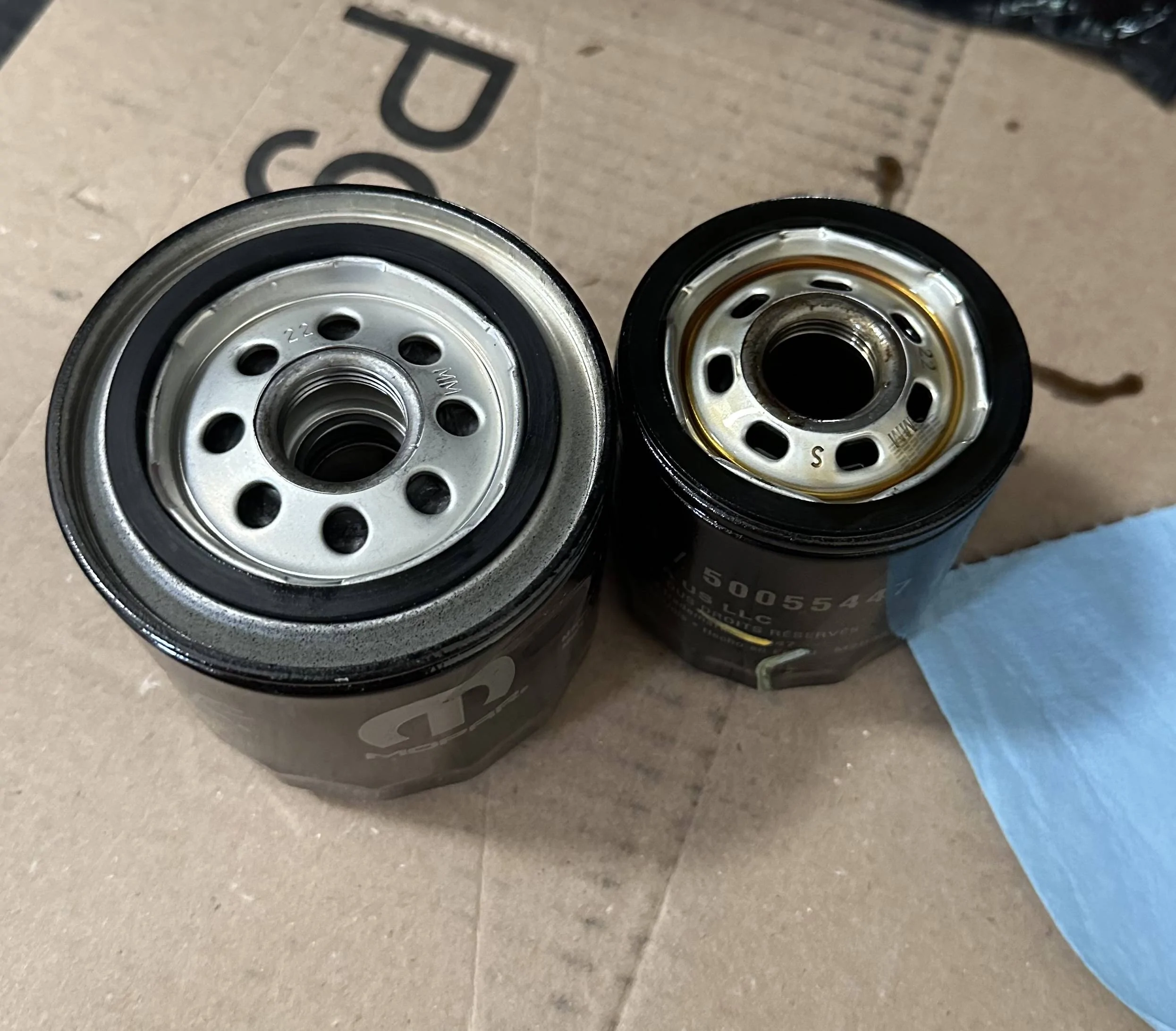

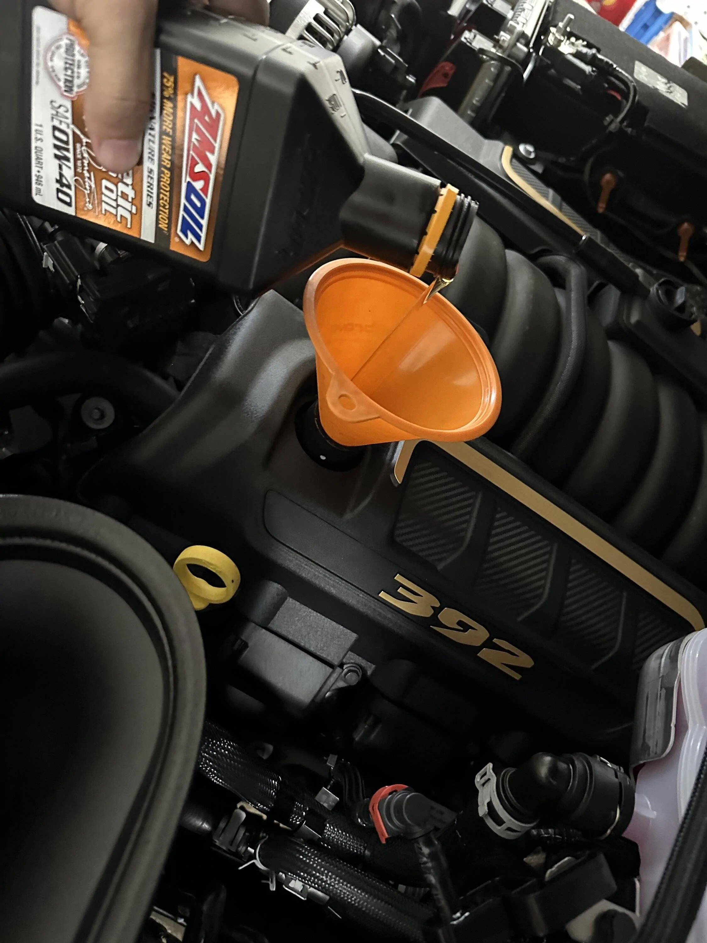

1,000 miles, initial change on new ‘22 392.
Steel oil pan on this one—took 7 qtz, (as did my ‘21 w aluminum pan).
Went with MO-899 filter this time.
Anyone else w experience using this filter?
