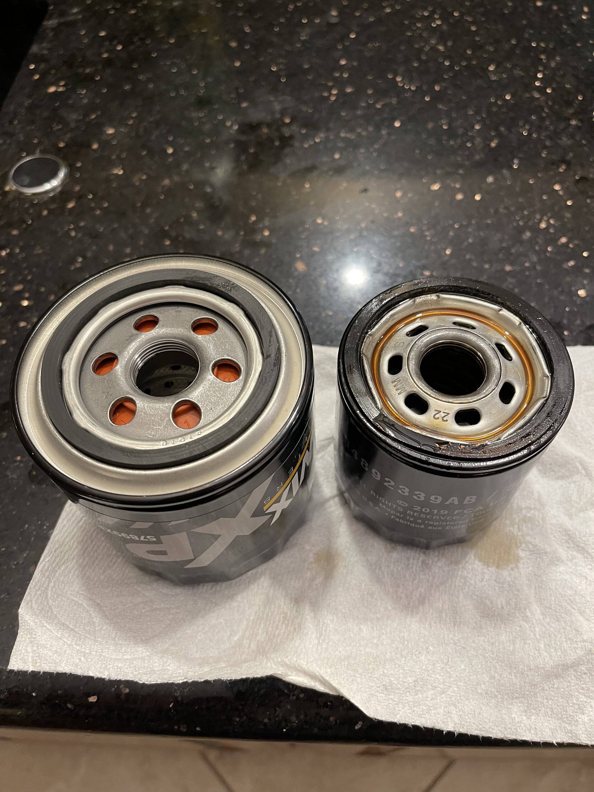

I chose to use Wix 57899XP. I use Wix in every vehicle and piece of equipment I own and have never had an issue.

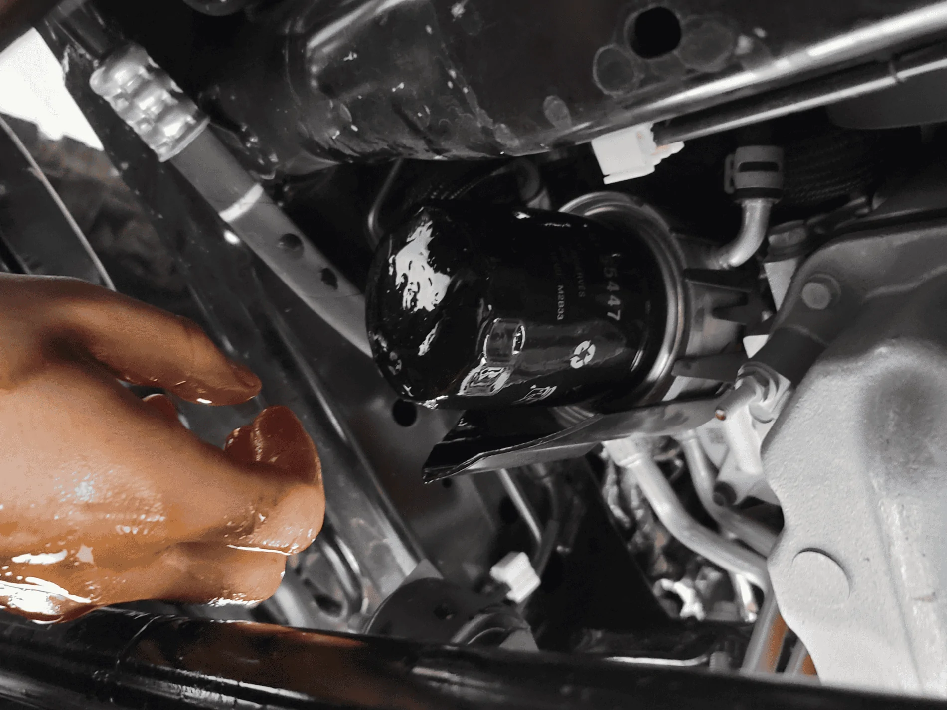

A nice picture of the drip shield (just under the filter) kindly posted by @0II392II0:
Jeep Wrangler JL 392 DIY Oil Filter preference 1676303312009
Filter swap or oil drain, either order is fine. I often remove the filter first, then drain the oil. While the oil is draining I prep & install the new filter. Verify the rubber filter seal comes out with the old filter.

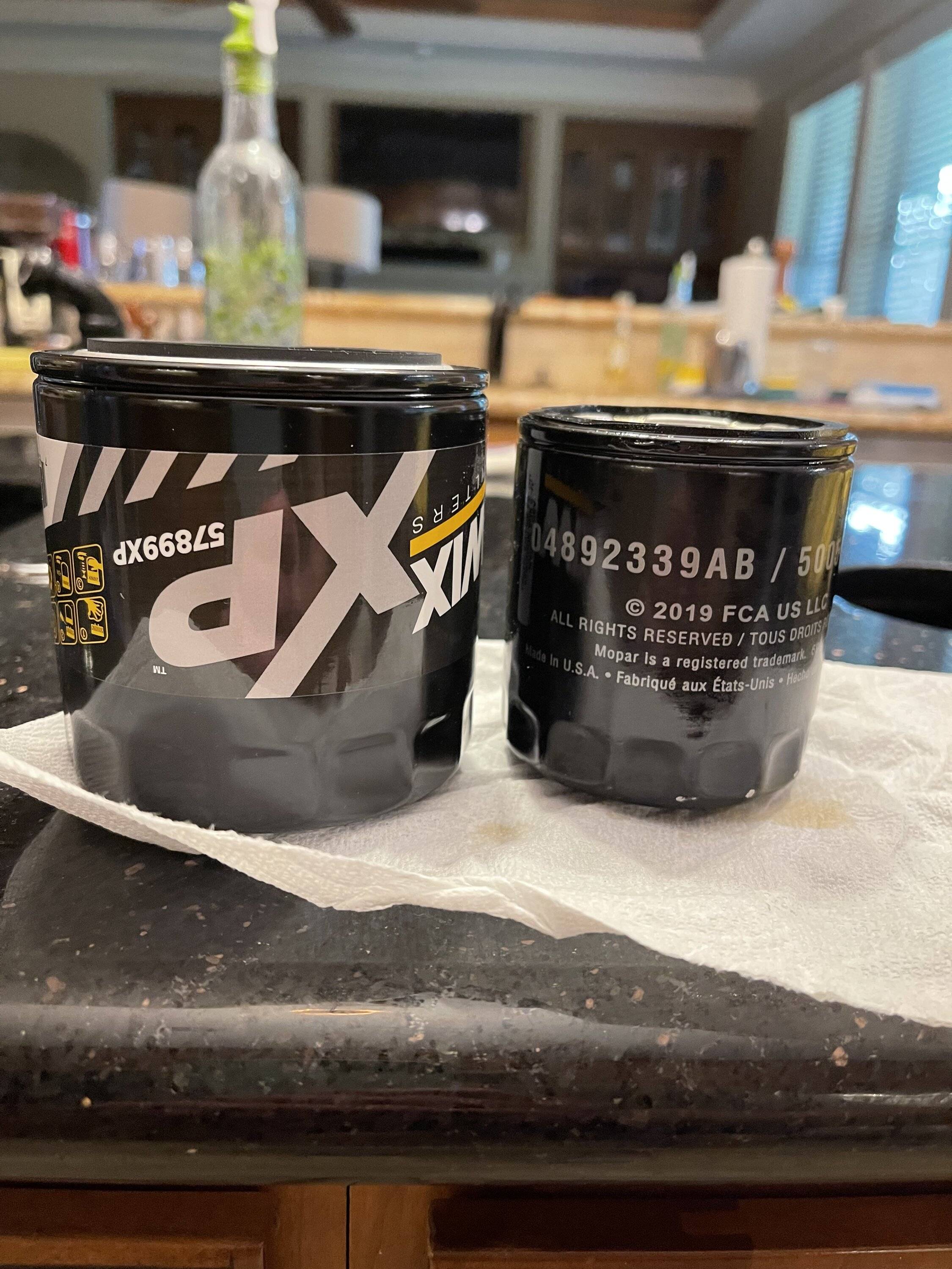

Hi Steve,
Having worked in an oil filter design group for one of the big three, and having cut open and tested many in-house and competitive filters, I too have developed an aftermarket preference for Wix filters.
In particular the physical construction of the XP line, with the coil spring instead of the stamped sheet metal spring, the metal end caps, a heavy base plate and well designed bypass valves.
As I just bought and installed my first aftermarket filter (Wix XP) on my 392 this month, it bugged me that I could not find a published micron rating for the XP line, yet the ratings were generally available for the non-XP filters. So I wrote to Wix customer support:
Question/Request:
My vehicle (2021 - JEEP - WRANGLER 392) uses a 57060 or 57060XP oil filter.
On RockAuto, where I often purchase my WIX filters, the 57060 is listed of having a filtration Beta Ratio of 2/20=6/20, which if I understand correctly would indicate 50% filtration of 6u particles and 95% filtration of particles 20u or larger.
While I like the construction of the XP filters, I've been unable to find any filtration data for the XP version of the 57060 filter to guide my choice is selecting the filter.
I would prefer to use whichever version of the 57060 that has the smaller micron rating.
Thank you,
Tim
And the response I received:
Tim,
The XP filters are always higher,,,95% at 35 microns. For extended service intervals.
Thank you,
Mann+Hummel Product Information
Product Information (800) 949-6698)
MANN+HUMMEL Filtration Technology, 1 Wix Way, Gastonia, NC, USA
For our 392's, the needle bearings in the roller lifters and the activation pins in the MDS lifters are both very susceptible to wear. In my view the XP filters do not seem like a good fit for this engine.
FWIW I just went out and removed a filter with 100 miles on it and put on the non-XP version.
Below is the information I was able to gather on suitable Wix filters. After removing the XP filter I put on the Wix 57899. I like that is physically much larger than the stock filter, however with our relatively modest oil change interval I'm not sure it provides that much advantage.
Mopar 04892339AB (stock OEM) (Small) $6.74 Rock Auto
Alt: Wix 57060* 3.45" H / 2.92" D 12psi 10-12 GPM 50% @ 6μ / 95% @ 20μ $6.00 Rock Auto
Mopar 04884899AB (used on many Dodge/Ram Hemi engines) (Large) $11.95 O'Reilly's
Alt: Wix 57899* 3.74" H / 3.68" D 16psi 9-11 GPM 50% @ 6μ / 95% @ 20μ $4.79 Rock Auto
Mopar 05038041AA (high quality, used on Hellcat Hemi) (Large) $11.95 Rock Auto
Alt: Wix 57063* 3.83" H / 3.68" H 12psi 7-9 GPM 99% @ 23μ $8.84 Rock Auto
*not XP versions, for extended drain interval w/ much higher micron rating (95% @ 35μ)
