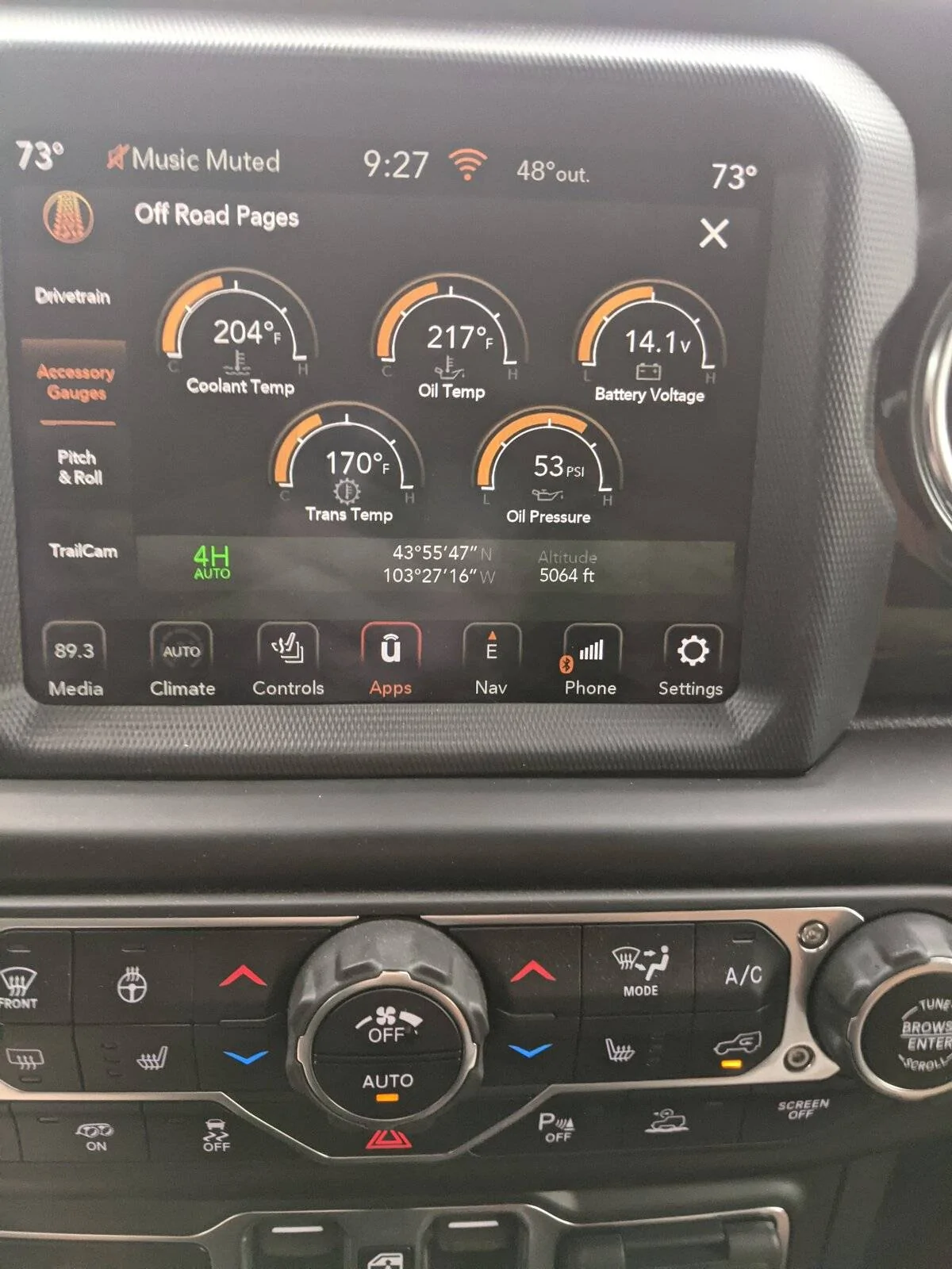

My 392 is also on 37s with beadlocks, but I don't think mine is running that hot. I usually have off-road pages up, I'll try and get a better number and report back but that does sound on the high side off the top of my head.
RCEric
Eric
Oct 8, 2021
Rapic City, SD
'21 Jeep Wrangler Rubicon 392
Here is my 392's temps after 5 mins on the highway doing 65. 37" tires with beadlocks, so decent amount of weight.

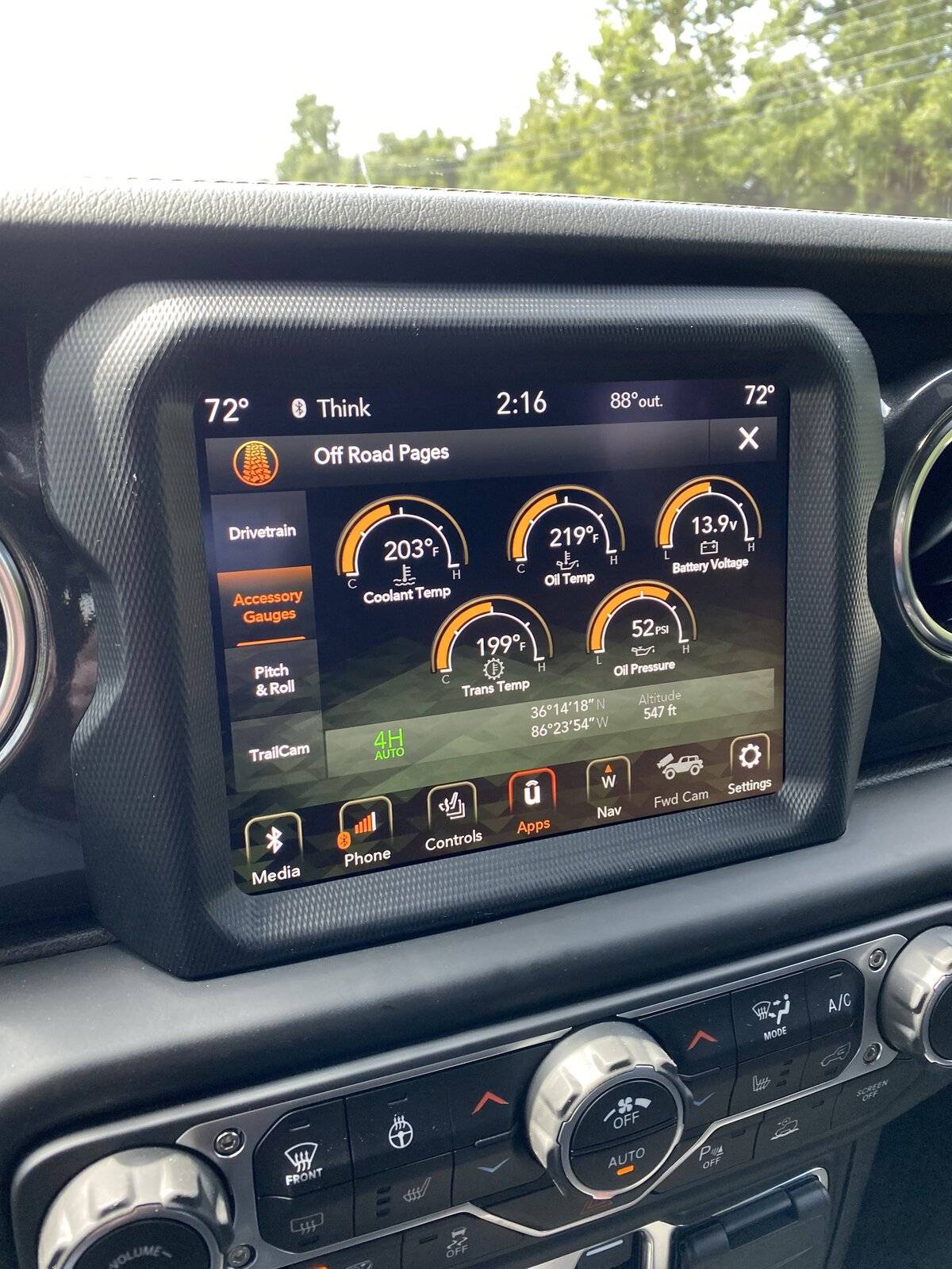

Here’s another example on stock 33s while driving normal. I’ve consistently see 230 sitting in traffic and 240 when driving her aggressively.
