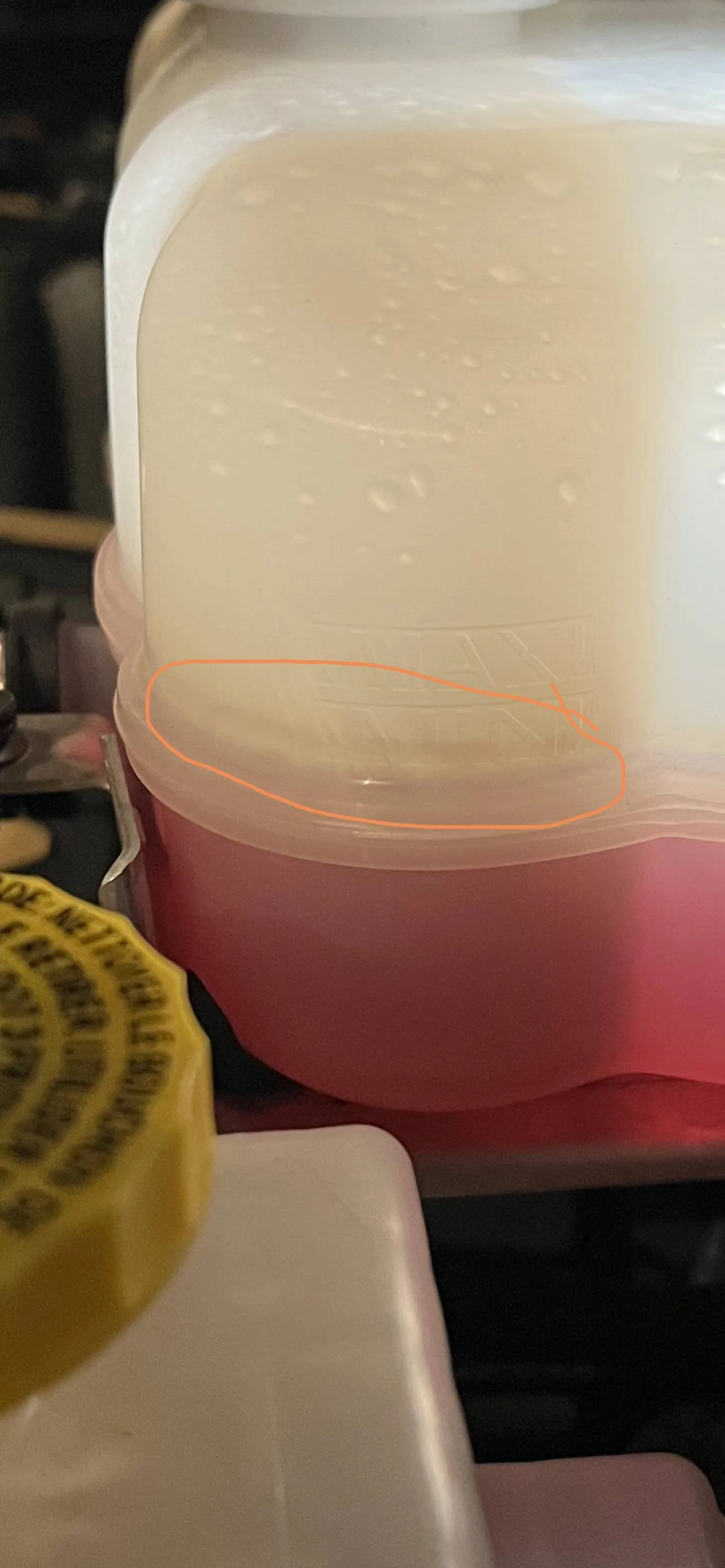

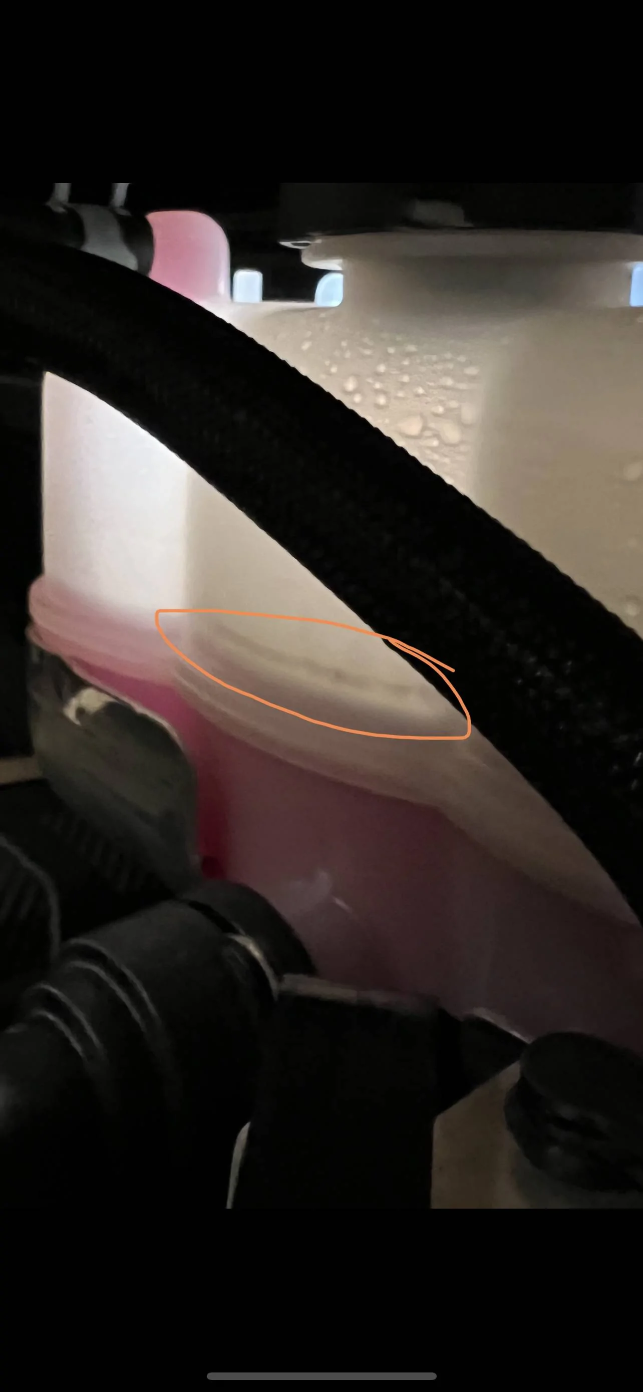

Need some help from the forum since my dealer is struggling. At 6000 miles, I’ve had a slow coolant level drop for several weeks. Pressure test ok. No drips. Three times to the dealer, and they say it’s fine. Today the level was higher (!), and I saw this on the inside of the reservoir bottle.

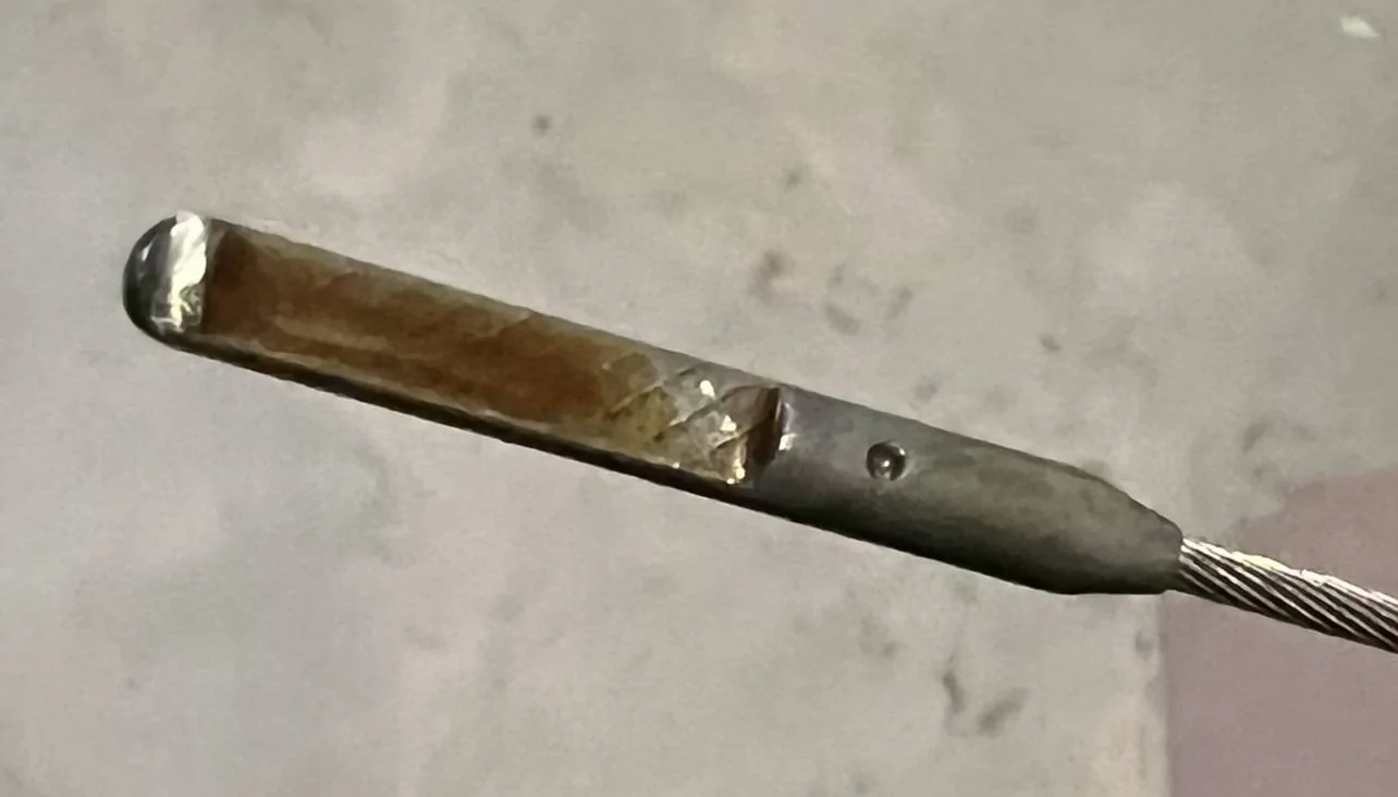

Is this oil residue? Does the oil on the dipstick look ok?
