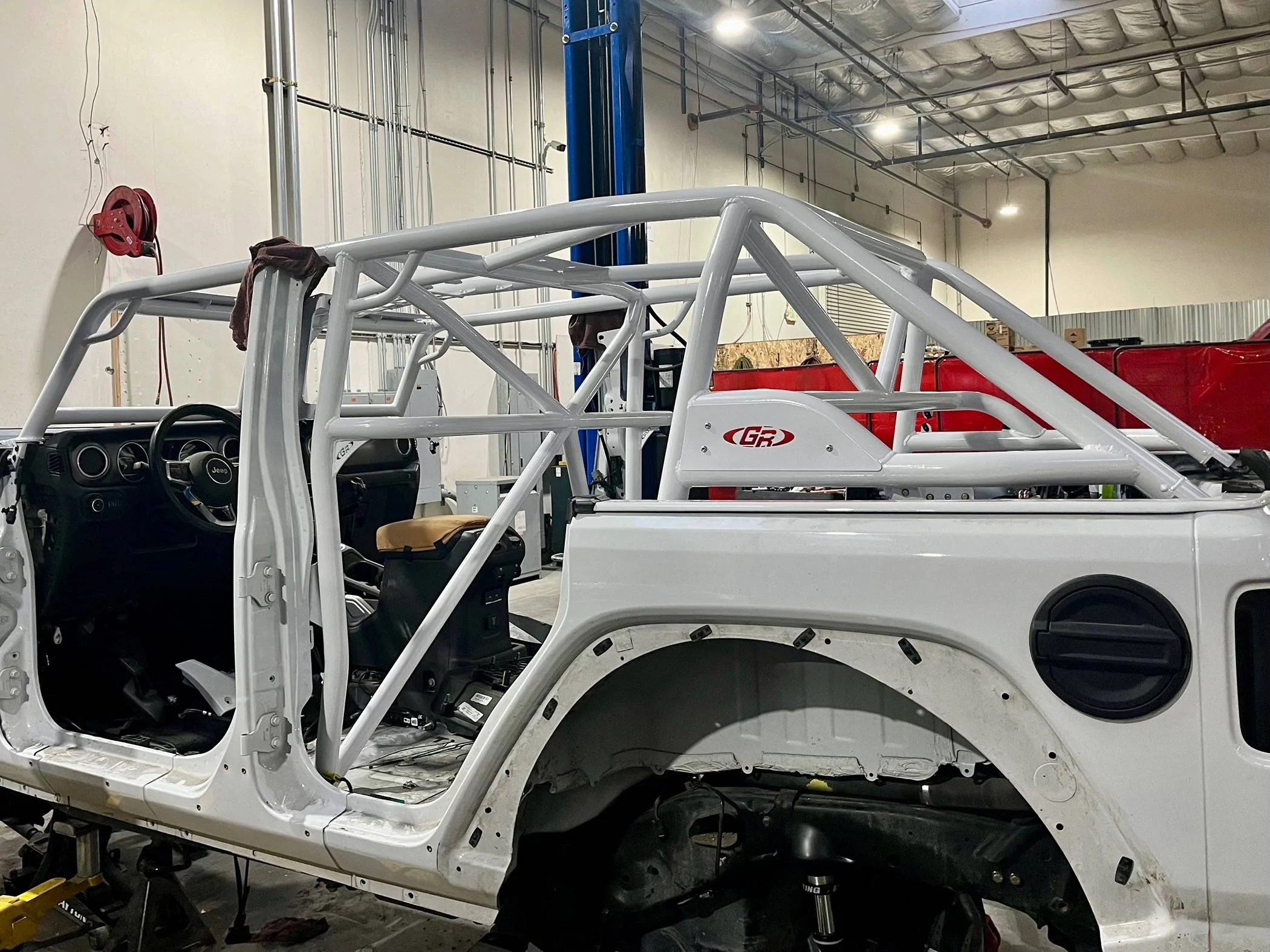

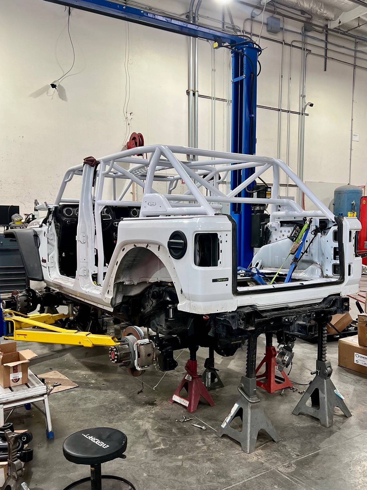

New here, but thought I’d show before, during, and and getting there at 6 months old.

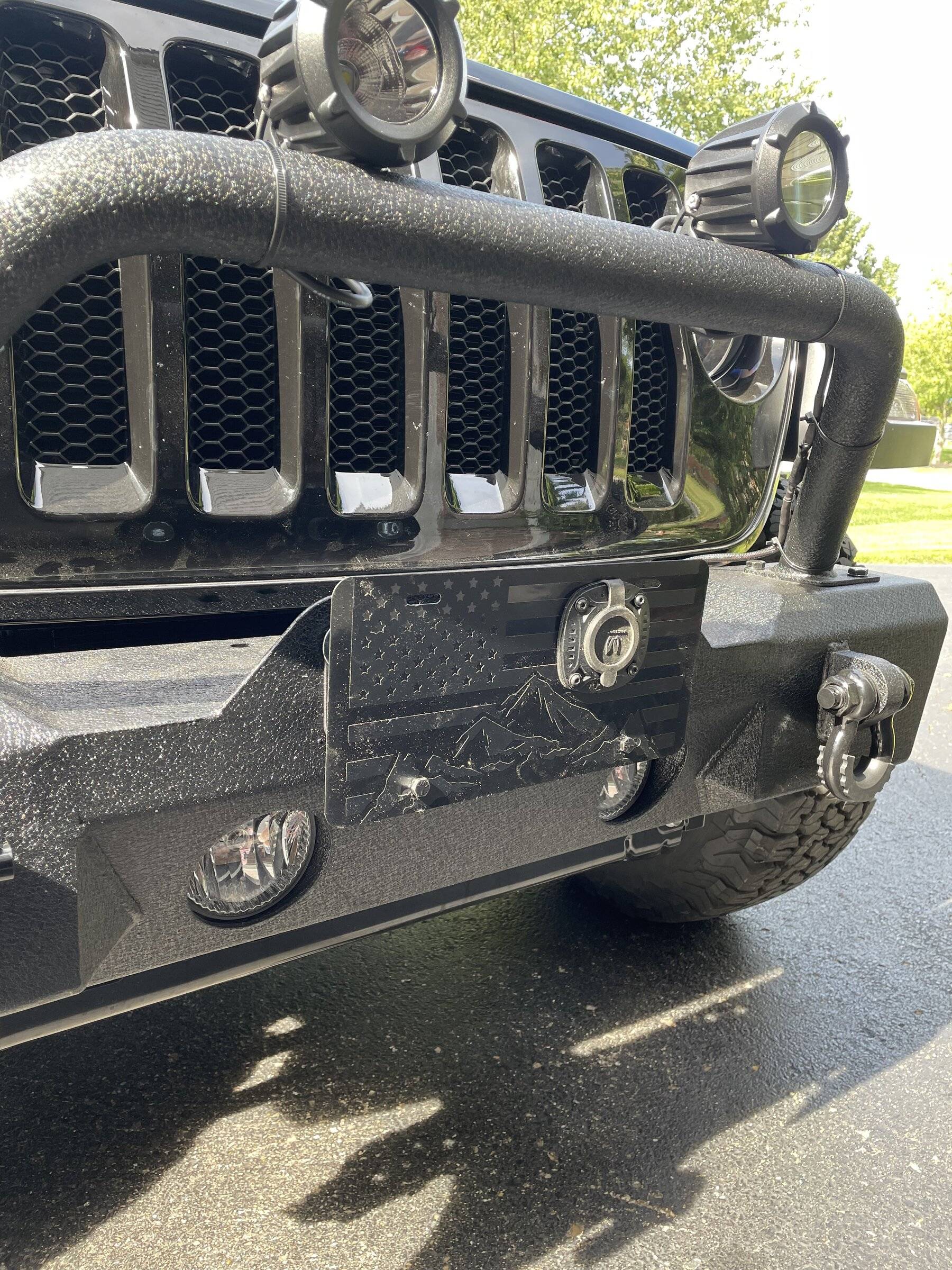

How did you mount that front plate? I have the same bumper and have no intention of mounting a winch, been toying with how to cover the fair lead opening, thought about cutting it off, which I will probably do when it comes time to paint in a few years, but in the mean time a novelty plate like you have seems like a good option. Did you just drill and tap, or install an aftermarket plate holder? TIA.

Cheap plate mount from Amazon, mounted upside down utilizing fairlead mounting holes. Drilled vanity plate and ran block heater plug in through fairlead opening to vanity plate. Functional and hides lack of winch.
