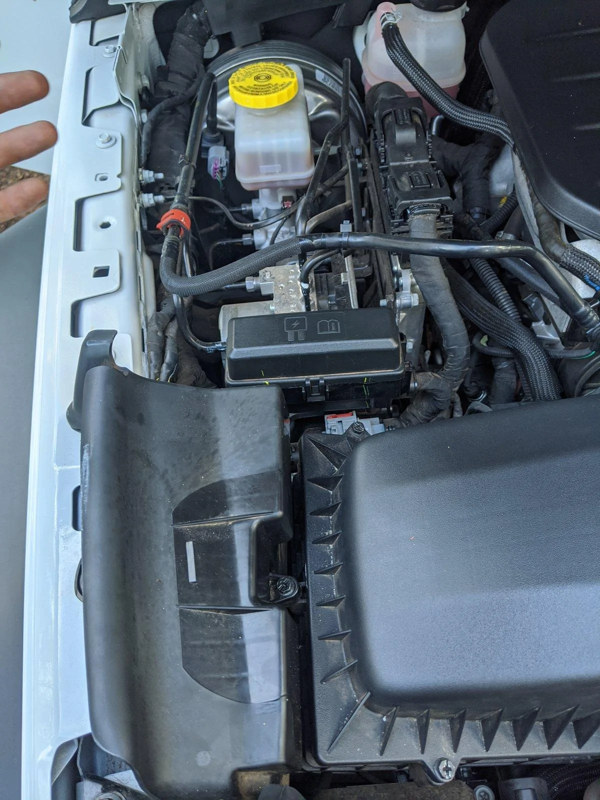

Any idea what these are can't find in manual
WTH is that. Doesn’t even look like a Diesel engine bay. Have never seen anything like that in my 2020 JLUSD.
That doesn’t appear to be the intake for. diesel since ours is on the driver side and that appears to be on the passenger side....
