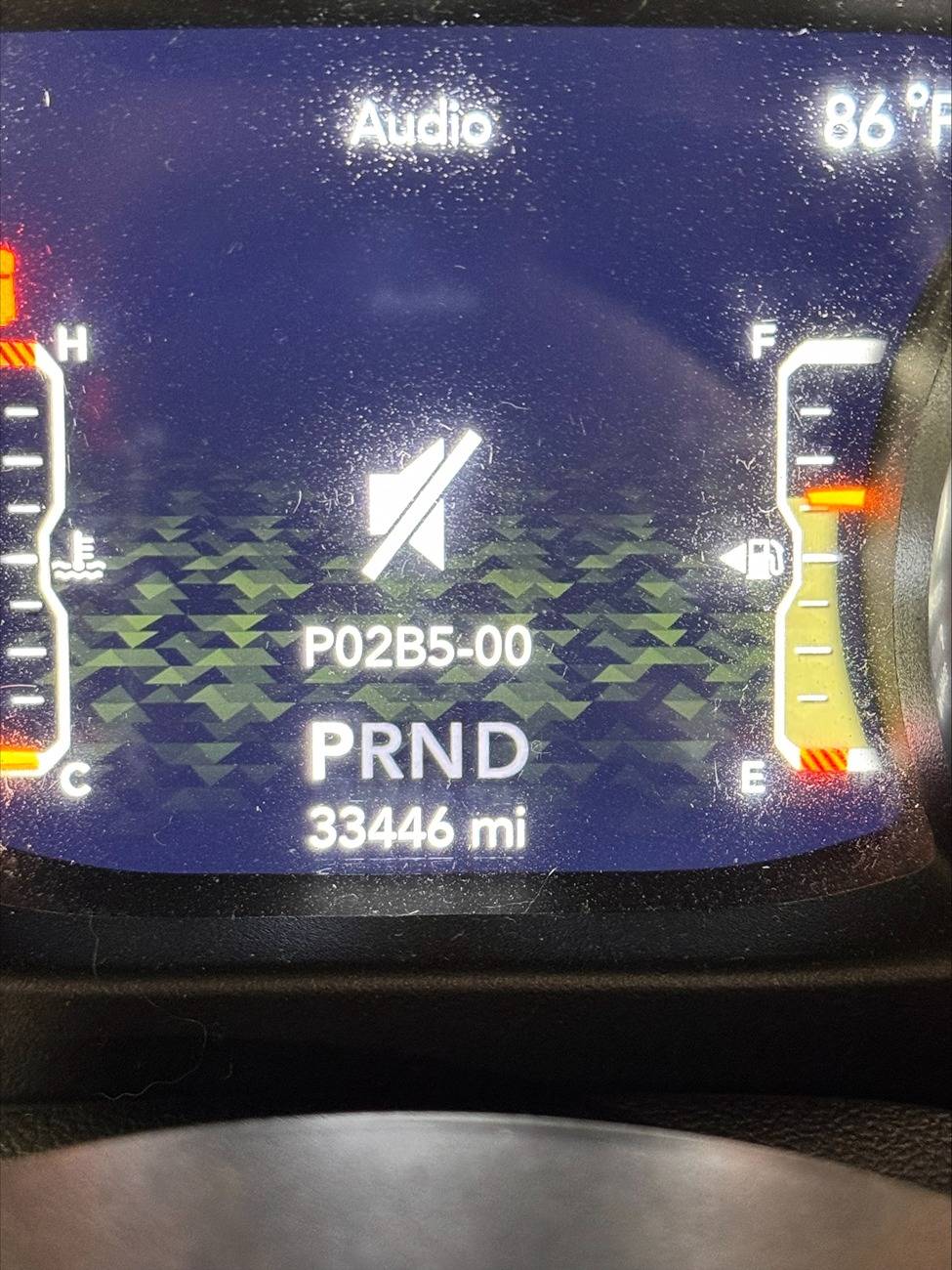

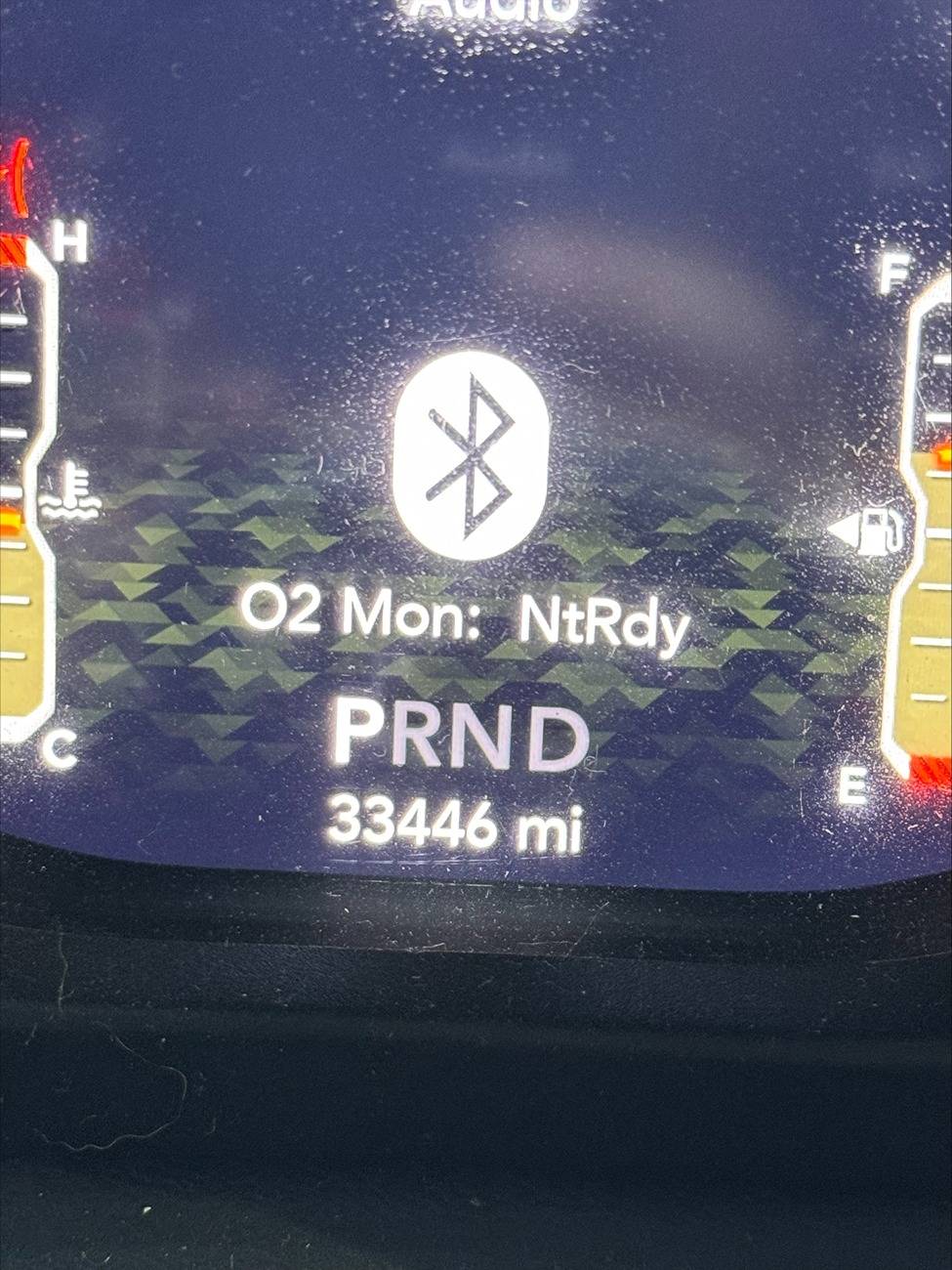

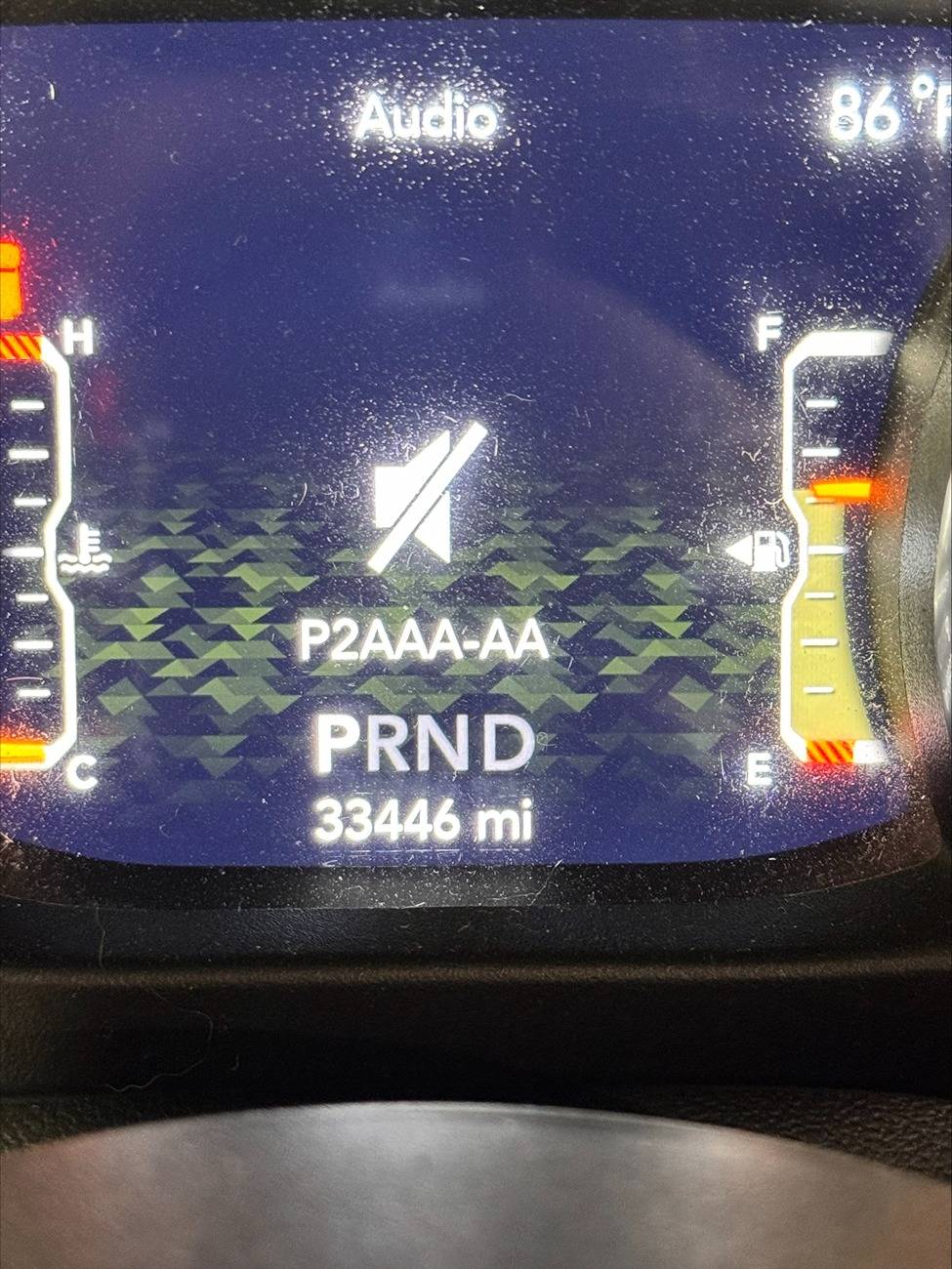

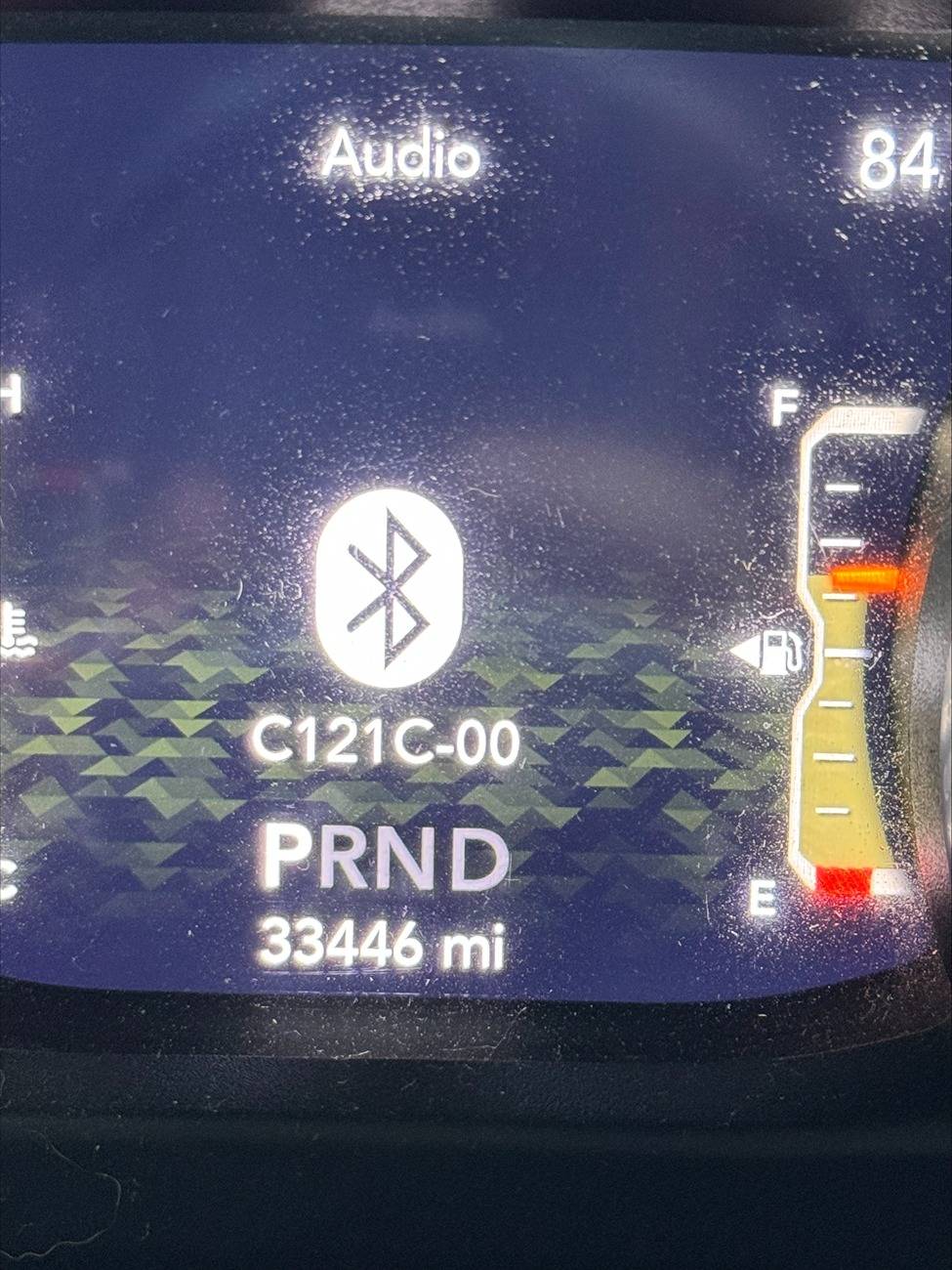

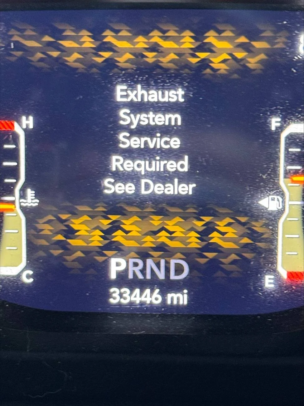

I'm new to the site and looking for a bit of advice. After lurking for about a year, I finally bought my Wrangler JL 2022 last July with 32,000 miles on it. Currently, it has 33,000 miles. During the first week, I drove it approximately 200 miles, and while traveling down the highway at around 80-81 miles an hour, the check engine light came on, followed by the traction control warning, ABS warning, and then "Exhaust system needs to be Serviced." I took it back to the dealer I bought it from, who was very accommodating and loaned me a car while it was in the shop. The outcome was that everything checked out and they performed a manual regen.
I initially thought this might be a one-time issue, perhaps because it had sat for a while or the previous owner let it idle too much. However, it has now happened five times, with the Jeep visiting multiple dealers in an attempt to diagnose the issue. I've gone into limp mode on the highway multiple times. On one occasion, while in regen, I stopped on an off-ramp, and the start/stop system decided to kill the engine at the light, sending me into limp mode.

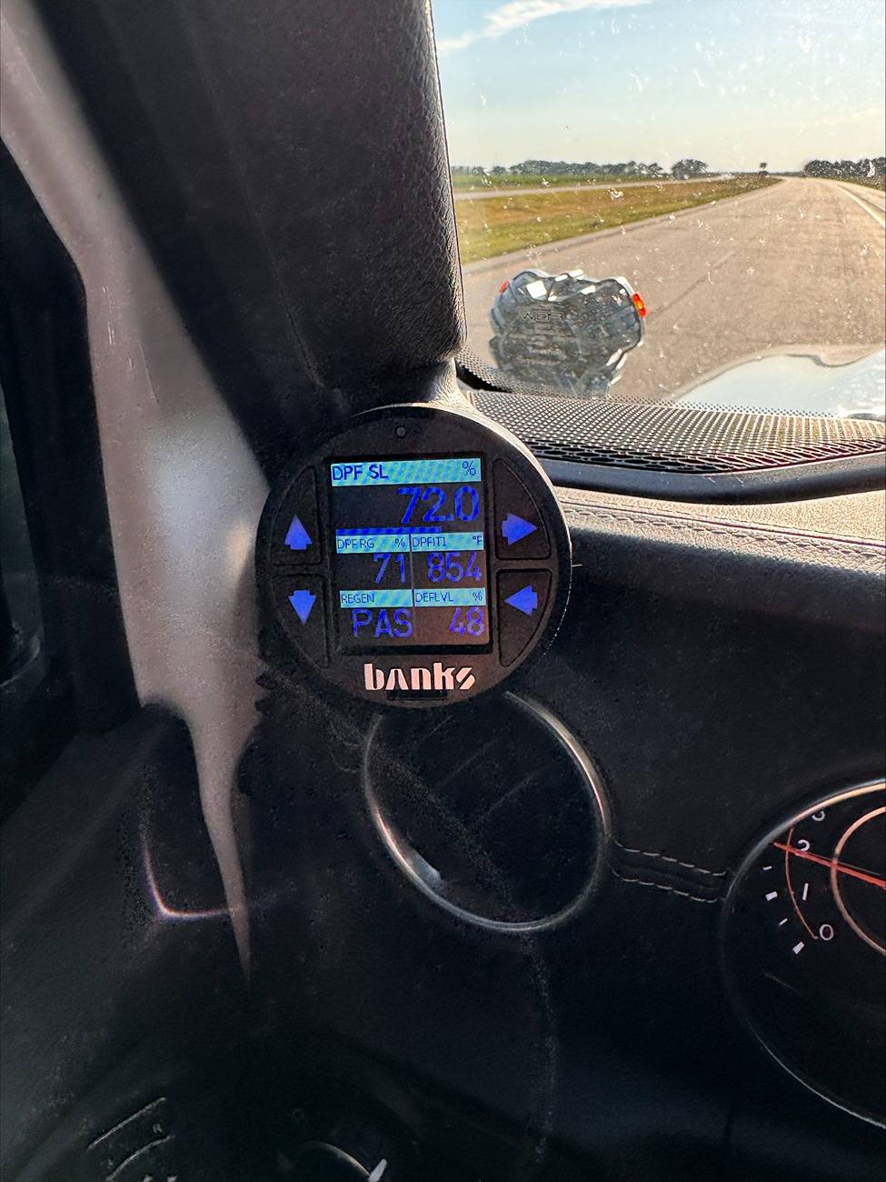

To monitor the situation, I bought a Banks gauge to keep an eye on temps and soot levels. Unfortunately, last month, while on a trail in Colorado with a 30% load, it went into limp mode again. I took it to the last dealership, where we had a bit of an argument about whether it had a tune or not (it does not). Their conclusion was to replace the DPF and a sensor.

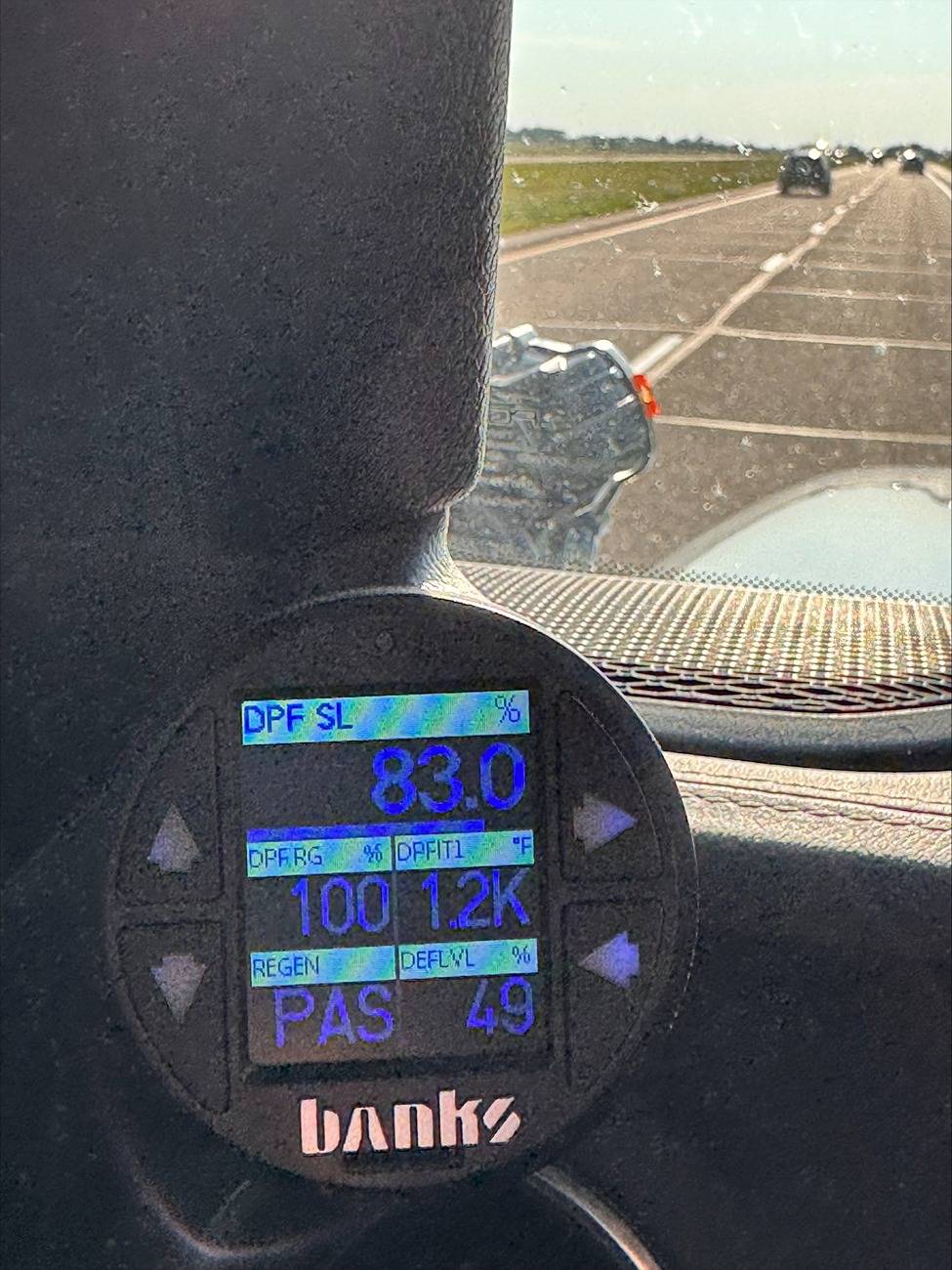

I picked up the Jeep last weekend and took it for a drive to the lake, thinking everything was working fine. However, on Monday, I drove it to the airport with 43% soot level. When I returned on Friday and left the parking lot, I noticed the gauge had jumped from 43% to 83% in just 6 miles. A regen started, and I didn't shut the Jeep off. After grabbing a drink and hitting the highway, the regen completed, and the soot level dropped to 9%. However, after another 6 miles, it climbed to 30%, and after another 12 miles, it was at 60%. By the time I finished my 45-mile trip, it was at 70%, and I was in limp mode with the "service exhaust system" warning. So, in less than 200 miles, the Jeep was not running properly again.

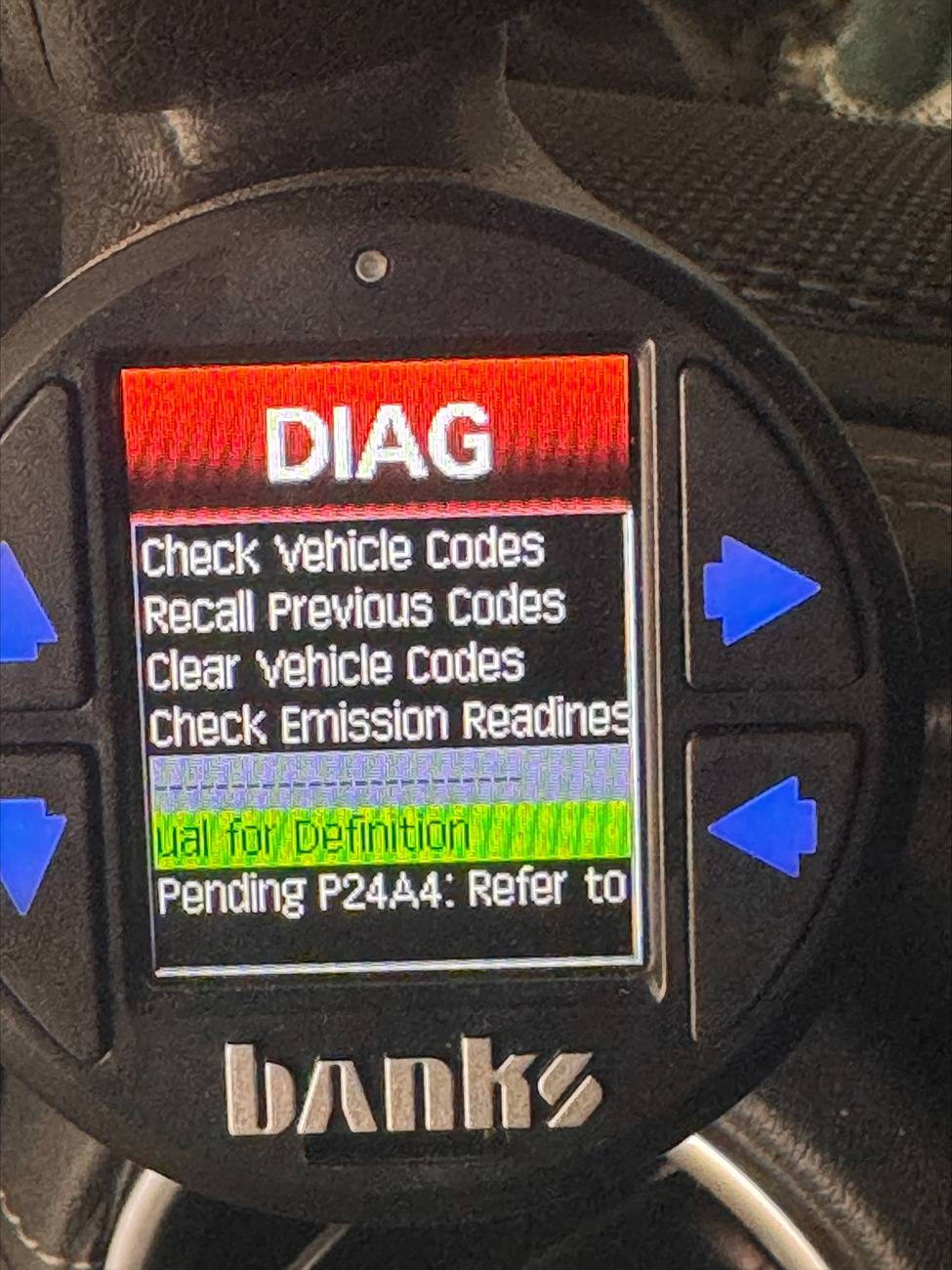

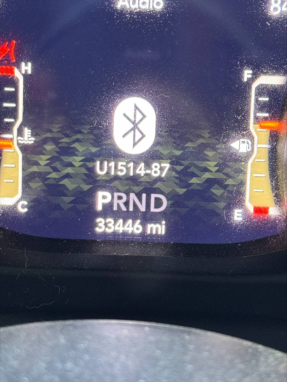

I took photos of the codes and videos of how quickly the soot was building up. The last dealer stated that the injectors and turbo tested fine. Could this issue be related to a clogged EGR? It seems like really low miles for something like that to be the problem.

If you spend much time on this forum, you'll see just how much trouble the aux battery can cause. It only takes about five minutes to bypass it, and honestly, there's little reason to keep it installed. As Brad hinted, the strange behaviors triggered by that battery often defy logic. Early in my ownership, my aux battery went haywire—you'd think my Jeep was haunted: wipers turning on, lights flashing, random error codes popping up...

P.S. Your erratic soot levels sound sensor-related. You mentioned replacing one—can you clarify which one?
hebbjr2413
hebbjr2413
James
Jul 26, 2025
Ogallala NE
Wrangler JL, Cherokee
I believe the erratic codes are from the derate, each time this has happened I loose throttle control (only can input half throttle) and all lights come on the dash. I could be wrong, this is just my thoughts.
the sensor replaced was is the Exhaust Pressure Differential sensor. Part number 68302134AA
