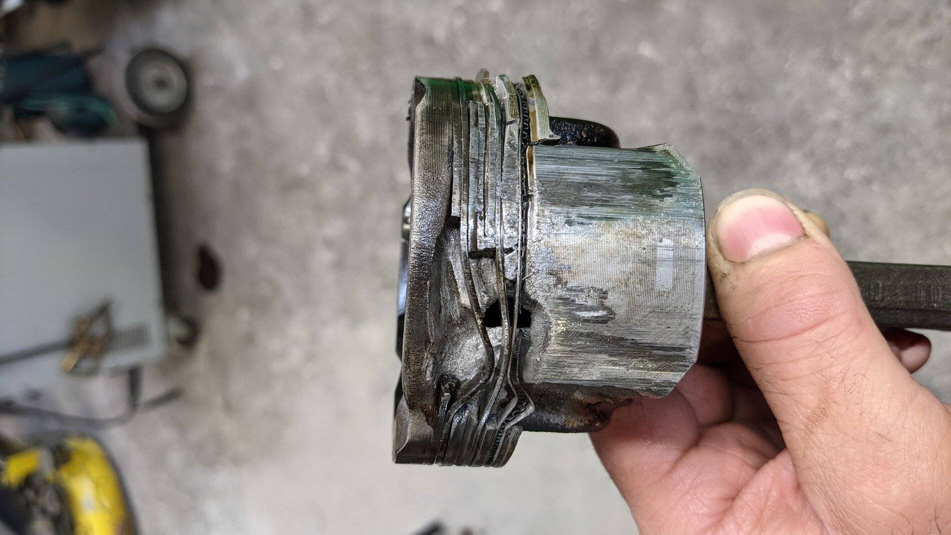

Have a friend who is a tech, replacing a 2.0 Turbo engine in a Cherokee with 58K. Car was always serviced and engine internals look clean.
He had it pulled from the car and had it in his stall, waiting on the new engine. The good news is there was no carbon or build up on the valves. The bad news is that one of the pistons was melted down and the lands collapsed/ melted on one side , the intake port side. The car came in running poorly and he test drove and did compression and #2 cylinder was dead. I guess they are putting in new engine, turbo and injectors.
The other thing he also told me was these 2.0 engines do not have iron liners, I guess they use aluminum with a coating on the cylinder walls. He said the cylinder wall was worn thru to the aluminum on the dead cylinder.
Something caused the top piston land to break and caused this.
Typically detonation either from bad gas or too much boost.
I broke a ring land off at high RPM from bad fuel tuning once. It was on a naturally aspirated single cylinder with port injection & electronic ignition. Amazingly the motor still ran OK, but had quite a bit of blow-by at high loads.
Too little fuel from a clogged injector could run lean (hot) and melt the piston. Too much fuel from a broken injector could fuel-wash the cylinder, washing the oil away and causing too much friction. Either of these scenarios could be plausible for a completely stock 2.0.
