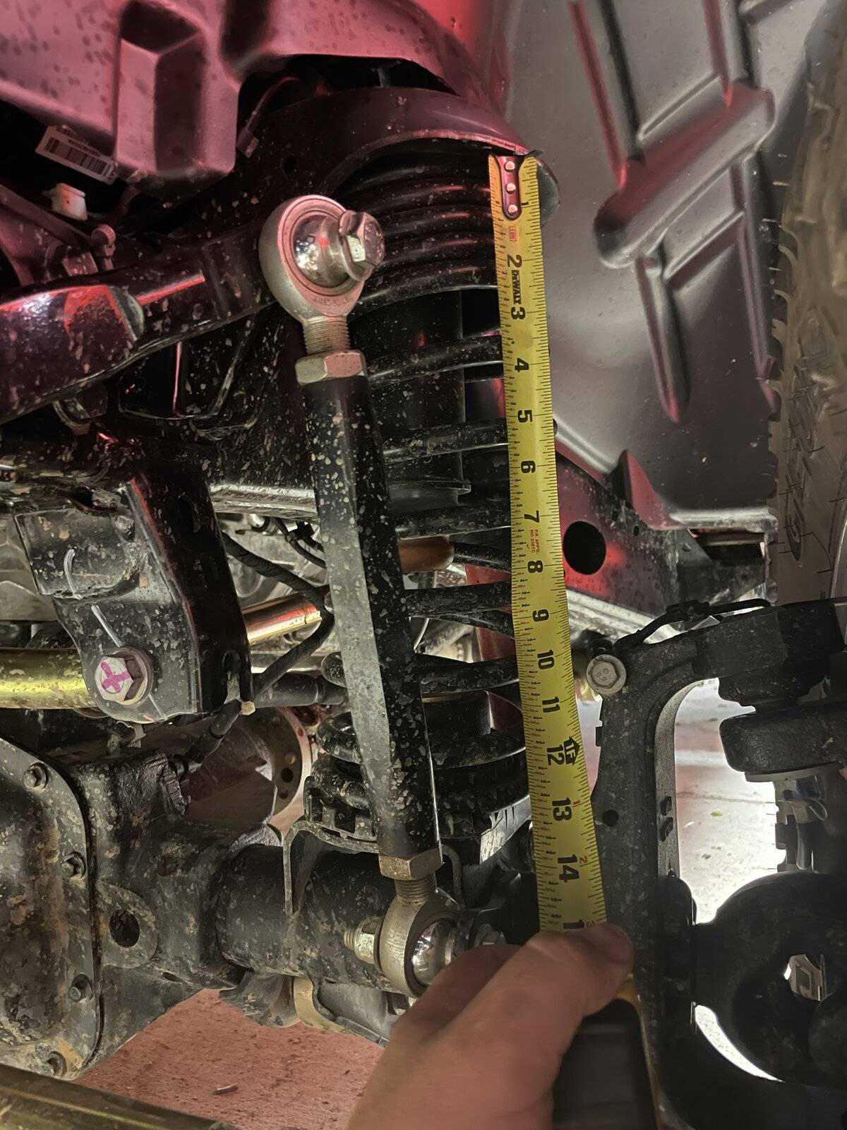

It looks like this would have been an issue with the normal length bumpstops, correct?
I don’t think so, but I’m not positive. The dildozer is awful intrusive.

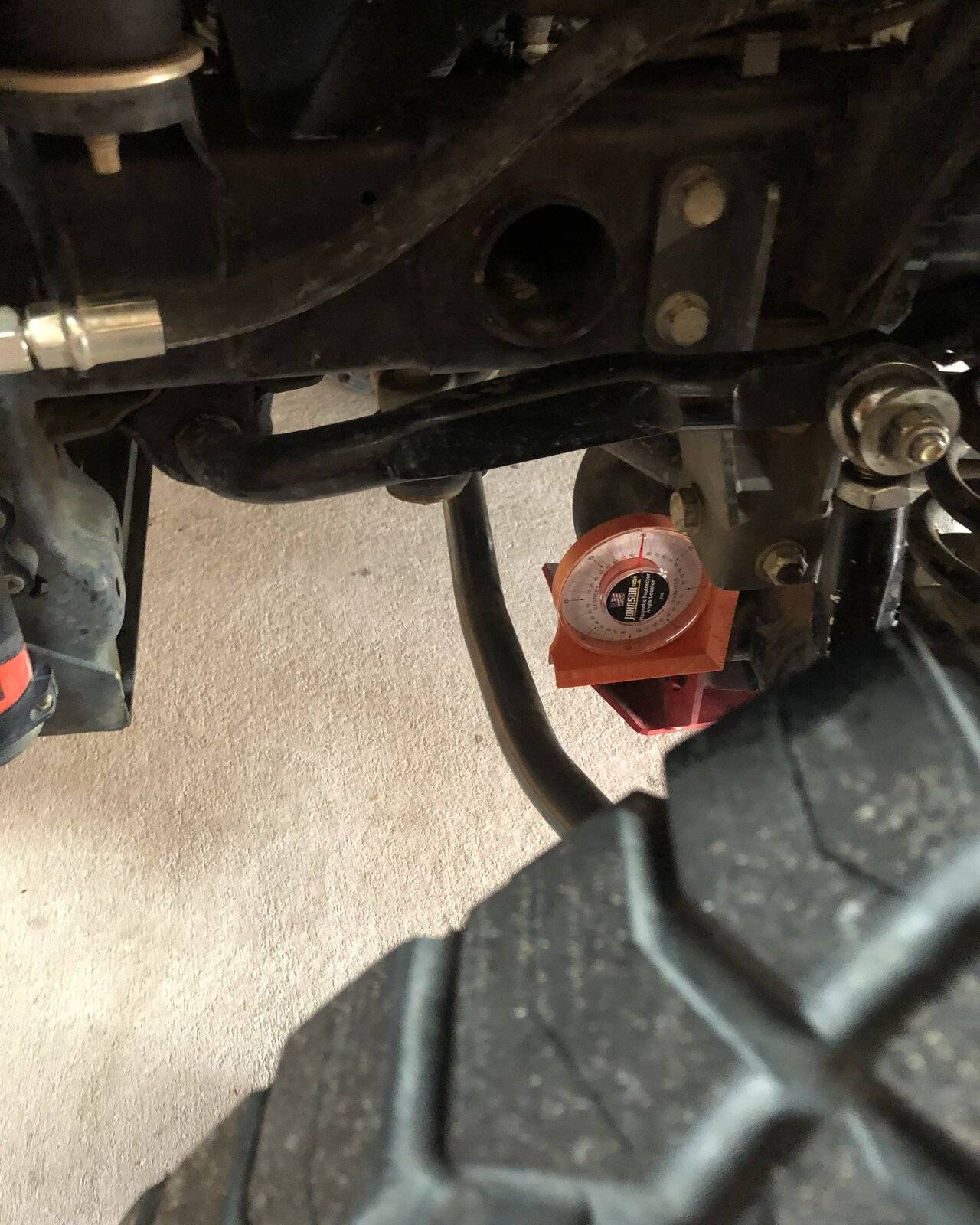

Something else I see that may be contributing to the problem, but isn’t the main problem is they didn’t use the metal cloak coil isolators. Those look like the oem isolators.
Jeep Wrangler JL Xtreme Recon Lift Issues 3B4E0769-4D2D-48D3-BD73-ABEA1A633E45
Also with short arm/mid arm kits the axle rolls back as it droops, so it’s still gonna look like that when drooped, but should be centered at ride height.
Jeep Wrangler JL Xtreme Recon Lift Issues 736673E4-865A-40FA-AA4B-F9FC791B751A
FWIW I installed the kit. They just did the alignment. The isolators were included but the instructions specifically stated to only use one on the E-torque models and use the stock isolators for the remaining. And that’s what I did. If it continues to be an issue after the adjustments made today I will chase other options. I’m really hoping it is fixed by moving the axle forward a tad and rolling the axle. It was barely grabbing before, but enough to make a loud concerning noise. Fingers crossed

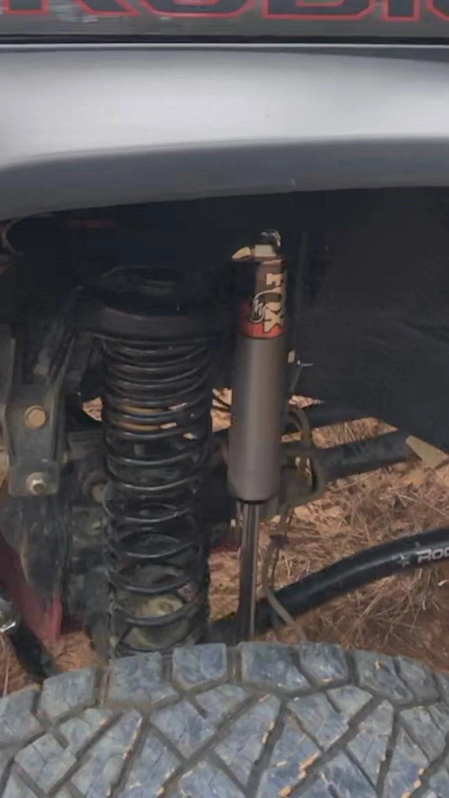

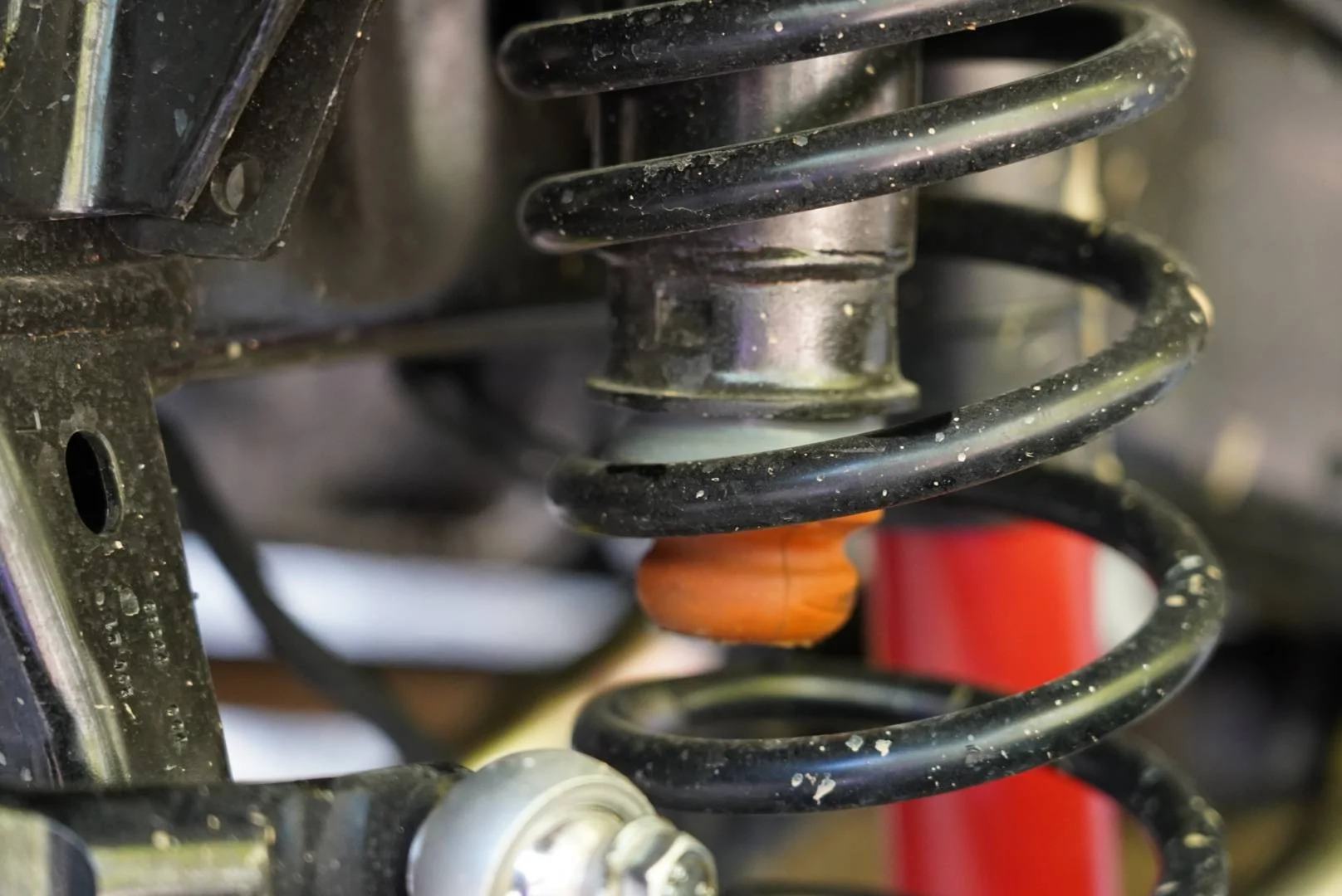

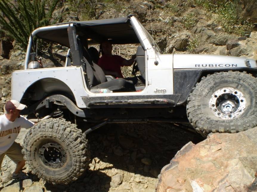

On the bright side, at least the long bump stop extensions will prevent your coils from falling out at full flex/droop. ?? That was legit problem i use to have on both front and rear sometimes in my Tj. Resolved when entire jeep suspension was redone to coilovers. Hey, coilovers, that is one possible solution ?
Jeep Wrangler JL Xtreme Recon Lift Issues REARCOIL
Jeep Wrangler JL Xtreme Recon Lift Issues 2498505510059825998yIsjlB_fs

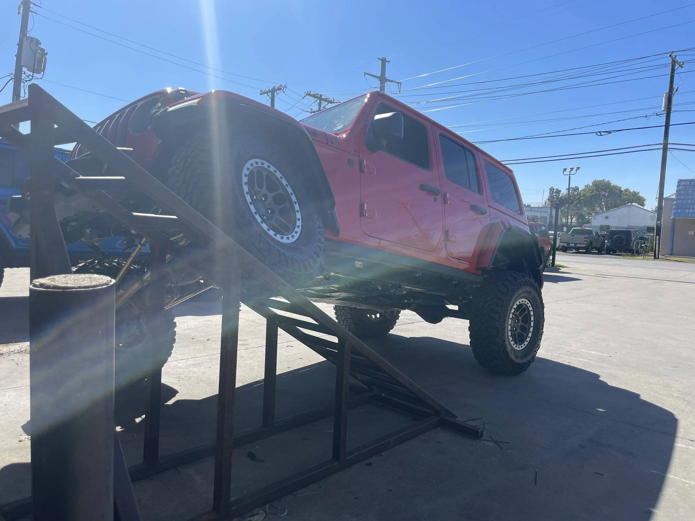

For the most part, yes. Moved the axle a tad and rolled it a bit and it only makes a little pop sound every now and then if I’m REALLY flexing out.
how much more lift did the kit give you? Noticeably better flex?

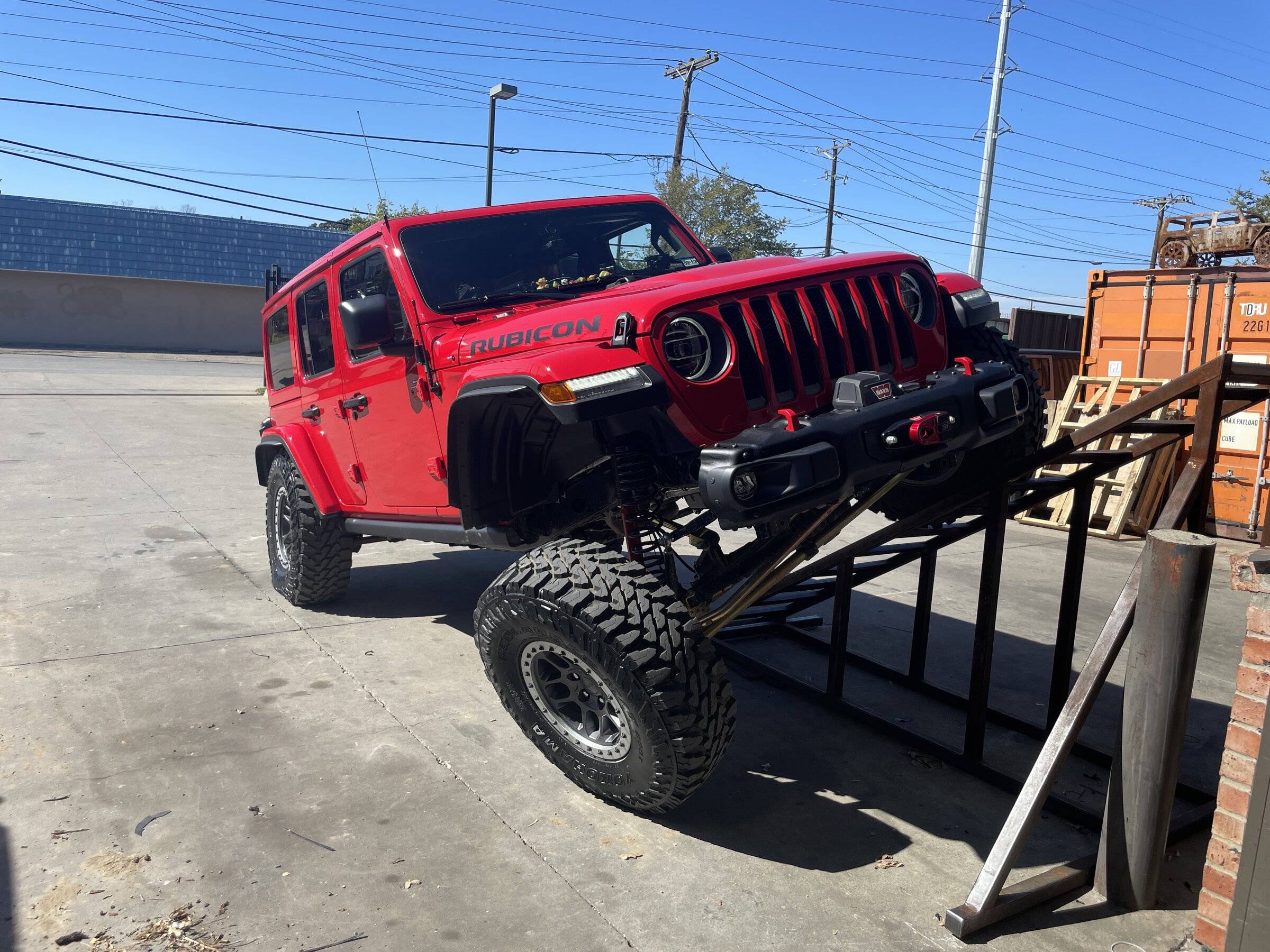

I got ~2” over the XR factory height from the lift. I never flexed the stock suspension, but this thing is nuts. You won’t be disappointed, and if you are you need long arms. It’s almost too good? I feel like I need to take risky lines to get excited with this rig, compared to my last rig that was a crowd pleaser on sane trails. The giggle factor is there, like, "holy cow, we made that look easy" the drama however, is gone. It just flexes up most lines without lifting a tire and rarely requiring lockers
