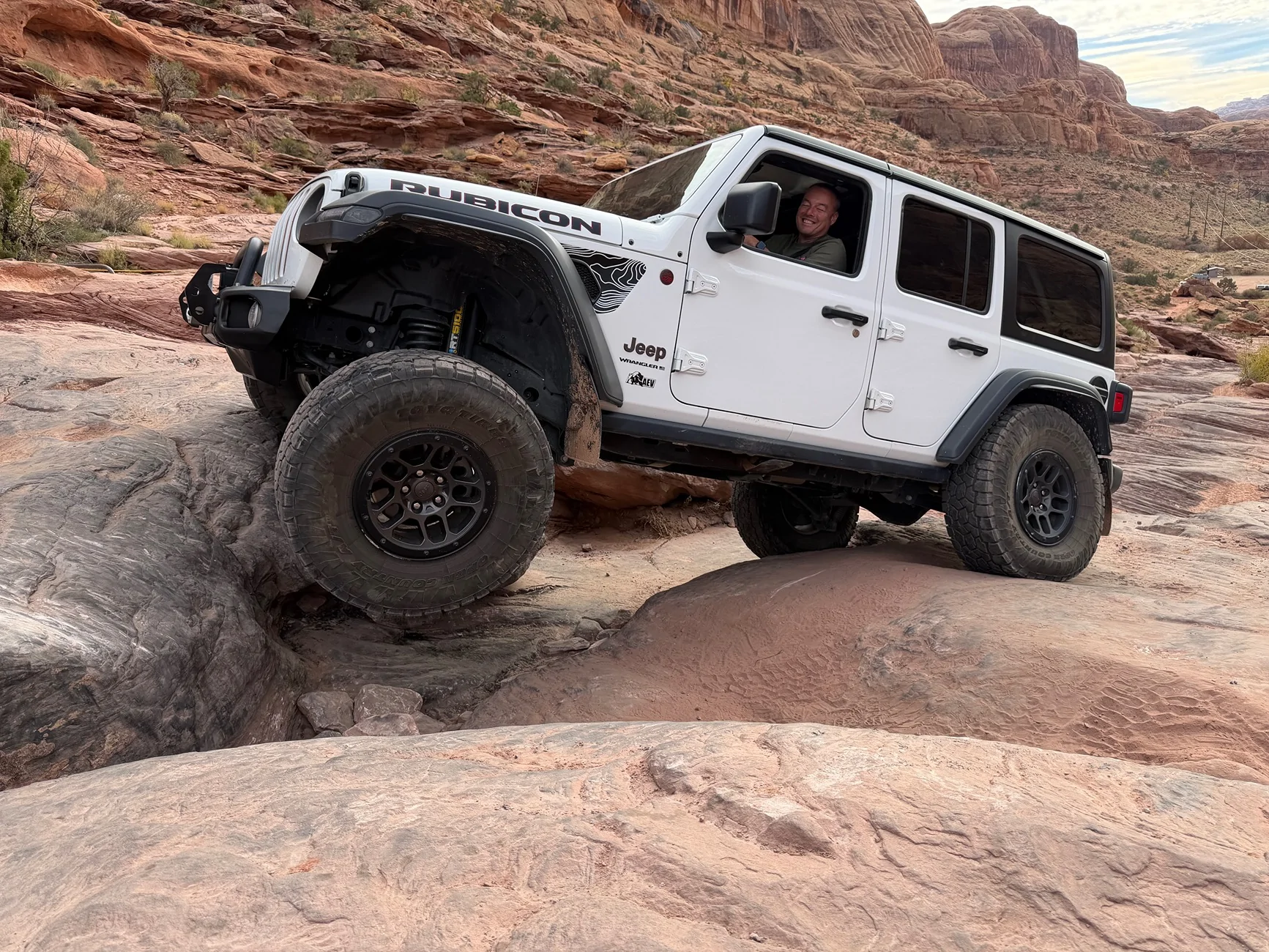

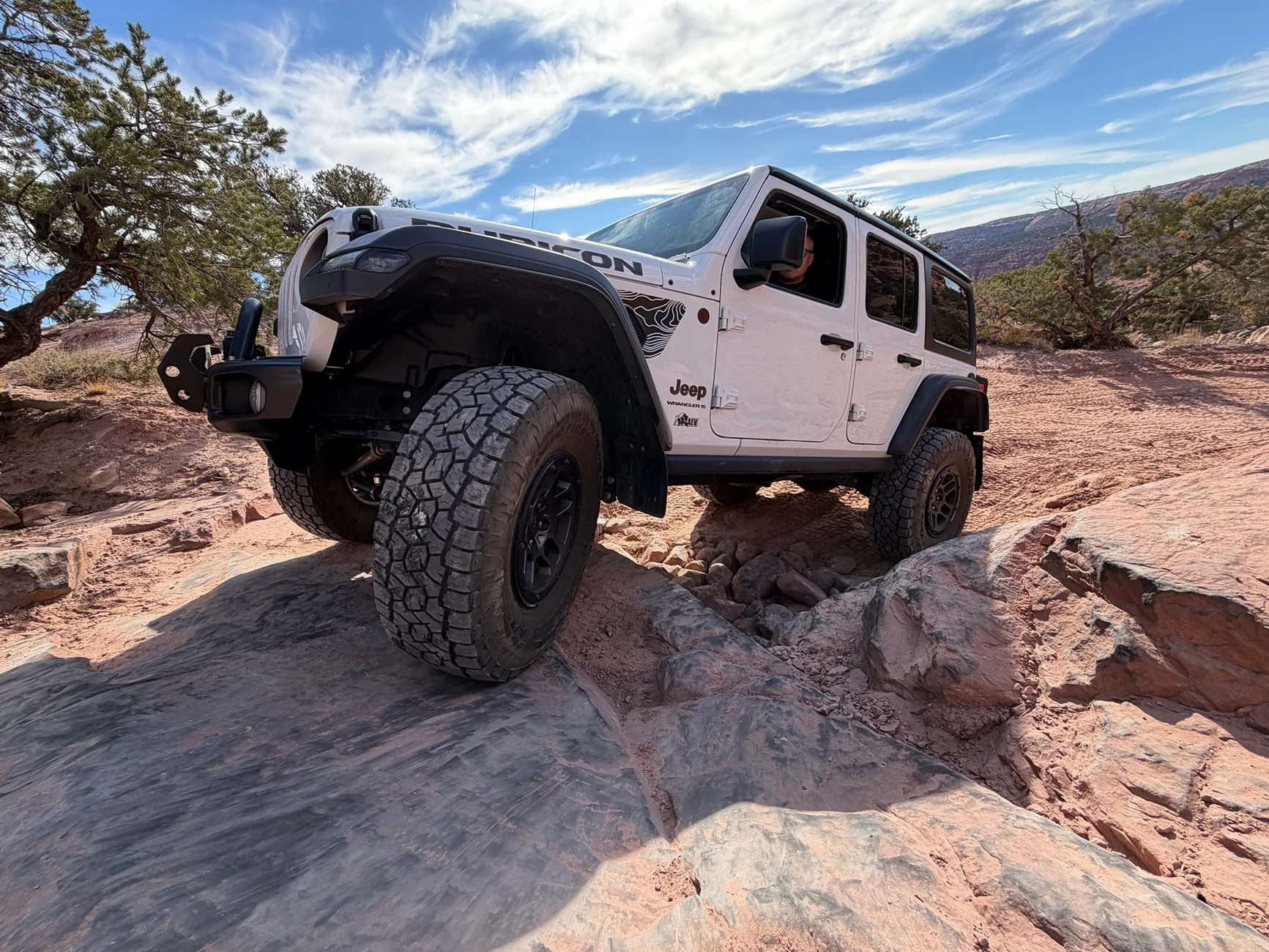

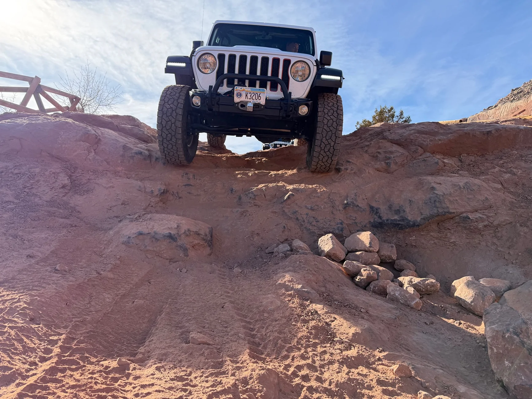

here is my buddy’s with the arcus bumper.
Jeep Wrangler JL Adding lift to xtreme recon? IMG_8048
Jeep Wrangler JL Adding lift to xtreme recon? IMG_9727
Jeep Wrangler JL Adding lift to xtreme recon? IMG_8474
Jeep Wrangler JL Adding lift to xtreme recon? IMG_9716
Jeep Wrangler JL Adding lift to xtreme recon? IMG_9687
