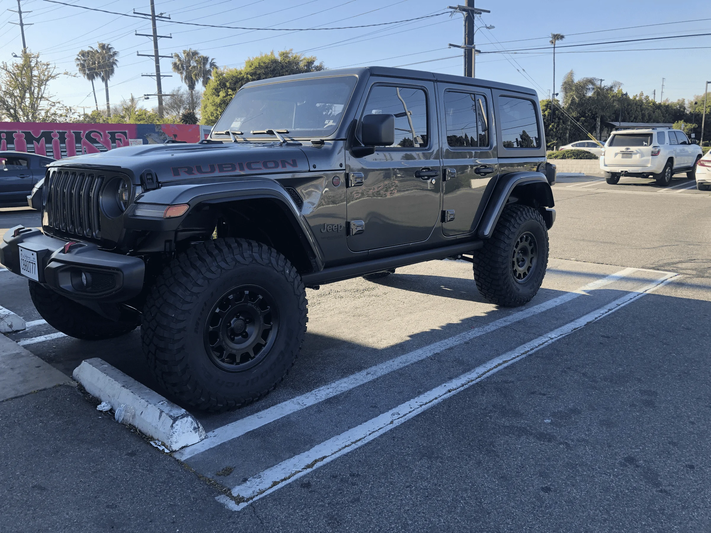

Here are pics of measurements. 43 1/2 front 43 1/2 rear. Thats left front and rear. 77 1/2 to top. Thats with 35's. 37's will add maybe a inch to overall.

My local shop is telling me I will net only 1" with a MC 2.5" lift since the xTreme Recon is already 1.5" above standard Rubicon. They said the 2.5" is from stock Rubicon height and recommend the 3.5" lift.. But it looks like you got the full 2.5". Is that what you are seeing?
I put a 2.5” Clayton lift on mine and got the full 2.5”.

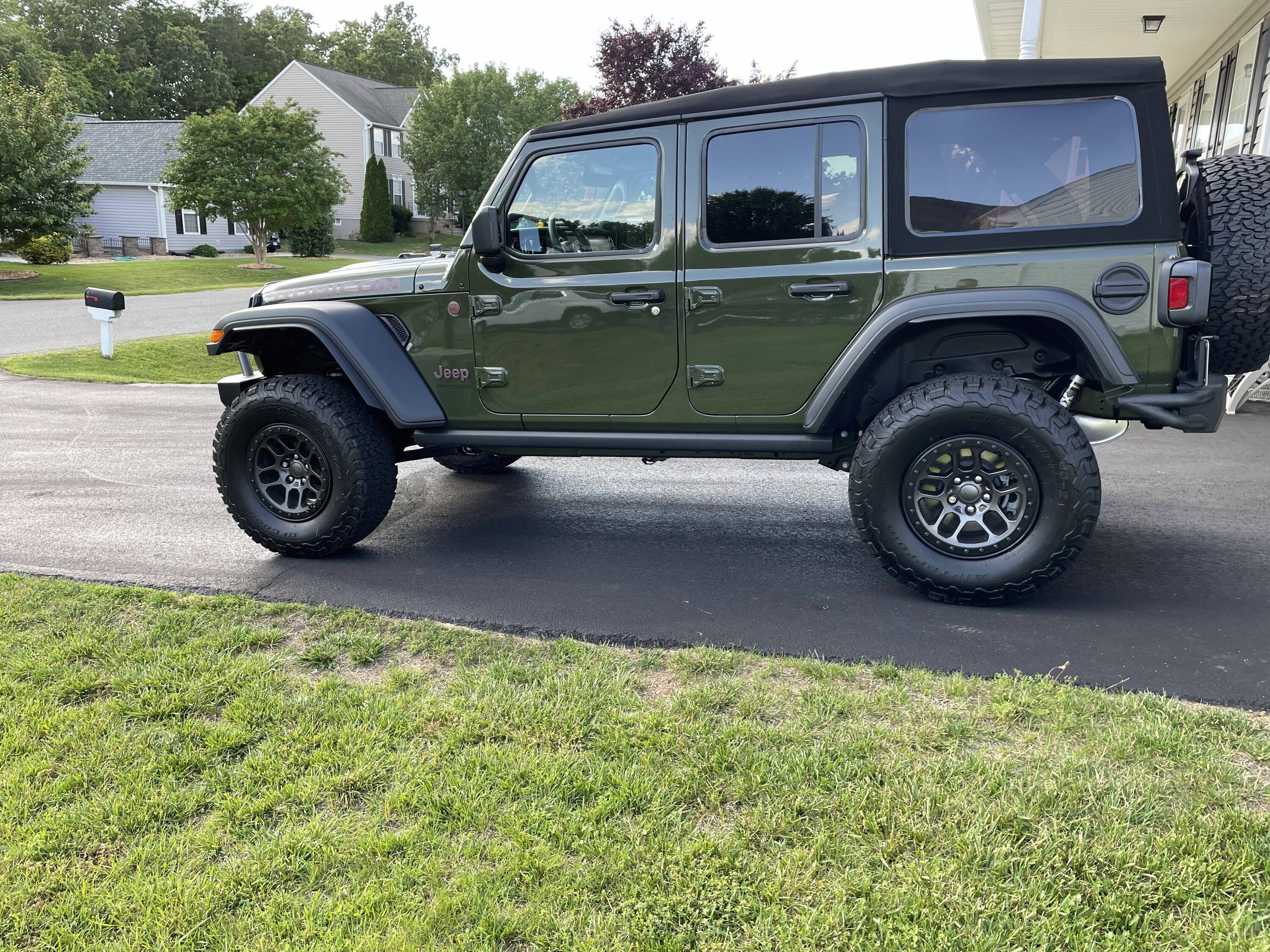

I got 2.5 on top of the 1.5. 3000 miles and still 2.5 over the XR 1.5. Did not loose any with settling. I am not light weight either. So for those keeping score thats 4” on a ruby if my math is right. Measured many times at different locations. There are a few others out there that got this much From the 2.5 lift. It rides great though. Just higher than i expected.

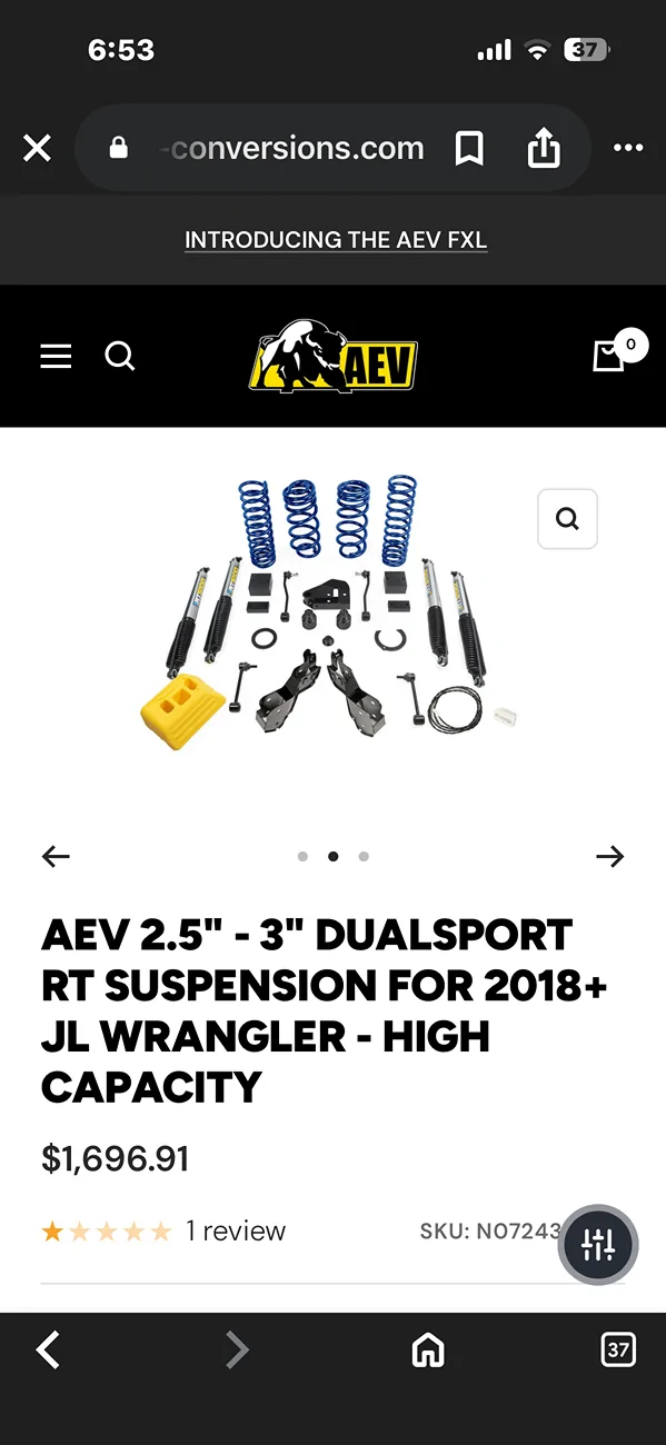

Thanks Twisted.
Those look like 37s, are they?
Any rubbing at articulation?
You went with the 3” high capacity?
How is the ride?
Is this the kit that you have?
thanks for the info!
