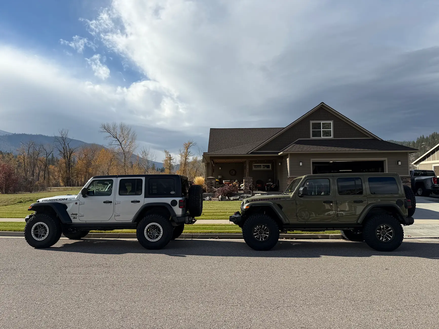

Thanks Twisted.
Those look like 37s, are they?
Any rubbing at articulation?
You went with the 3” high capacity?
How is the ride?
Is this the kit that you have?
thanks for the info!
38-13.5x17 on kmc tank w/ -38 offset. no rubbing.
rides great. i did put an adams front driveshaft in, not sure i really needed it.... That is the kit and I went for the 3", yes. I also have a 1" teraflex puck in the front to keep it level.

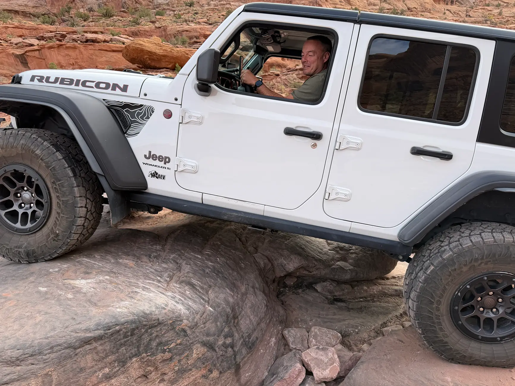

I have installed 3 of the AEV 2.5" on XR's (2023, 2024 and 2025) 2 were with 3.6 and one with 2.0 all standard springs. owners love how they drive and handle. I go to Moab with one often and it does great..I also wheel with @panhead6 in Moab and he has the same
This is awesome to hear. I’m assuming that you run 37s with this kit, as it looks like it in the pictures.
I’m going to EJS next week so maybe I’ll find a deal on the AEV kit at Vendor’s Row on Thursday before I leave. Otherwise I think I’m going to go that route anyway, I’ll just have to pay full price like common, non EJS folk, haha.
Thanks you and Twisted for your experience and advice.
Two quick questions for you, did you change drive shafts for this kit? And did you run a puck in the front to keep it level as well?
Twisted says that he did but he has a 392. I have a 1” puck on mine now to level it out on the XR springs.

no issues with stock driveshafts..the geo brackets actually help in that regard..no pucks needed on either the 3.6 or 2.0. yes on the 37's. unlikely you will find a deal unless on a used one as AEV does not allow discounts which kind of sux but it is how they run their business model..
