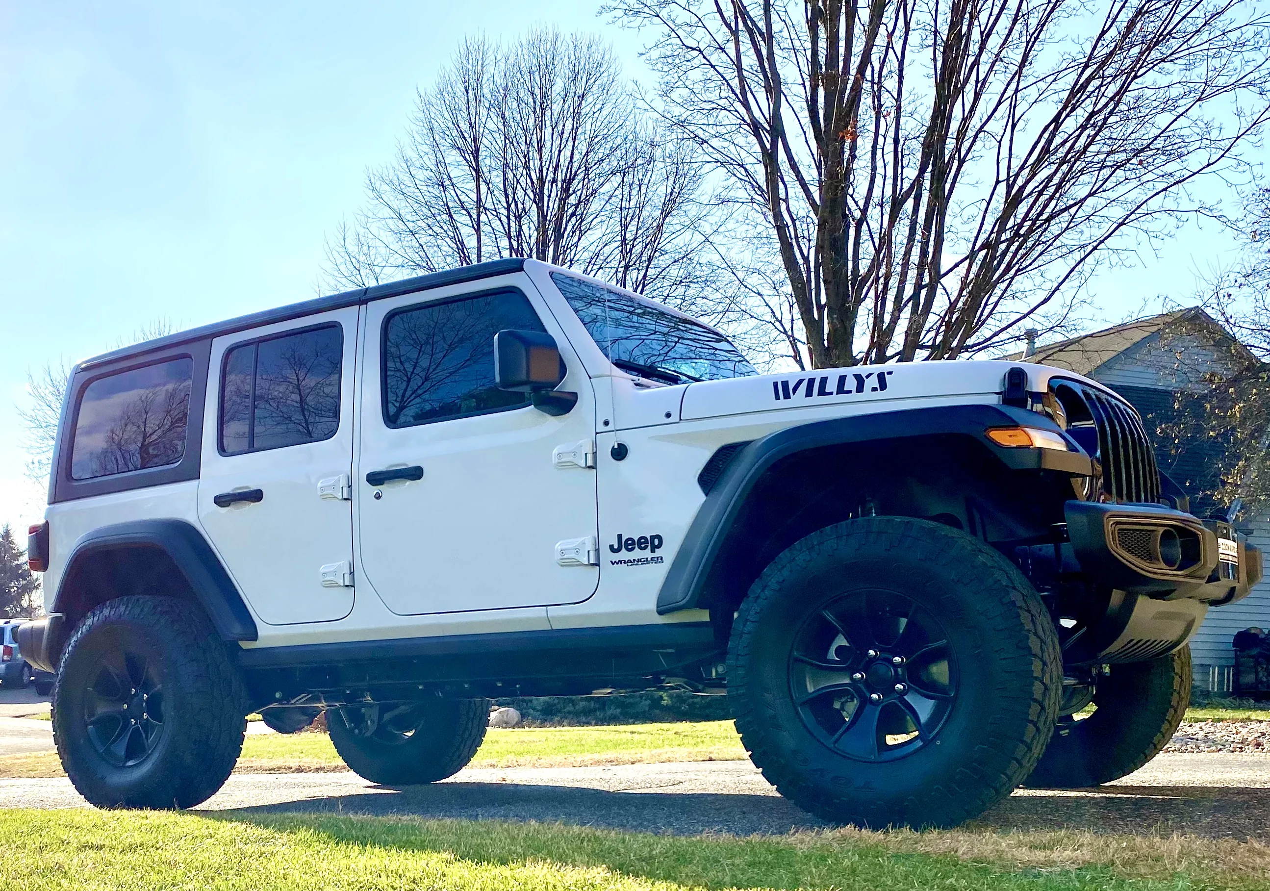

Before we had this rig (Willys XR) we had a Willys non XR.
We did lift it and added 35's but in order to do it "properly" we bought the Mopar Performance wheels.
Jeep Wrangler JL Xtreme 35 rimlock delete EXBtVRE
I liked the blacked out look and it took a while for the XR wheels to grow on me.
I do like them now but typically I don't like a lot of shiny bling. These are pretty understated.

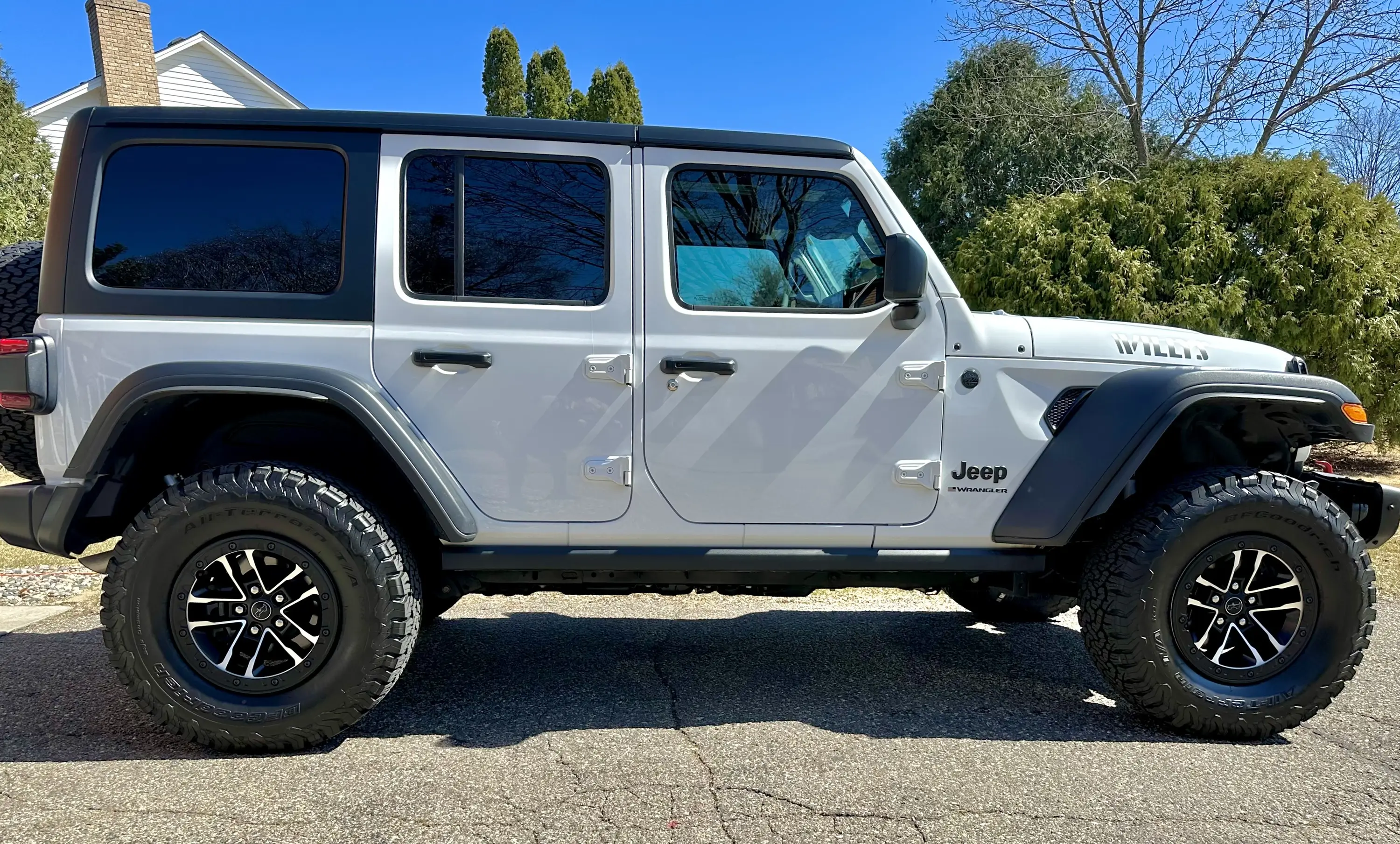

Jeep Wrangler JL Xtreme 35 rimlock delete nj2Cdhk
I never considered the weight of the wheel alone, but I was glad the KO2's were C rated ad not E rated like the Toyos we had before.
I'd have to go back and look but I think those Toyos were almost 10 pounds heavier per tire.
Adding the Mopar steel bumper likely negated any weight savings I gained with the lighter tires.
You could easily sell your wheels if the weight savings is actually significant.

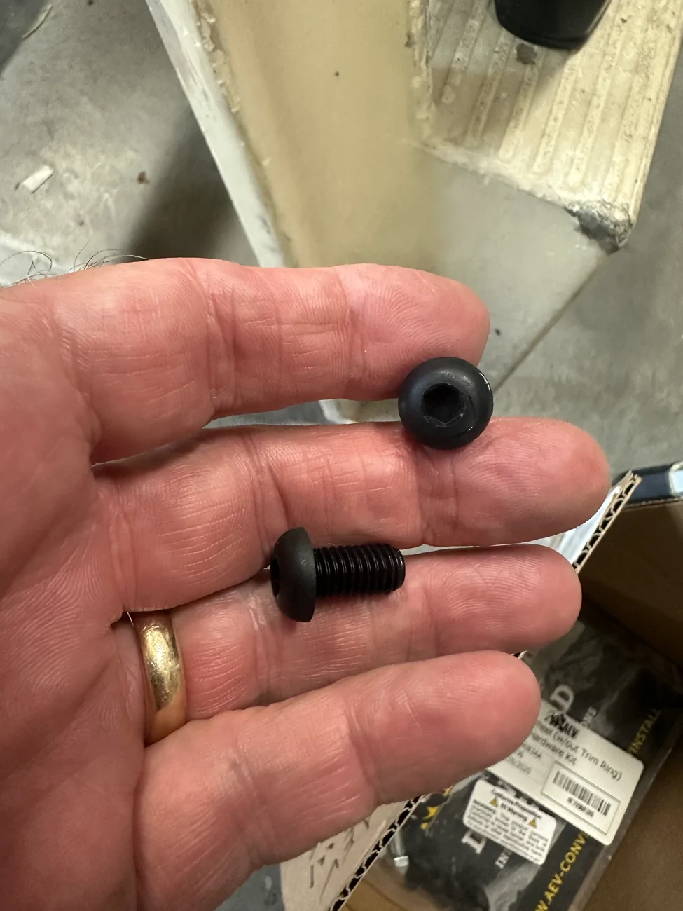

super easy to pull off and you can also get plastic bolts to fill the holes to keep debris out of them...not sure what size OEM uses but AEV wheels use M8-1.25
Yeah, that's an interesting idea. I'd not thought about using plastic bolts
