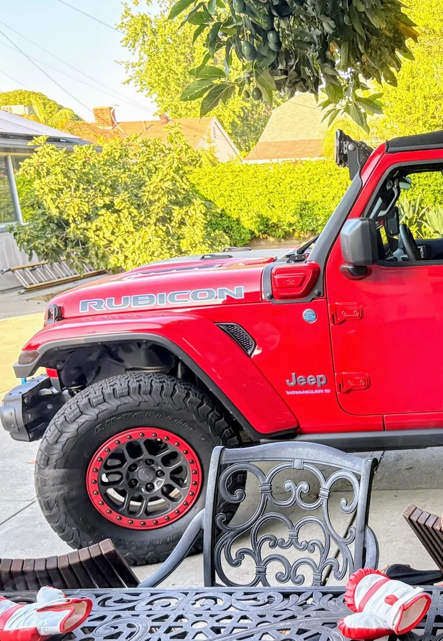

one way to do it: spray some plastic-dip before you put the paint and clear coat and it becomes easily reversible to stock or different color.
I had a local paint shop mix me a can of my color (~40$), and with clear coat on top, people are generally surprised to hear it’s not an oem-color matched option.
Looks great! How durable is that? I know its obvious any off roading will scuff anything up but asking more along the lines of can it be peeled by hand easily? Sorry if it's an obvious answer, can't say I have much experience with Plastidip

They’ve taken a year+ of city driving, a handful of camping/mediocre trails and a few pressure washes without any blemishes. It will peel if you use your nail to tear/catch on to a place-from my experience, a light first dust coat of PD, followed by a few layers of thicker coats, before paint and clear coat make it thick enough to last and super easy to remove.
I did the same for my charge port cover and door handles, wholly expecting them to get marked up from constant use but they’ve also lasted without any visible wear.
