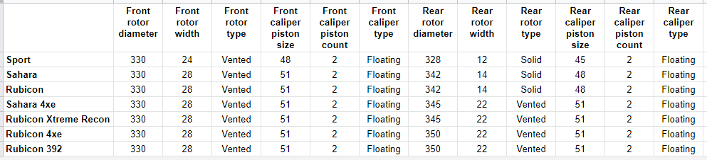

Does anyone have the part numbers for the brakes that come on the Recon Xtreme package? Only thing I can seem to find is the Mopar kit but it claims that they are the Rubicon brakes.
This is what you got would be my bet$$
Usually I put EBC Rotors and brakes (Green Pads) on the front of my Jeep. My 2023 here I don't need them, I can stop of a dime, I am amazed how how great this Jeep stops and I have GY Duratrac 35s on it, NOT a light tire...
Jeep Wrangler JL Recon Xtreme brakes FILE_3131 2

I have two with the XR package and neither of them "stop great". Im surprised to see you said it has the best bite. I drove a loaner Gladiator and it would almost throw you through the windshield. Both of the Wranglers the pedal is soft. If I pump them it will stop great. No leaks and already had them bled to be sure no air so figure its just the way it is.
Maybe they just needed a good bleed?
The XRs and all JTs have the same brake calipers and rotors.
The master cylinder and brake booster are different between the wranglers and gladiators, but don't know if it is a performance thing or ?

They were already bled. Stops slightly different but still nothing like the gladiator loaner.
