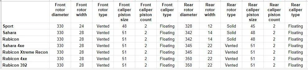

What is the differnce between the standard brakes that come with the Rubicon and the "Anti-Lock 4-Wheel Disc Perf Brakes" that come in the Extreme Recon package?

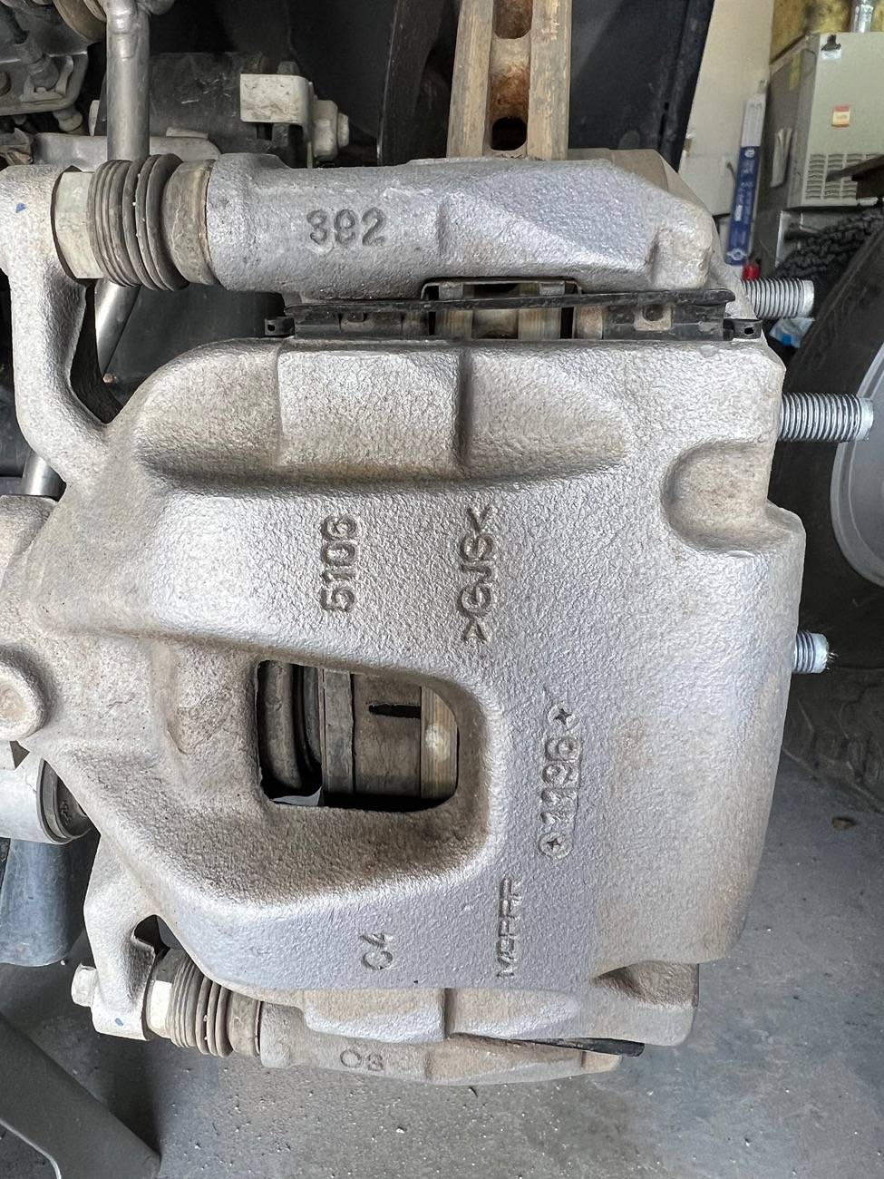

I have a ‘21 XR and the calipers have “392” stamped into them.

Based on the grid that @AnnDee4444 it looks like the fronts are the same on everything but the sport.
In the rears there are a few different rotor and caliper combination. Looks like the 4xes, 392, and XR get the same calipers. And the rotors are half a centimeter biger in the Rubi 4xe and 392.
