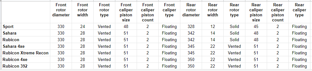

AnnDee4444, I found your Wrangler brake components table by trim level for Wrangler on a thread called Recon Xtreme Brakes. That helps. So, there is not just one Performance Brakes package. The changes seem pretty minor, to summarize.

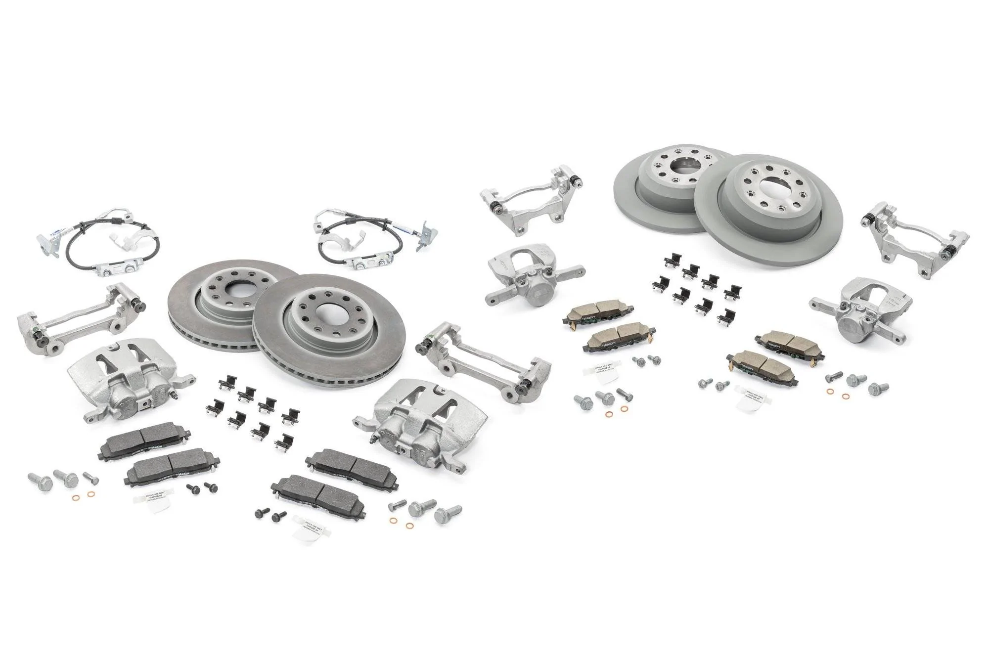

These should be the ones you are looking for:
Heavy-duty Brake Kit - Mopar (77072434)
See Recon Xtreme Brakes thread for more discussion of this. If they had titled that thread as XR / Xtreme Recon Brakes it would be more searchable.
