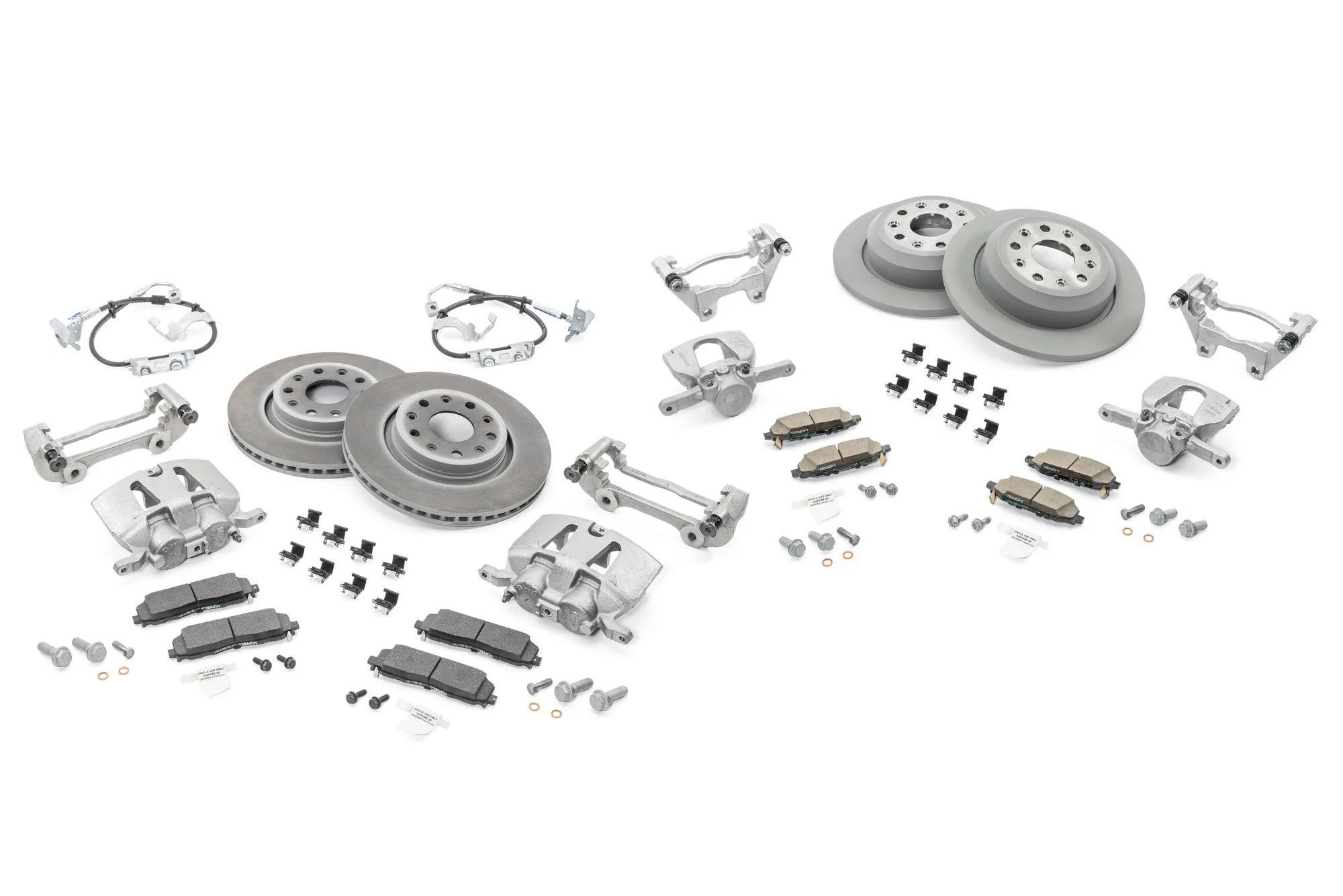

These should be the ones you are looking for:
Heavy-duty Brake Kit - Mopar (77072434)
If this is the stock Rubicon package then the XR, diesel, 4xE and 392 are heavier duty than this setup.
