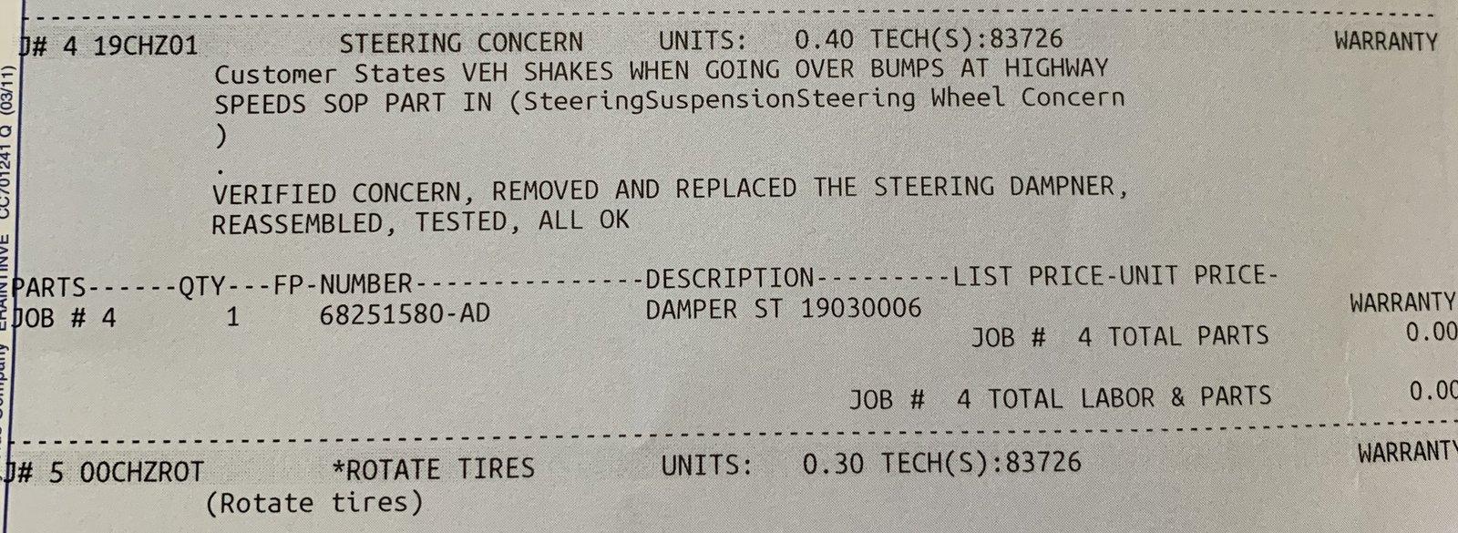

Was having similar problems at high speeds. They replaced the steering dampner and now drives really smooth.
Jeep Wrangler JL Wobble issue- Dealer replaced Steering Stabilizer AE62AEE9-396B-4A38-9F49-924098BDA6CC
You got lucky, the stabilizers are hard to find because so many have this problem. Seems to be an issue on the newer ones possibly. Some dealerships have taken to quality after market stabilizers because they can't get factory ones.

I suppose so. They were back ordered and it took almost an entire month for the dealer to receive them.
