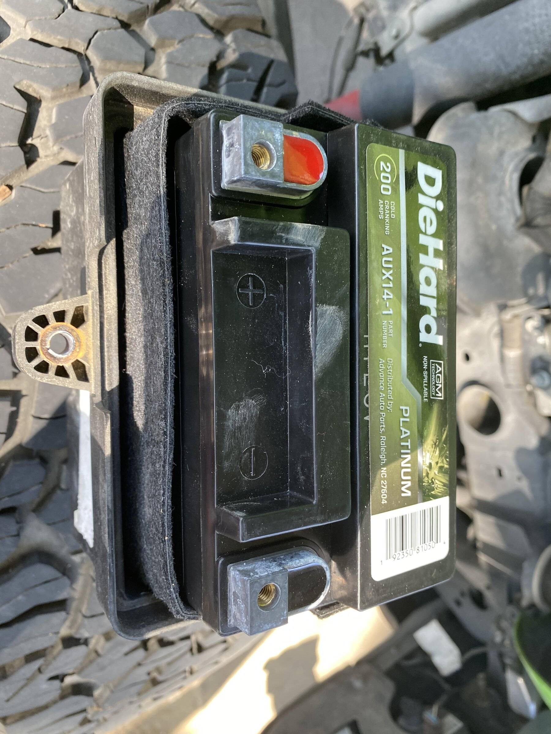

Great job working the problem and finding that solution!! I might have sat there for hours and never thought about disabling the ESS and trying again.
Die Hard makes a nice AGM replacement aux battery you can buy through Advance Auto Parts. At this time last year, they were the only game in town for that replacement. Others might make them by now.
I replaced both batteries at about 3.2 years as preventative maintenance. I went with an Odyssey pure lead AGM for the big battery and the Die Hard for the Aux. I plan on replacing mine every 3 years. Maybe 3.5, but no longer. I also decided not to go through the fender because losing one of the fender fasteners would be a problem. Last I checked, you could not buy them. So I went through the top, removing the fuse boxes. It wasn't as bad or hard as people have made it out to be.

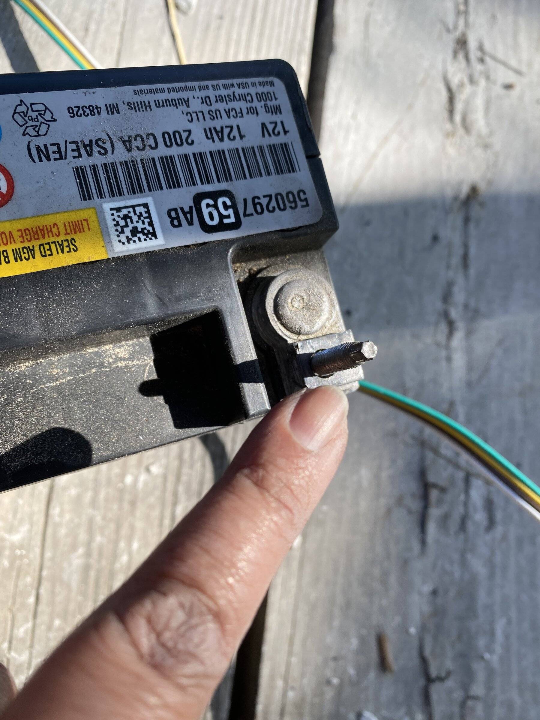

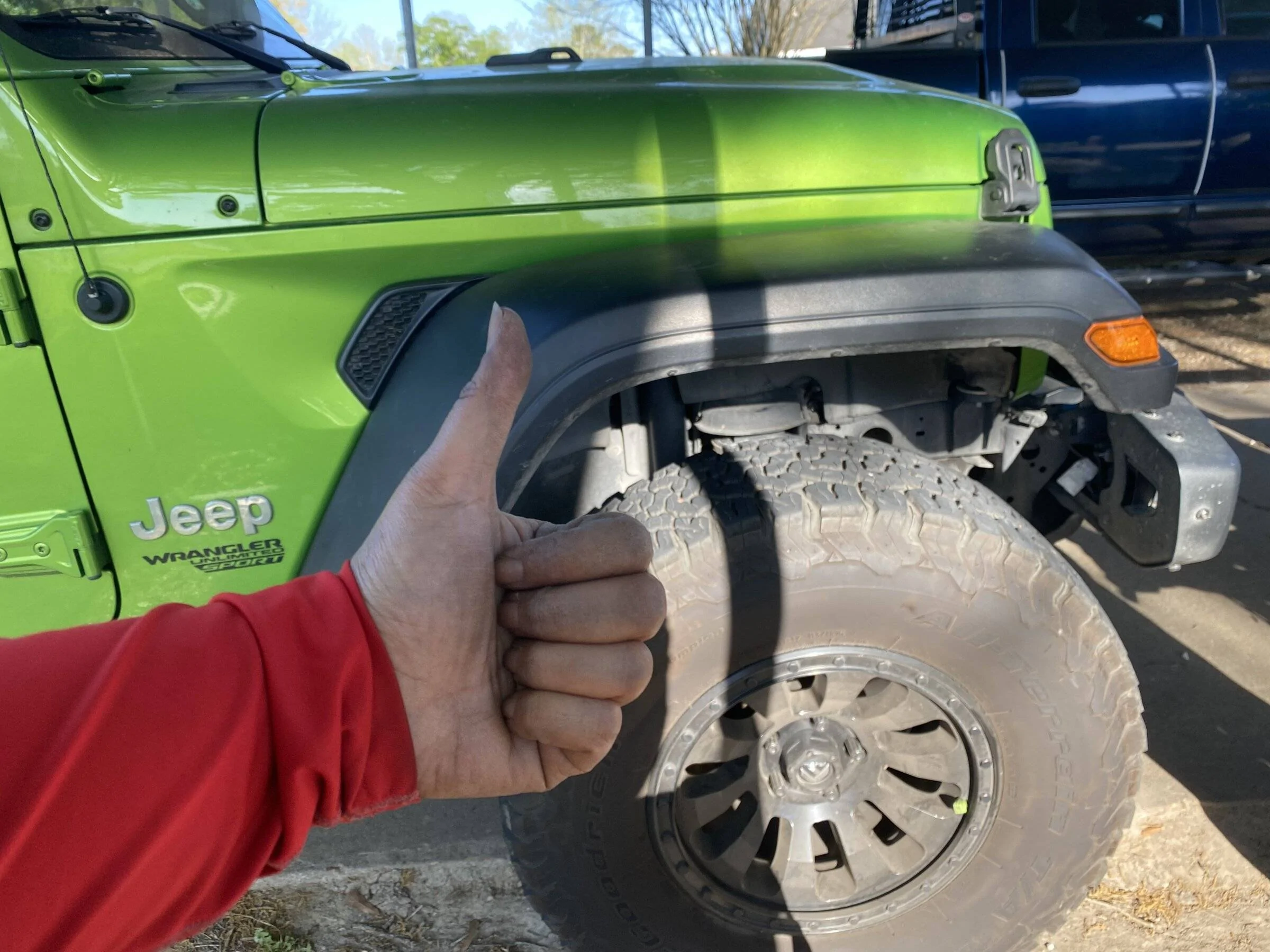

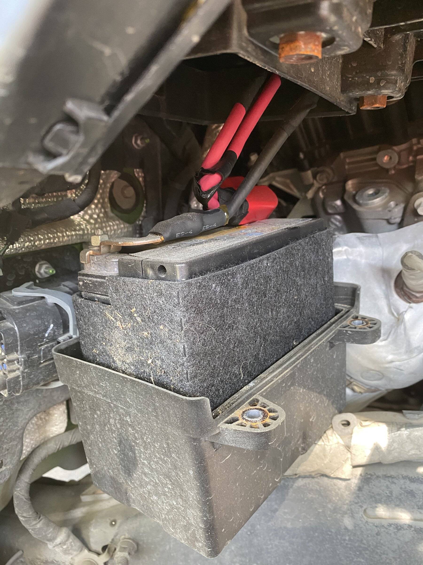

Thank you! However, my plan was trashed and thrown in the toilet by my Jeep Guy. He told me to replace the aux battery as eventually the jeep would misbehave and do some wild things and eventually drain the main battery. I wanted to believe the bypass would work lol. But when I told him I was gonna be travelling to Austin for MotoGP this week, he told me not to risk it!

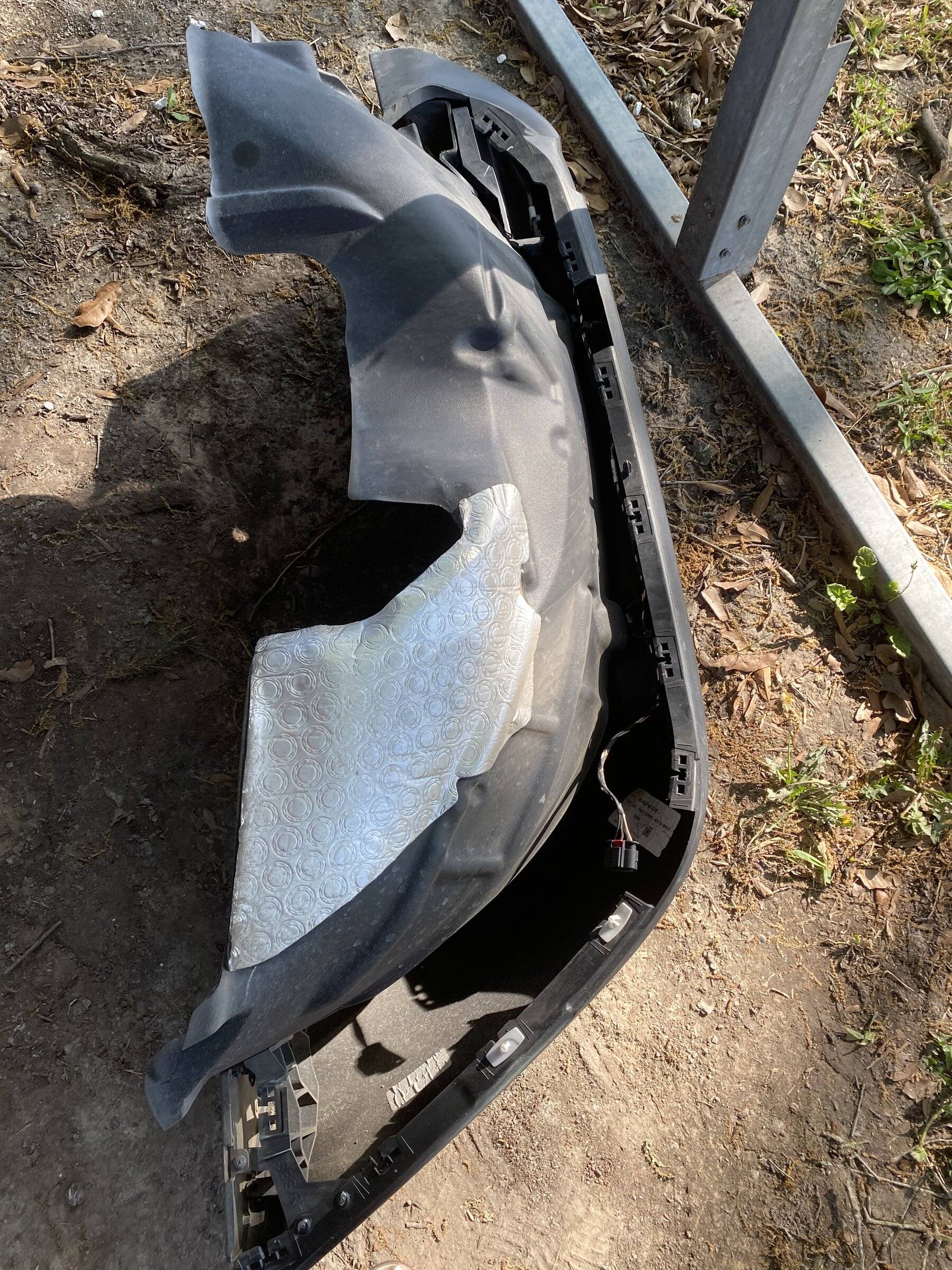

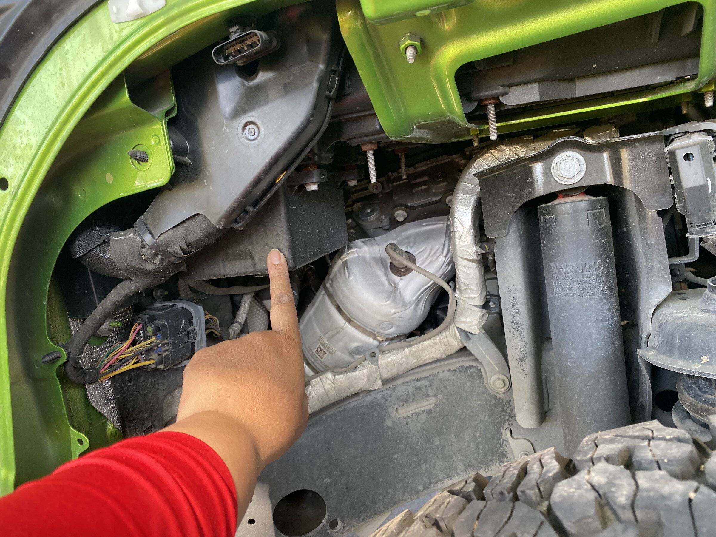

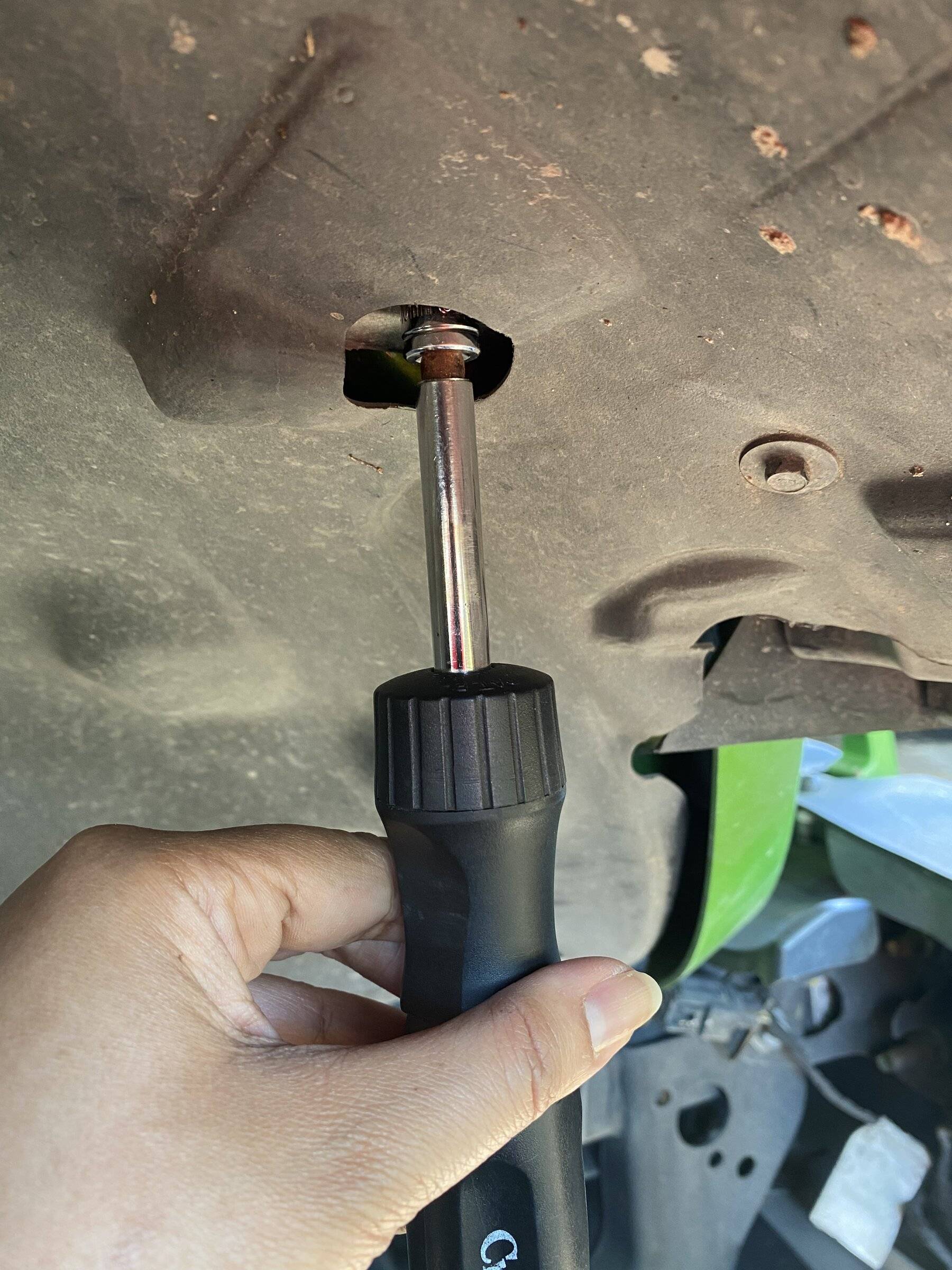

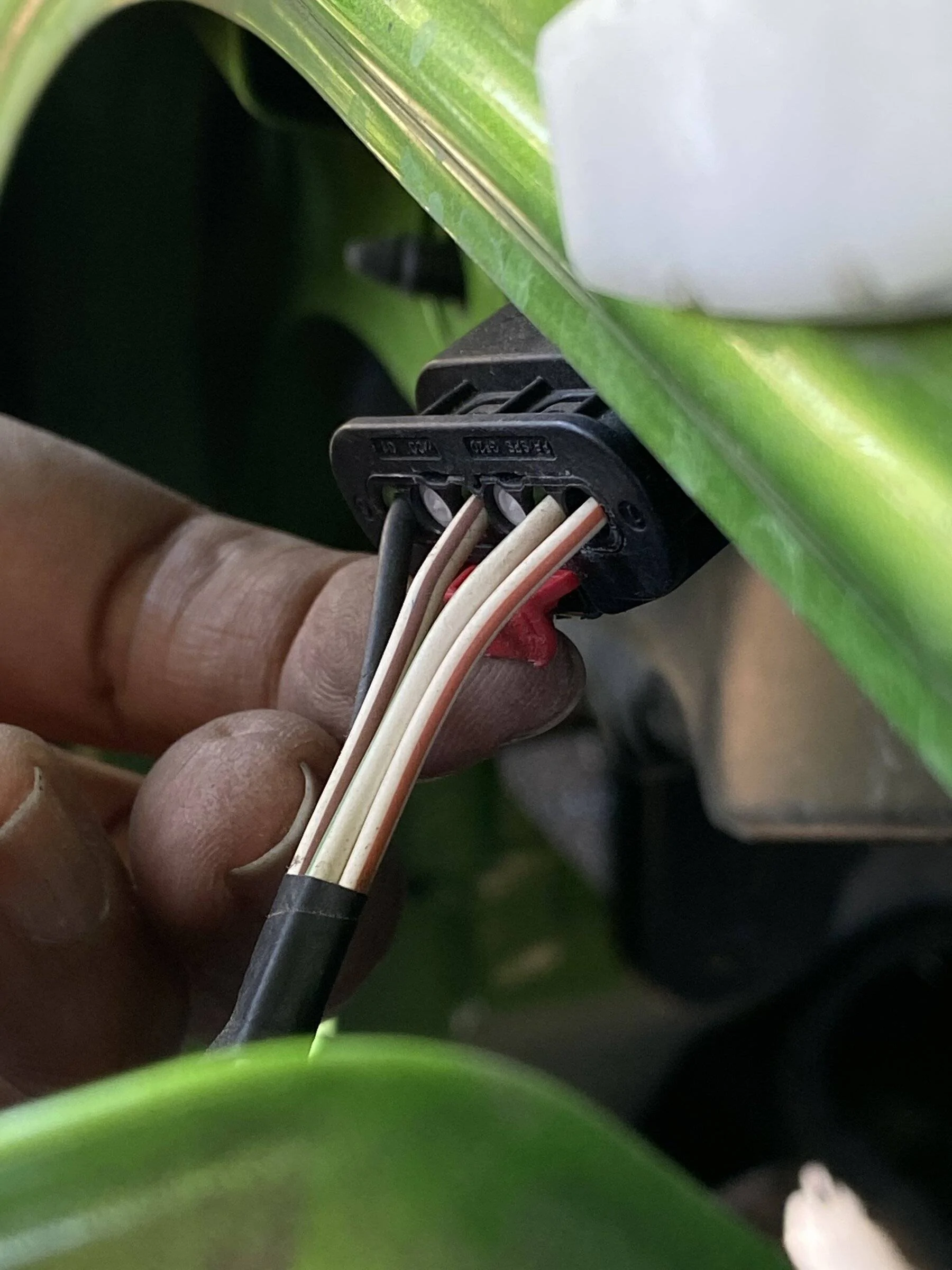

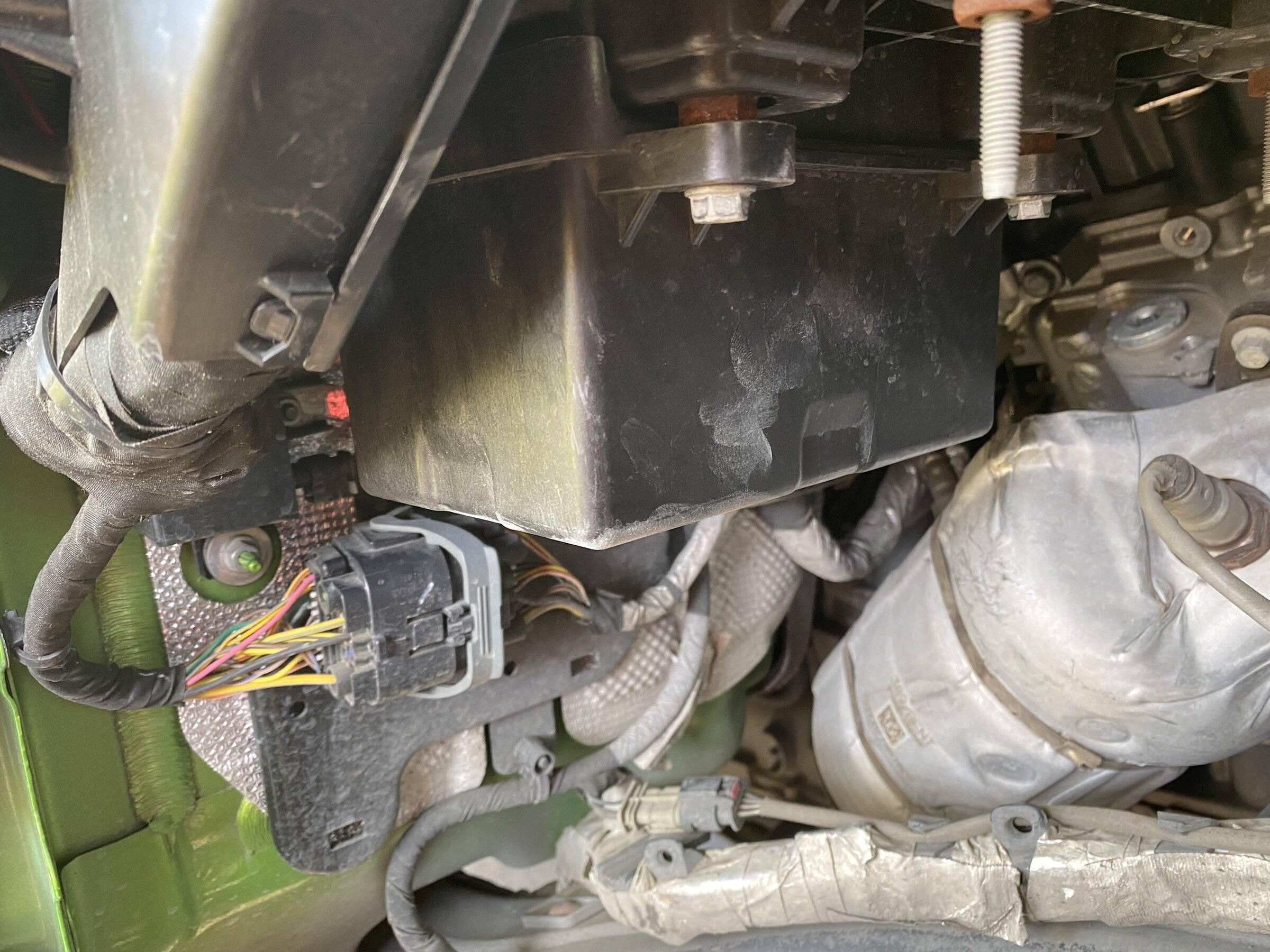

Iwas sad…but i found an aux battery at advance auto parts. I had some trouble at first and corporate got involved…did the leg work and found me a store that had it on their shelves. They also gave me a $20 discount!
i bought it, got home…took that fender off (broke 3 clips, but i still used them lol), removed the battery from underneath, (after removing/isolating the negative post from main battery. Disconnected the turn signal too.
The only issues I had were reinstalling the new battery. Those metal screw thingies that go into the battery posts…confused me! The new battery didnt have them. After close review of the oem aux…I realized i could take those thingies out and put them in the new one lol.
It was also difficult to hold the battery and put the screws back in. I asked my dad to hold it for me. Then I removed the white clips from the jeep frame and reinstalled them on the fender piece…even the broken ones lol. Surprisingly they still held in place.
reconnected the turn signal as well. Cranked the jeep…everything worked. ESS error message was gone.
glad that job is done and glad i saved some dollas! Returning the core tomorrow for another $20 discount! ?
hope this mini write-up helps someone!
