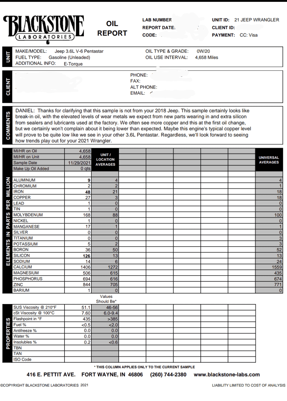

I did our 2021 3.6 Etorque at about 4600 miles. That's what it had when we brought it home. I did a UOA o the factory fill and while loaded up with crap, the oil was still in good shape. I swapped it out for Walmart Supertech 0w20 thinking I'd do a very short run just to clean it out. But the oil's condition was good enough that I'll go ahead and run the Supertech for 5k and then move over to Mobil 1 EP 0w20 and a Fram Ultra filter. So it has its second change coming soon. My wife is piling the miles onto that thing!
Here is the UOA from the factory fill. I've no idea what the oil was. Probably a Pennzoil product, but who knows? But it was in good shape with the flashpoint showing no fuel dilution.
I have to say the factory Mopar oil filter did a good job, too, with only .2 ppm insolubles. That's better than I have typically seen with Mobil 1 filters, which is what is in this one right now. The next one should be interesting.
