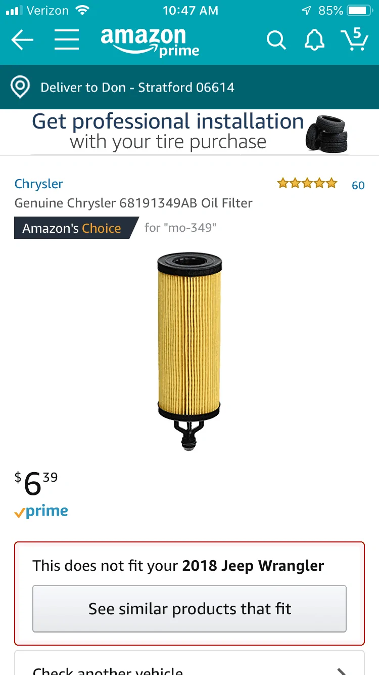

Yes, their database is out of wack... is wrong. I see this alot in regard to Amazon.
It is the correct oil filter.. I have purchased say 15 of those filters in the last 4 years. $6.39 is a great price!
Here is the link one more time: https://www.amazon.com/gp/product/B00ZPE0DLC/ref=oh_aui_detailpage_o04_s00?ie=UTF8&psc=1
I see there is a new version named “AC” from Mopar introduced quite some time ago that carries features the “AB” version seen in the link does not. They could be sending out the updated version but the listing does not say that. Just FYI for everyone.
@BoisetheCat
Well, they are in fact sending out the 68191349AC MO-349
Also, I would have no issue using the "AB" version.
