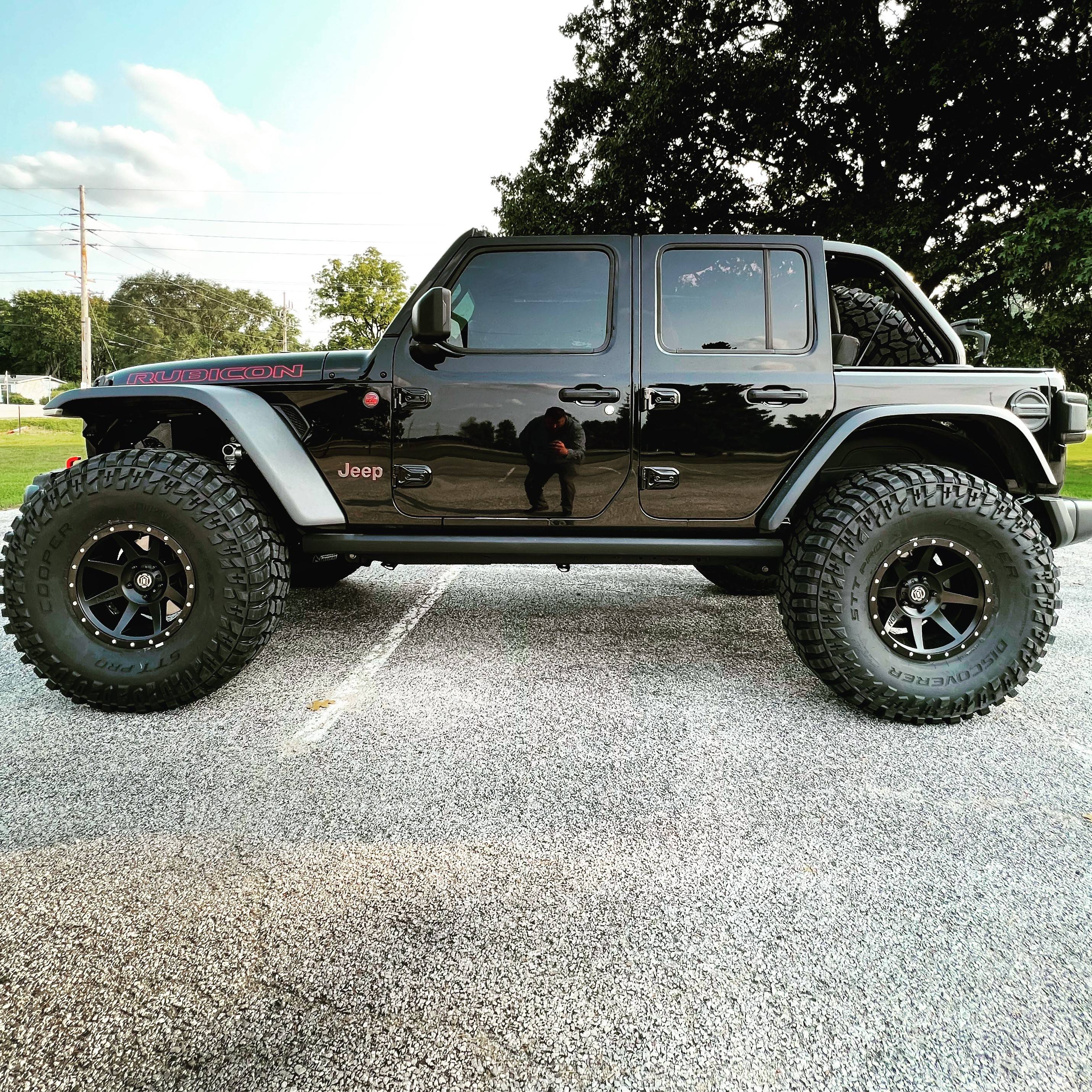

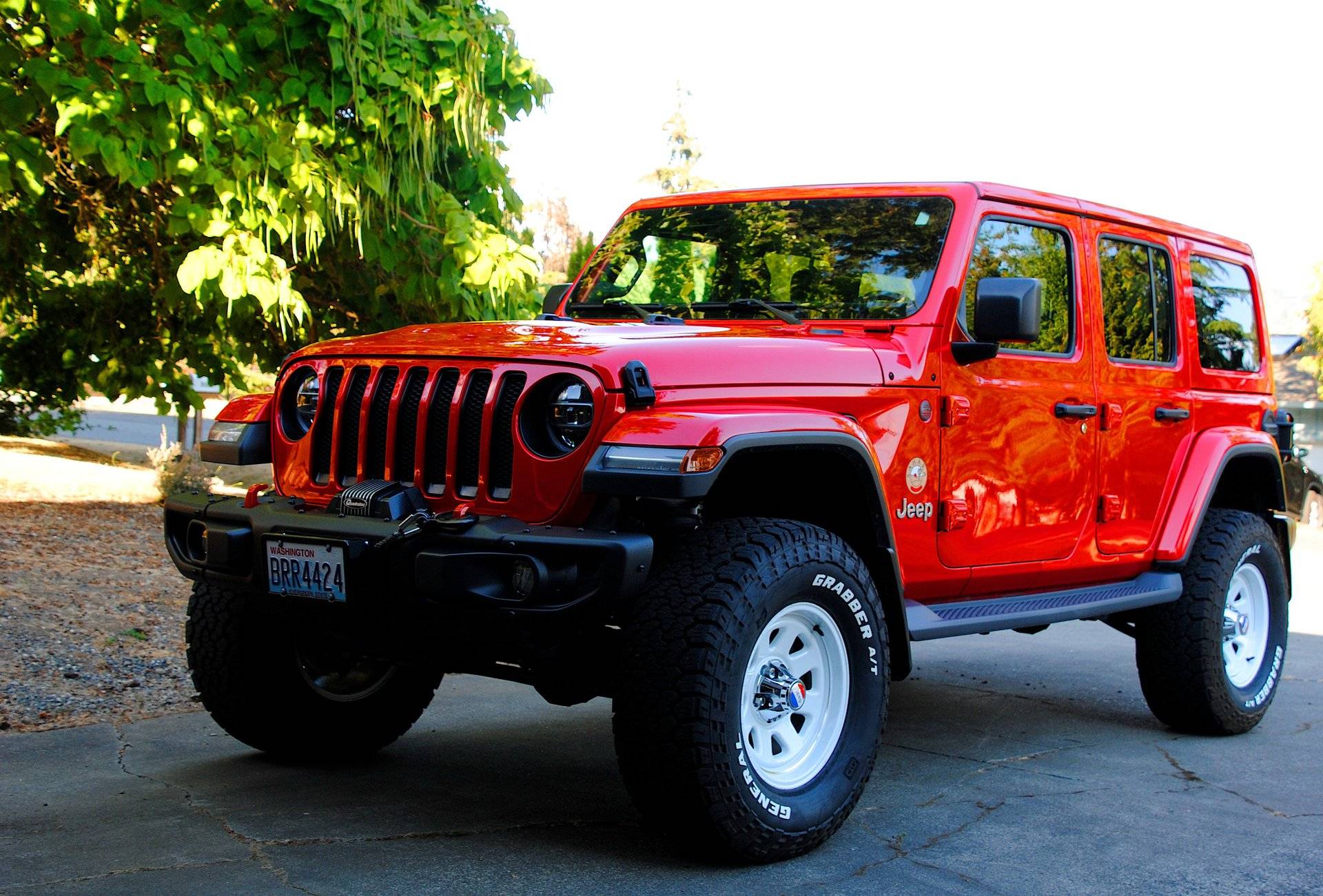

I haven’t measured mine, but it’s got healthy amounts of space down there with the Mopar lift, 35s and all.
One other thing to consider to avoid that squatty stance is to make sure your wheels and tires are not protruding too far past your fender line.

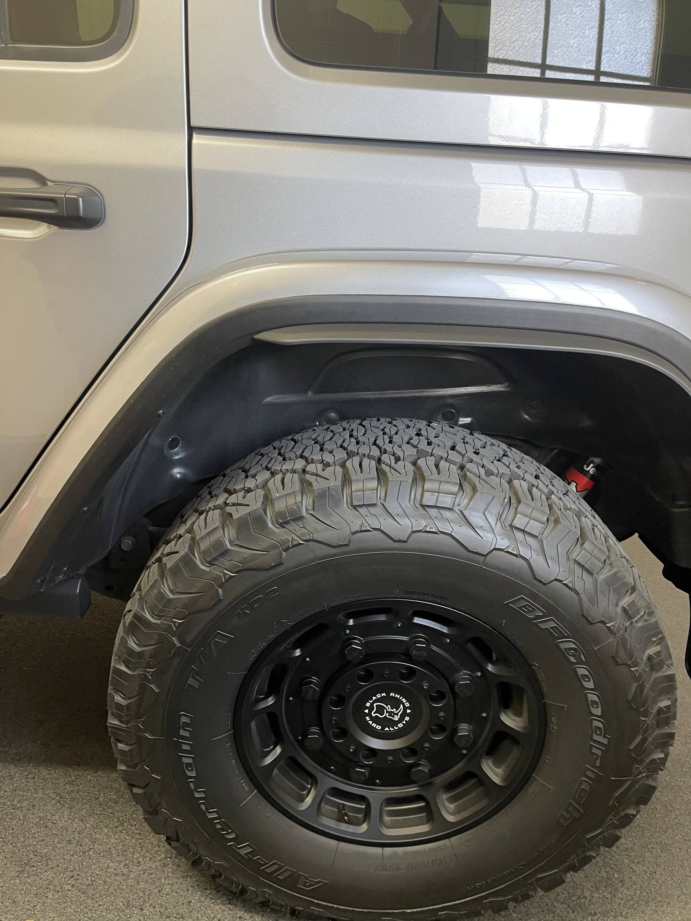

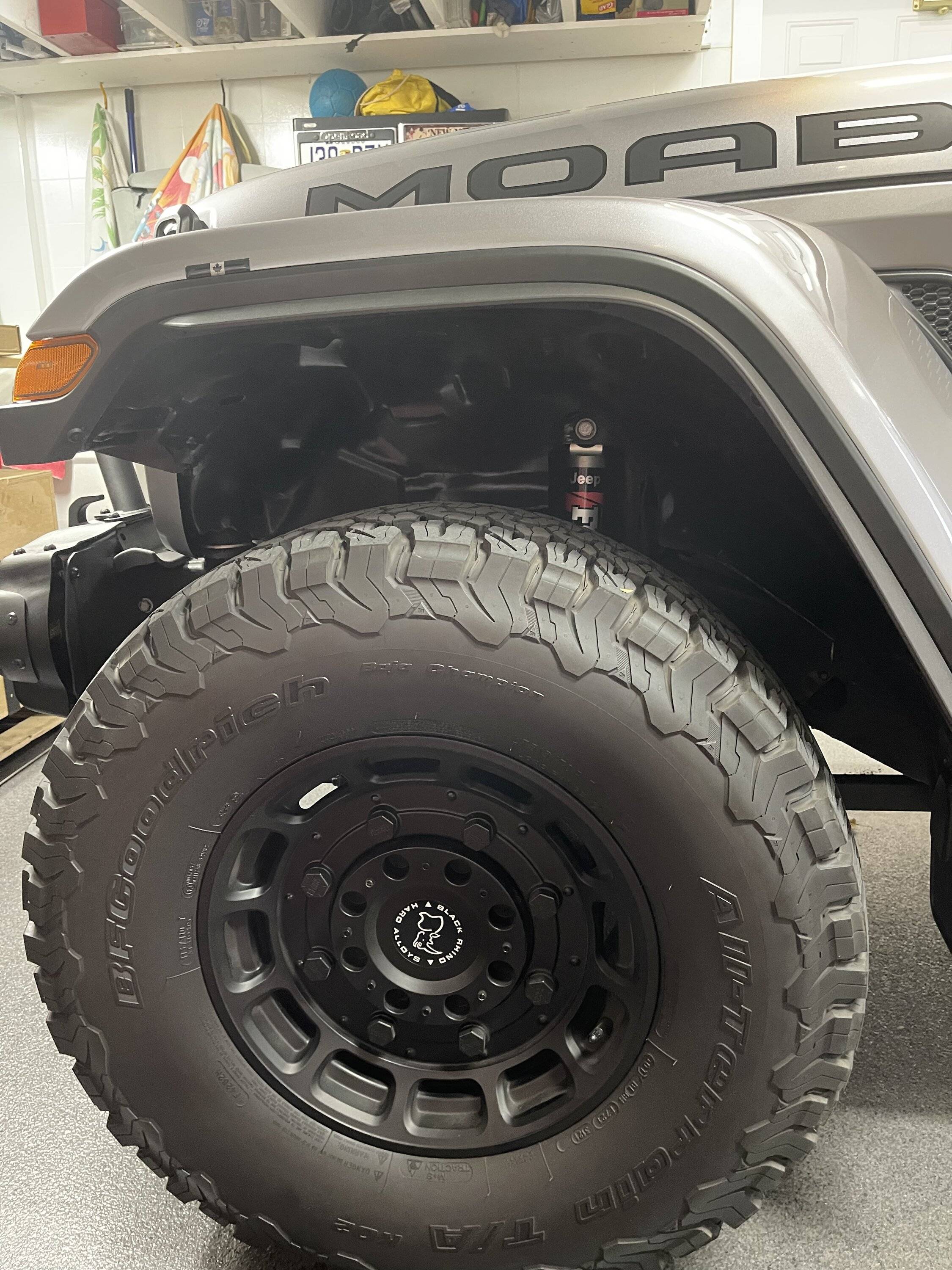

I have Rubi flares and these gaps are 7.5’’ front and 7.25’’ rear from top of 315/70 to the XR flare extension.

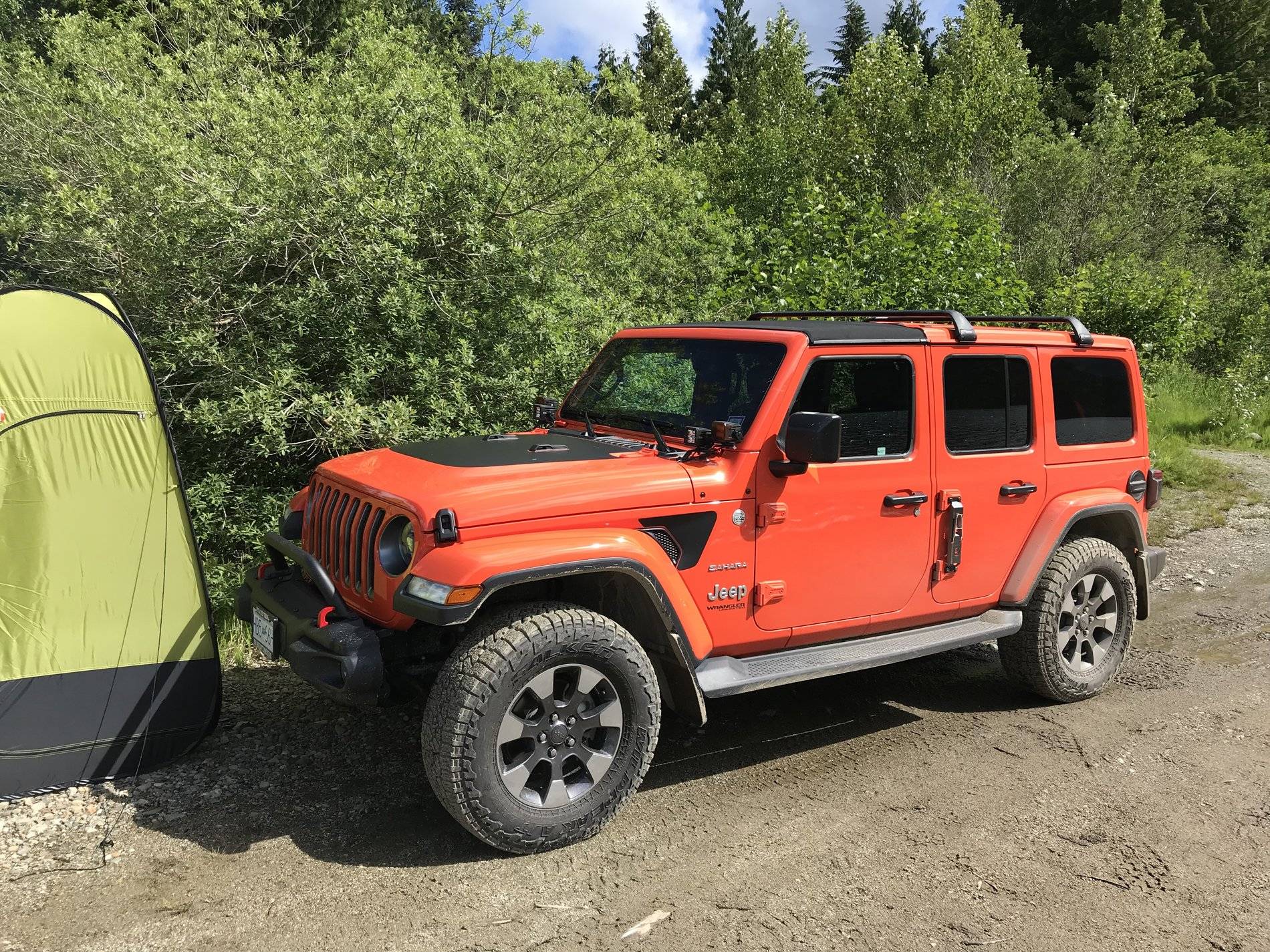

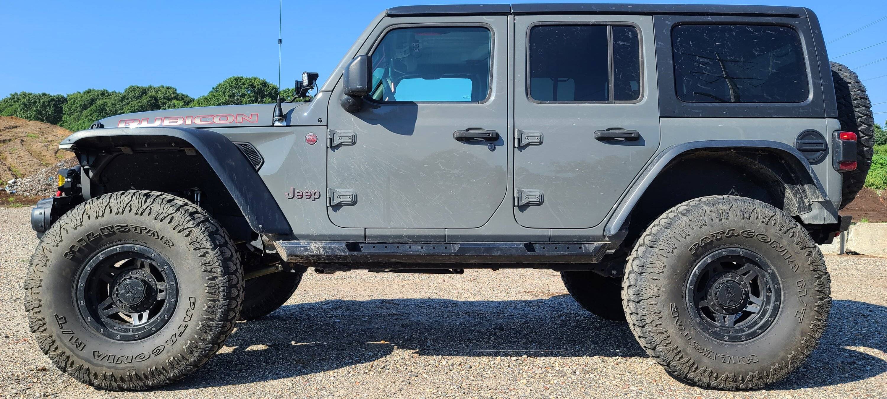

If you are willing to go to 18-inch rims you can go to 35s.
Those tires are 285/75R18. But you are limited by a selection of only a handful of tires —Goodyear Duratrac and Falken Wildpeak being the two most notable.
They look kick-ass IMO.

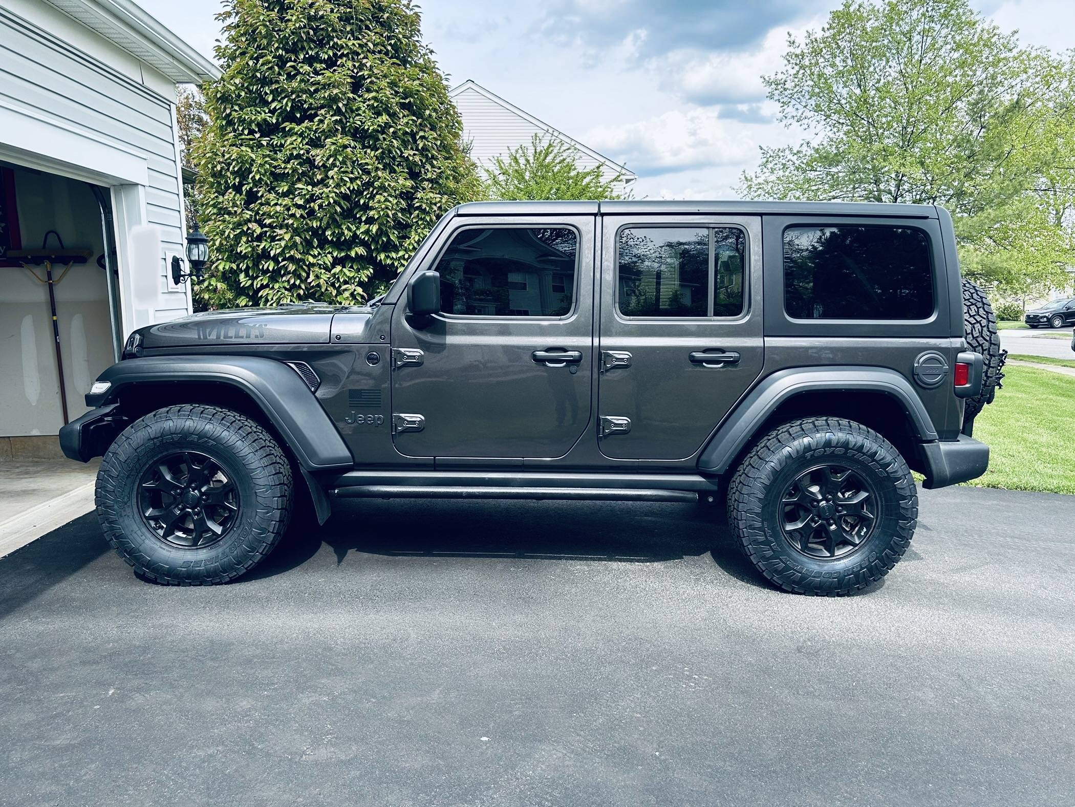

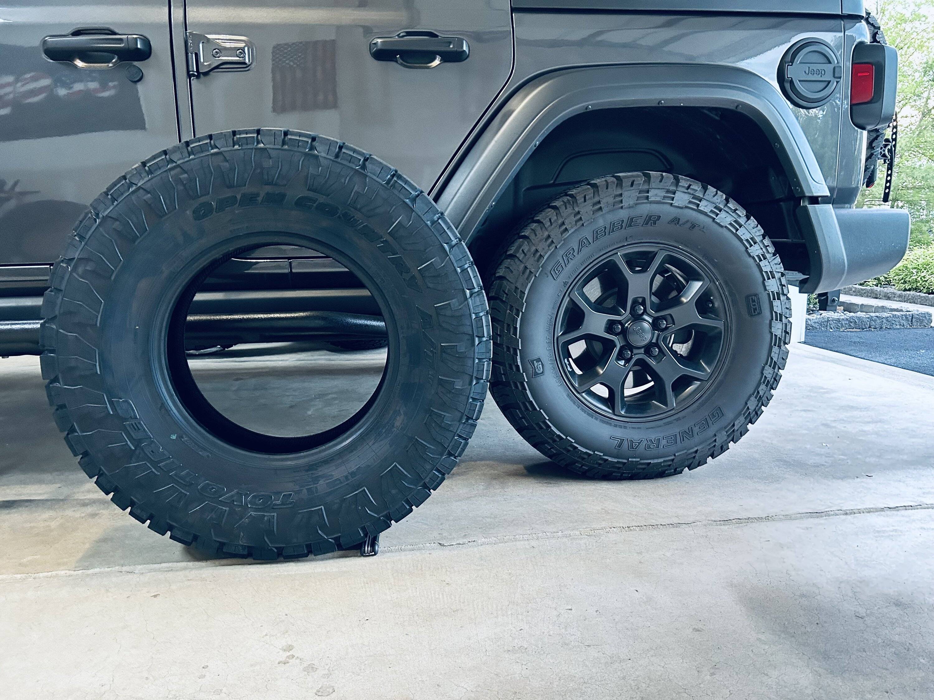

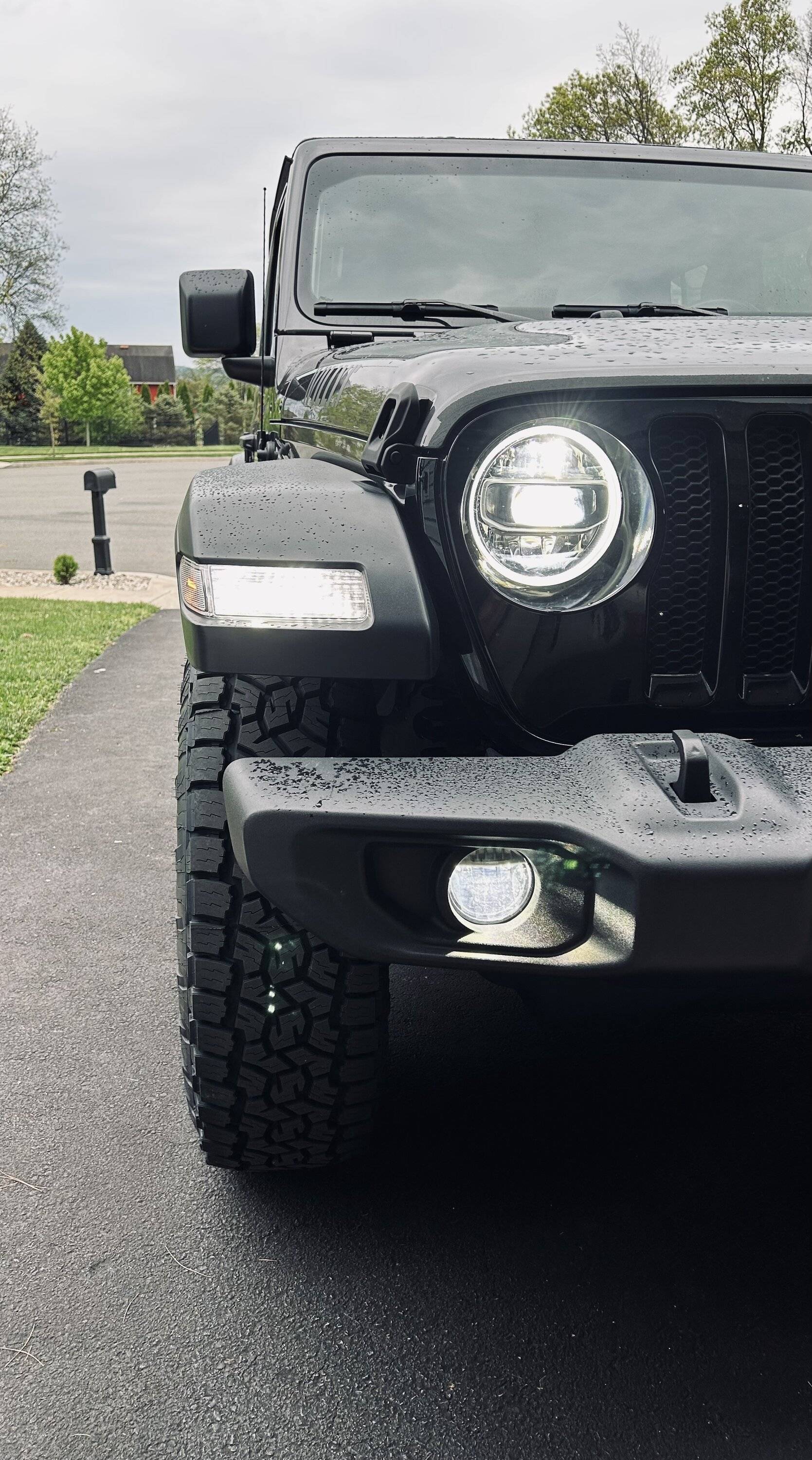

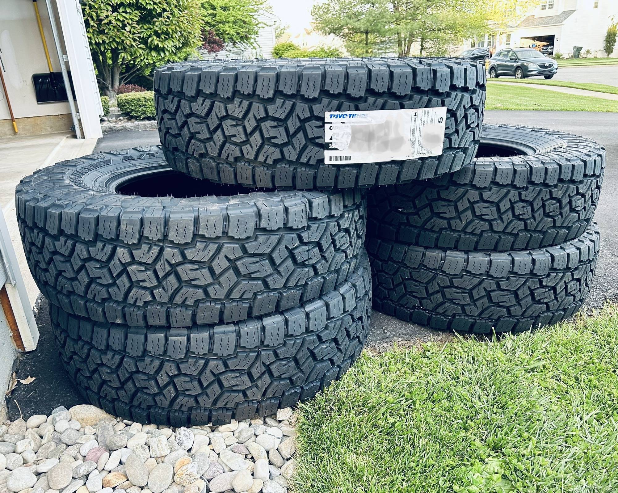

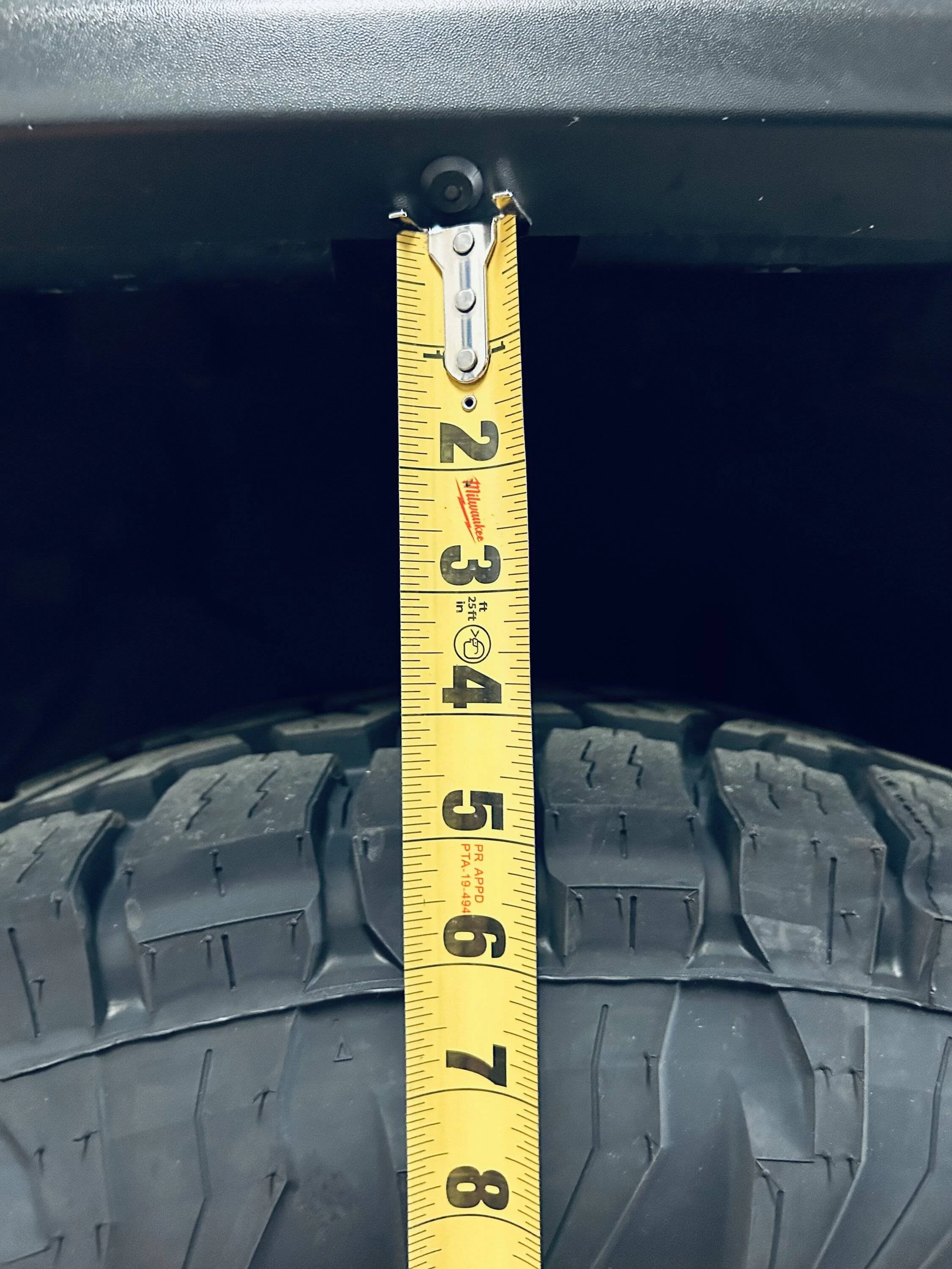

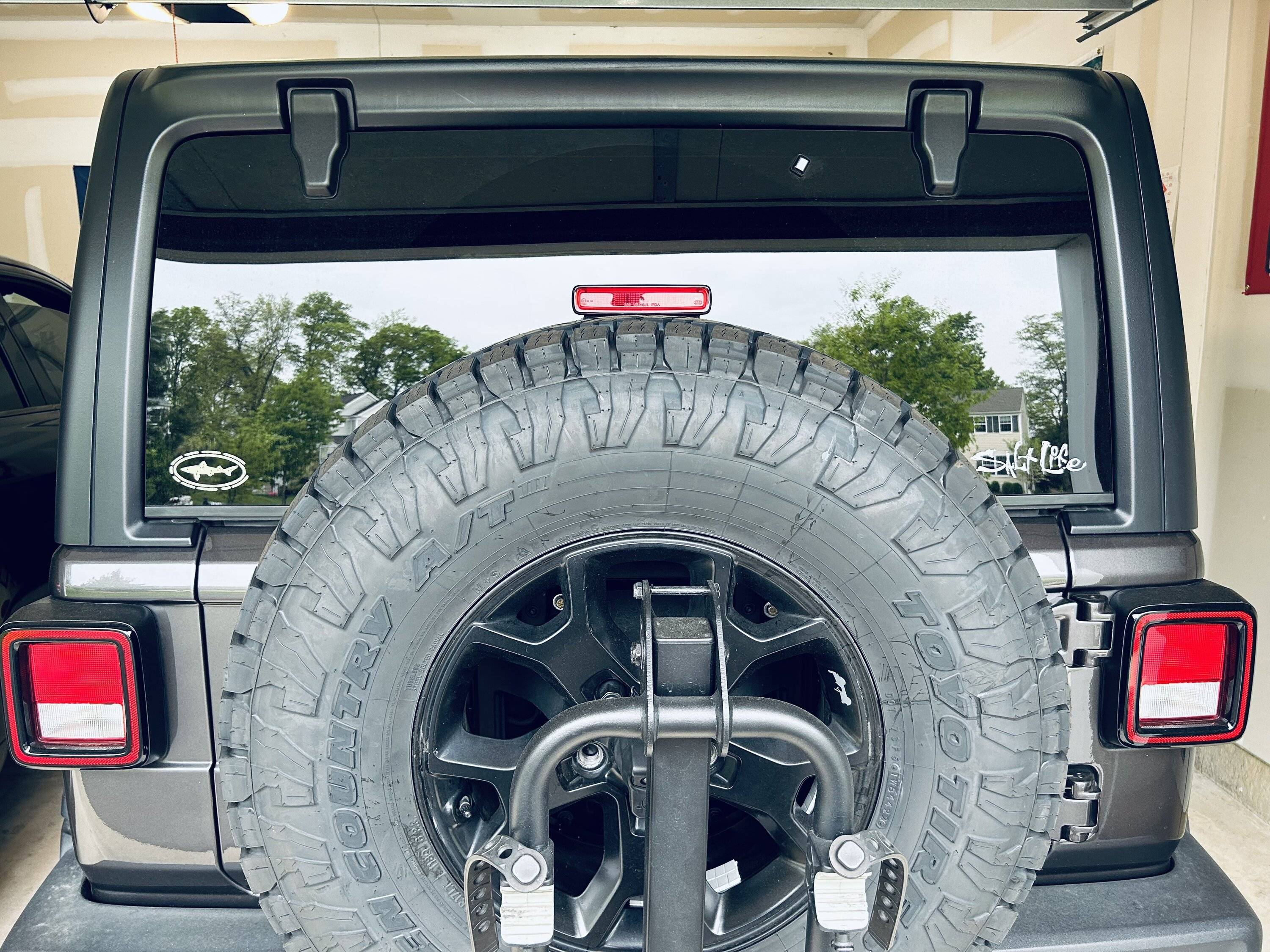

I finally decided on tires, 35x11.5x17 (Toyo A/T III, load range C). Once I found a 35” tire that didn’t poke outside the fender flares it made it an easy choice. Load C over and an E rated set is a noticeable improvement on ride quality, much smoother and quieter then the previous General Grabber A/Tx, E rated. Staying at 285 or 11.5” width seems to be the trick over a 12.5” in order to avoid extra stress on the suspension. I plan on adding a TF 1” spacer lift for added wheel clearance since I currently only got about 5” all around (6” seems like a good amount). Mopar LCA’s are also in the works along with Speedo recalibration. Side note, spare fit easily with a RC relocation bracket and I didn’t have to move up the rear third brake light(just clears it). Thanks for everyone’s input and I’ll post pictures after the spacer lift is on. I’m still trying to figure out a good tire psi, currently at 36#.
