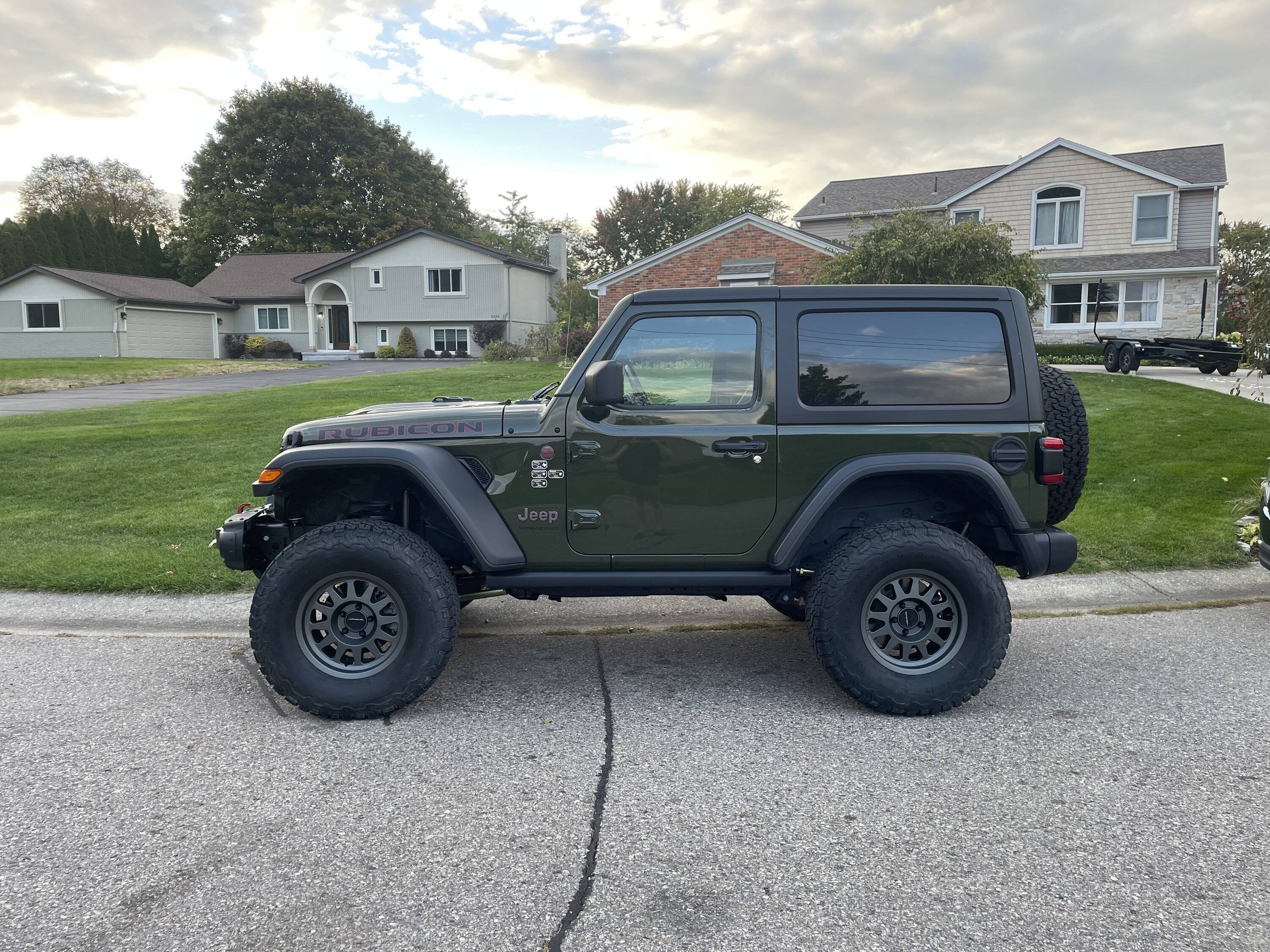

I felt my stock Rubicon suspension was too squatted with 315/70/17 KO2’s. Personally, love the look with my 2.5” Metalcloak Game Changer. Some feel like it’s too much gap, but I see it as more room for up travel. I don’t like the tires to fill the wheel wells too much at ride height.
I have about 9.5” in both the front and rear wheel wells from the tire to the inner edge of the fender flares.
If/when I go to 37’s after these wear out (or I get bored), I will likely swap springs to the 3.5” to keep the same gap. All the other components are the same so it should be pretty easy.

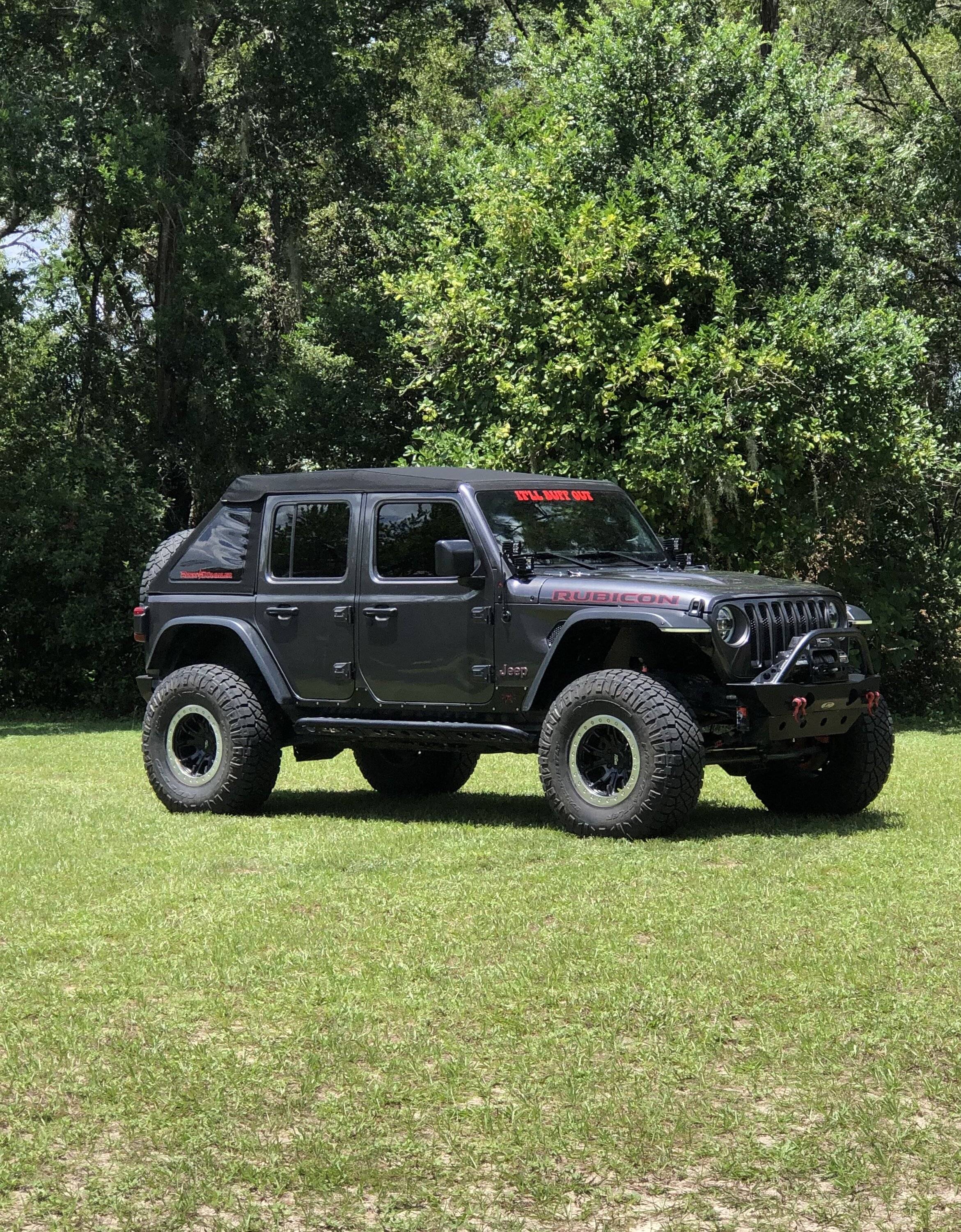

Different lift height and tire size than @Philly_ but same gap, around 9” ish…. But I built my rig for maximum articulation so I need every inch as demonstrated in my avatar….lol…..to quote the wife, “ it looks more off-roady” …….?

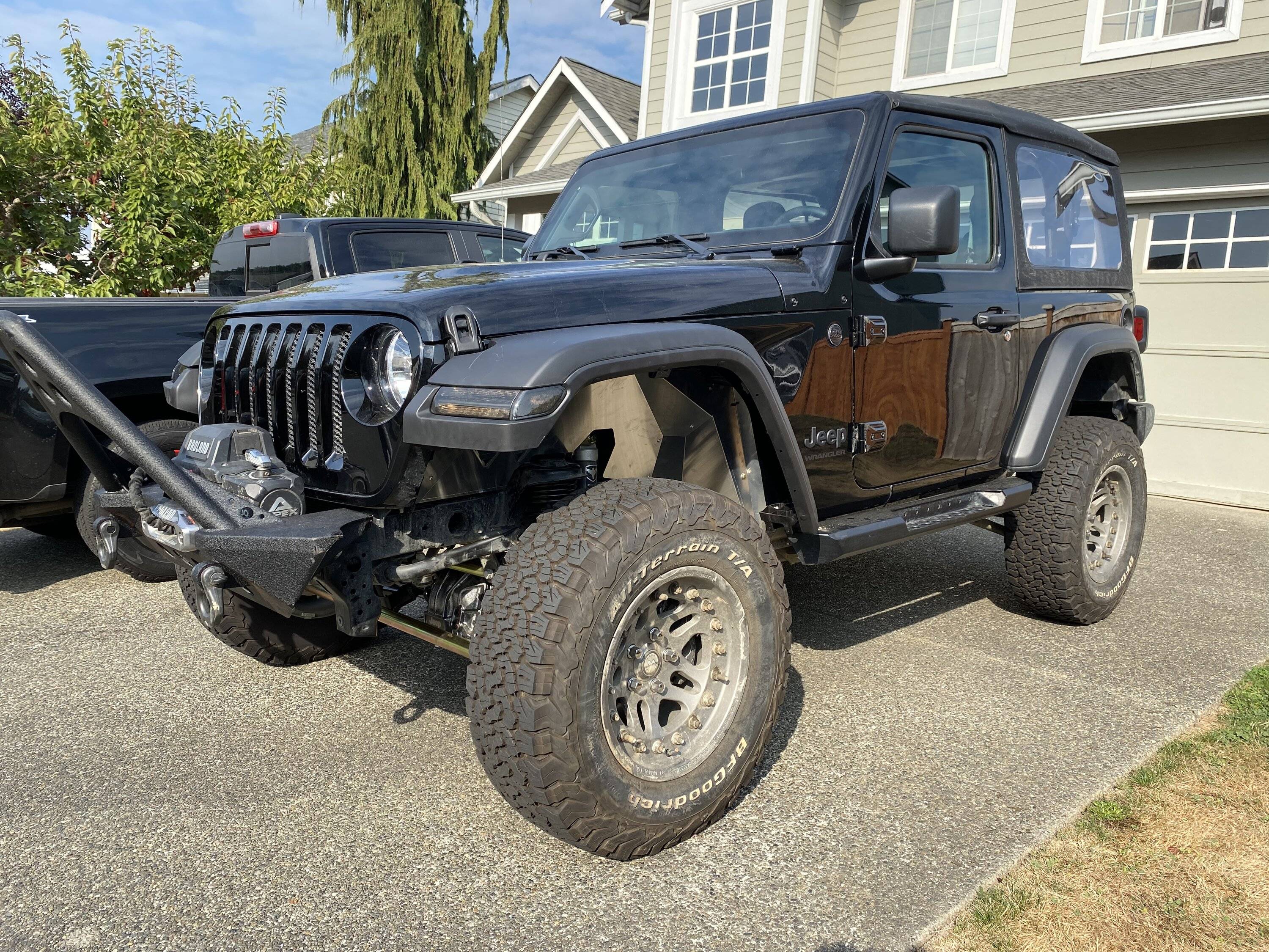

I love gap, mine is on 285/70’s with the same springs:
