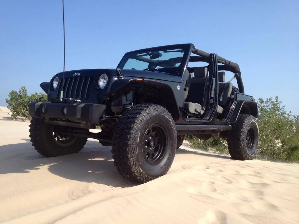

I have had two Wranglers before this. A 2008 JKU on 3.5" lift and 37s...
Jeep Wrangler JL Onyx JLUR LCOG Build JKU
and a 2012 JKUR on 3.5" and 40s....
Jeep Wrangler JL Onyx JLUR LCOG Build JKUR
My goal for this build is to stay as low as possible and achieve the same performance I had on my JKUR LCOG...
Jeep Wrangler JL Onyx JLUR LCOG Build JKUR Flex

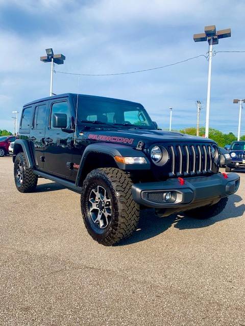

Here is my 2020 JLUR the day I bought it.
Jeep Wrangler JL Onyx JLUR LCOG Build JLUR Day 1
I knew the first thing I wanted to do was get a Rubi Steel Bumper so I could take off the end caps and go Stubby. I really liked the way the Rubicons looked with the end caps taken off and figured that bumper would last me a long time and meet my needs for a while. Could find a take off so I turned to Ebay...
Jeep Wrangler JL Onyx JLUR LCOG Build JLUR Mod 1
This one was a lot less than the take-offs I was finding on local Jeep pages and forums. It came with holes in the plastic covers for front sensors. I ended up ordering replacements from Mopar for about $25 each. For the most part it was the same bumper structurally, But I did find the Powder coat faded quickly and didn't hold up nearly as well as the OEM bumpers.

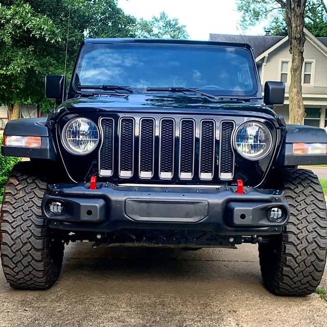

First Issue I tackled from the Drummond Island experience was the Headlights and also added a winch.
Went for the Oracle Oculus Headlights so I can actually see when its pitch black out and also installed a Smittybilt X20 10k Winch with Synthetic Line.
Jeep Wrangler JL Onyx JLUR LCOG Build JLUR Mod 6
Love the look of the Oracle Oculus Headlights and WOW do they put out some light. The beam pattern is actually pretty precise and doesn't just shoot all over blinding oncoming traffic. They are really well made and easy to install and align.

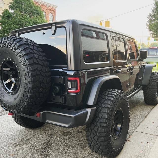

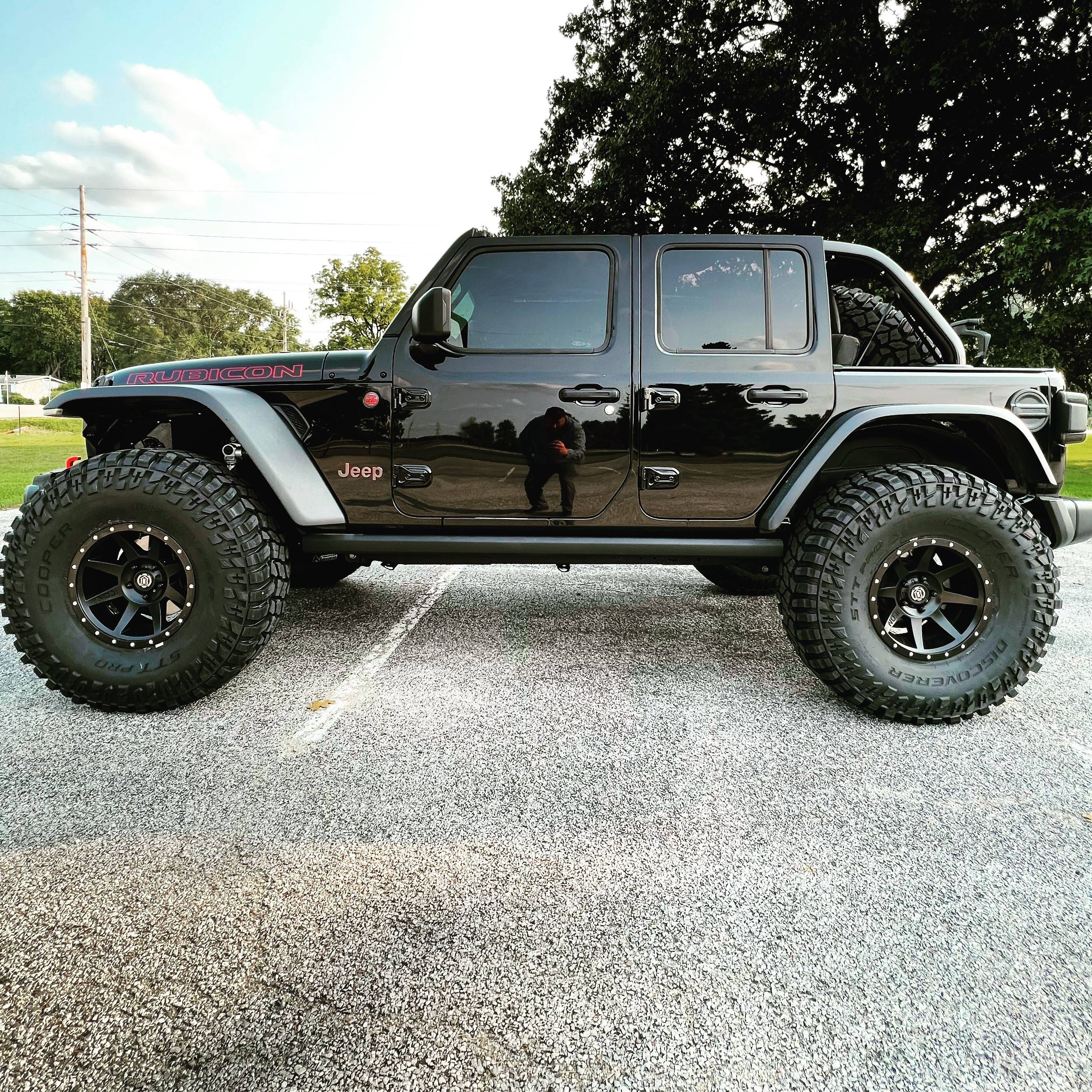

I knew the goal of this build was going to be 40s. So, after wheeling and driving on the previous set up for over a year I decided it was time to pull the trigger and move up.
Enter the 40" Cooper Discovery STTs.
Jeep Wrangler JL Onyx JLUR LCOG Build Jee
So, do they fit? Yes. Do they Rub like crazy when turning and over bumps? Also, Yes.
But... Do they look Super sexy? Definitely Yes!
There will be a lot of trimming and modifications to follow... but let's just admire how they look for now...

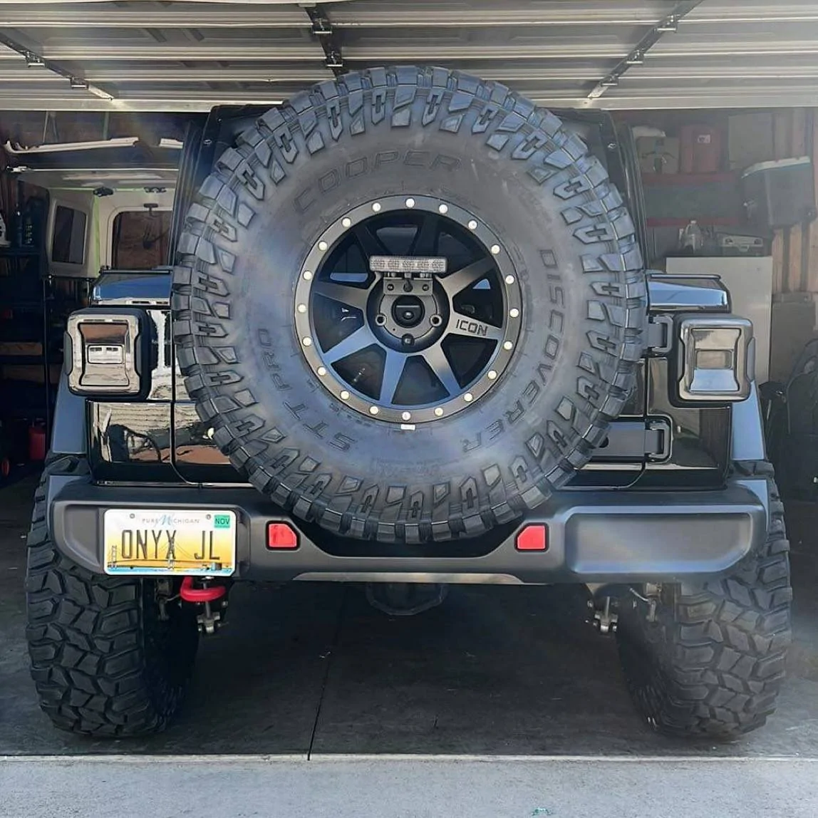

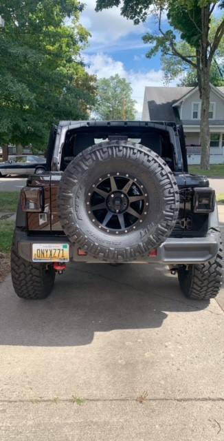

First Mod post 40s was to solve the spare tire location issue. As cool as it looked in the back, I needed to use that space for gear and daily commute needs... aka Groceries.
I went with the Rugged Ridge Spartacus HD Tire Carrier. I liked the cast design and how simple it is. Not a lot of things to fail.
Jeep Wrangler JL Onyx JLUR LCOG Build JLUR Mod 11
Was a pretty straight forward install and went really smooth. Mounting the 40" by myself was the most challenging part.
I also installed some Oracle Flush mount taillights.
Jeep Wrangler JL Onyx JLUR LCOG Build JLUR Mod 12a
Jeep Wrangler JL Onyx JLUR LCOG Build JLUR Mod 12b
These things are NICE. They definitely solved the Reverse light issue I was having from my previous taillights and now I'm not worried about losing them to a random tree branch or rock as much.
Now it's starting to REALLY look like the build I have in my head!

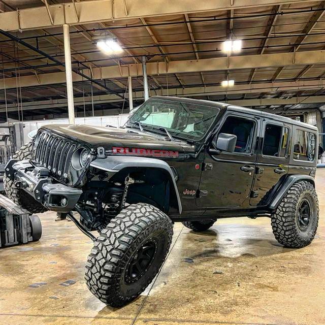

Most recently I was able to address some clearance issues. Installed the RK Adventure Series control arms all the way around to center the wheels back in the wheel well as well as a RK Front Track Bar.
Also installed 3.5" of the Falcon Progressive Bump stops to limit the up travel.
Did a LOT of body trimming and gave it the Ol' Forklift test...
Jeep Wrangler JL Onyx JLUR LCOG Build JLUR Mod 14
Jeep Wrangler JL Onyx JLUR LCOG Build JLUR Mod 14b
The limiting factors right now are the front sway bar links are too short keeping it from taking advantage of all the down travel and there is still some more trimming that needs to be done in the rear wheel well to allow the bumps to touch before tires.
Overall, I'm super impressed! Happy that there are just a few things to finish up to make this thing perfect. Got some parts on order and it will be going under the knife soon to take care of those issues.
May also have to trim the front bumper or replace it... we will see.

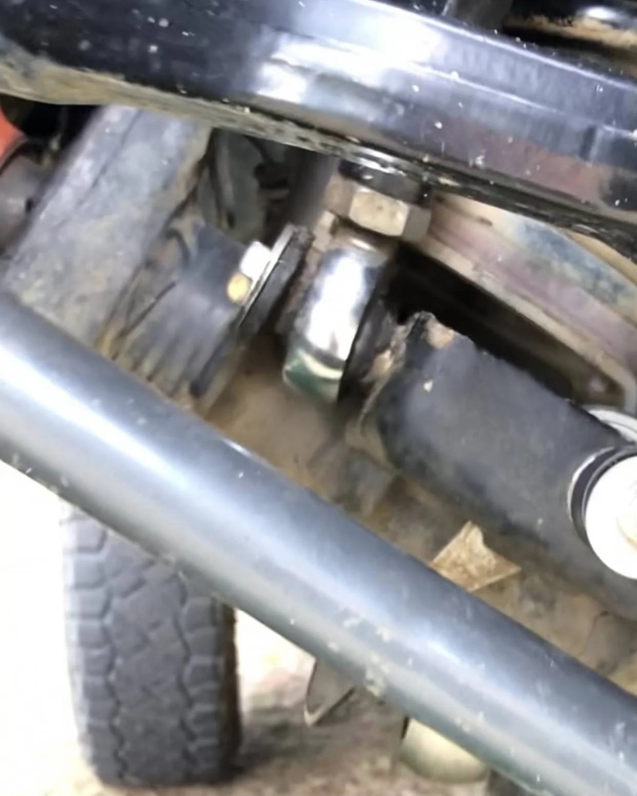

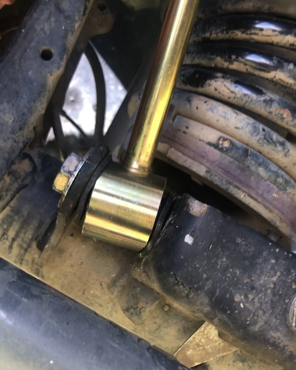

Nice rig…… if you’re going to be using the electronic disconnect I recommend going with a dbl heim link like RK no limits……
Oem style……
Jeep Wrangler JL Onyx JLUR LCOG Build 06BB7364-9FE0-448D-A94A-9F948CA5C80A
RK no limits
Jeep Wrangler JL Onyx JLUR LCOG Build 704F89B6-0E97-4B45-8400-2770C9AFF653
there’s more pics in my build thread , and also I talk about using these links versus unhooking old school, spoiler, there’s no difference in droop……..
