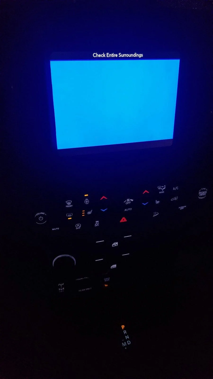

I have had the same issues since mid-June. Have been told multiple times by FCA that it is a software update, have been given multiple false release dates. Almost daily my screen and controls will freeze for a period up to 5 minutes before rebooting. At random times, I will get a blue screen instead of the camera when shifting into reverse. My SiriusXM favorites list never populates. I will get a notification that a favorite is playing, but when going to the list, the list is blank.
