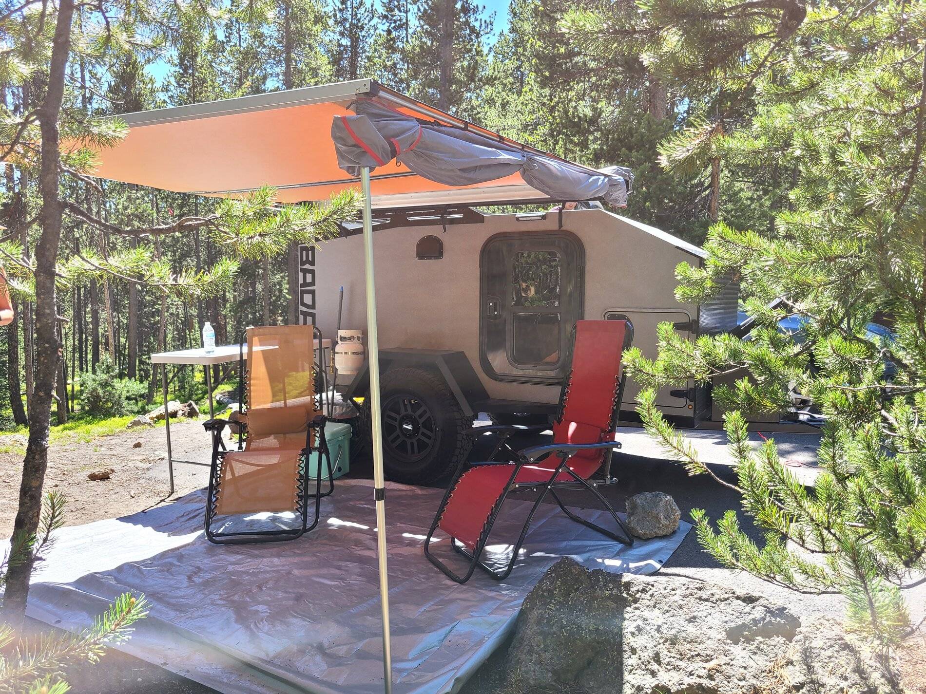

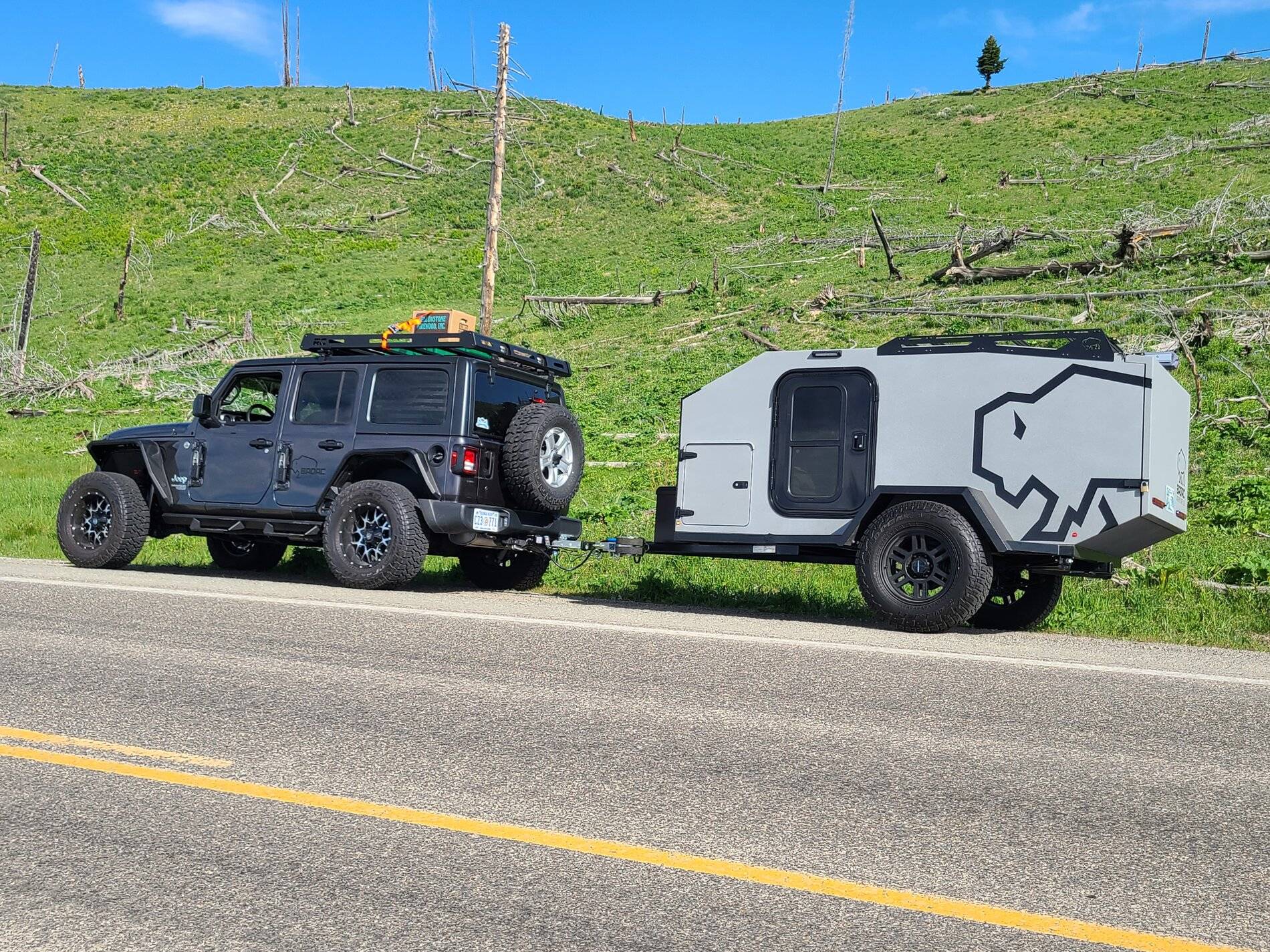

New to the Jeep experience and just completed our first outing to Yellowstone pulling this BADAC SD-10 Overlander Utility. This post is an attempt to explain the towing and MPG I experienced. Jeep is a 2019 Jeep JL Unlimited Sport with the 3.6 Auto/8 speed, 3.45 gears. 2.5" lift with 33" tires on 18" rims. I bought the Jeep as a second owner with 4k miles on it, and don't believe there was any computer flashing done for any adjustment on the tires, wheels or lift. ( Again I'm new to Jeep and really confused on whether that is even necessary or helpful)Trailer dry weight is 1600 lbs with 250 tongue weight. Loaded I would assume we had 1900 lbs moving down the road. Power and handling was outstanding, rolling down the highway at speeds greater than 65 vs mileage and shifting were what puzzles me. On the 1200 mile trip up to Yellowstone I never drove over 65 MPH and got an average of 12.5 MPG. What I found was for every MPH over 65 I drove, MPG suffered greatly. And moving 65 on an 80 MPH road was less than thrilling. Thus coming back, I drove mostly 70 MPH on the highway and averaged a mere 10 MPG. That being said at 70, I was hanging around 3200 RPM's and RARELY saw 7th gear, never 8th and found that it liked mostly hanging in 5th and sometime 6th. I had no overheating issues and again the towing experience was outstanding. My main concern was with the MPG and what I presumed was the tranny strain. I am at a loss if there is something I can do to help the Jeep move down the road a little easier, and/or get better MPG. Still having a hard time wrapping my head around re-gearing or if that would even be helpful. I do realize that a Jeep is like moving a brick down the roadway, but it just didn't feel right. Am I missing anything that would help.
Jeep Wrangler JL Turtleback Expedition and JLU Towing Capacity? 20210617_092018
Jeep Wrangler JL Turtleback Expedition and JLU Towing Capacity? 20210614_205648
Jeep Wrangler JL Turtleback Expedition and JLU Towing Capacity? 20210614_153204
Jeep Wrangler JL Turtleback Expedition and JLU Towing Capacity? 20210614_204819
Jeep Wrangler JL Turtleback Expedition and JLU Towing Capacity? 20210614_204808
