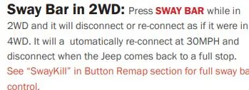

Same! The sway bar disconnect hot button doesn’t work at all, ever. However, now my sway bar disconnects randomly while stopped. I have a love hate relationship with my Tazer.
I can’t complain. The main reason I got it is to “permanently” disable the ESS garbage.
I'm guessing it mostly auto-disconnects when coming off the interstate. Mine did that for a long time.
I stupidly changed two things at once and it's no longer an issue:
  1. Latest firmware update
  2. Disabled the steering wheel button
I tested it last night and it seems to work just fine on first start up but after that it just kinda doesnt work which is hilarious since when are you going to want it all to work right after you turn the Jeep on.

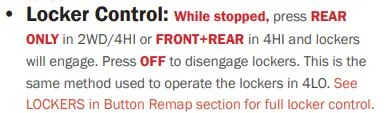

I dont have any of the buttons on the wheel set to anything that just seemed a recipe for disaster, just hitting the sway bar disco and locker buttons on the dash. According to the manual that should work just fine
Nope. You have to program the wheel controls to have anytime rear locker/sway bar control.

Always read it as itll work but if you want extra control you can button remap it as well. And like I said itll work on first start up as its written 🤷‍♂️

Well I don't disagree with you but I'm telling you how I had to do it because I thought the same thing you did because that seems to be how it's written... However my experience has shown that if you remap the buttons using the other menu it works like you expect it to.

Yea youre good, I tried on the way home today for lunch and it worked great with the stock switches, the sway bar disco anyway not trying the locker on the road lol. I did have it try to disco again when I came to a stop but that makes sense thats exactly how it works in 4wd stock if you go over I think its 15 and then back under.
18 MPH is the stupidly low limit. Drives me nuts in 4H on the beach.
