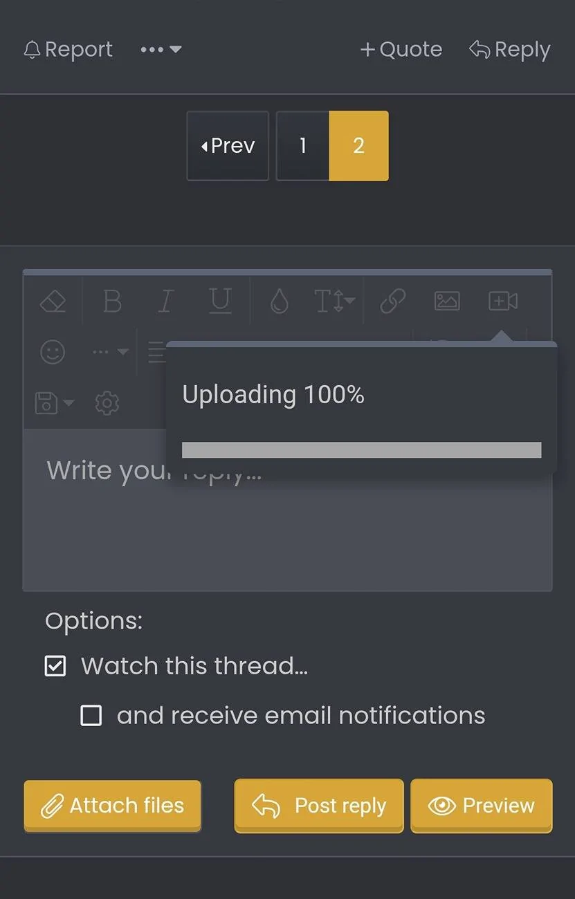

Tried to post a video of holding said button but it gets to 100 percent the bricks my browser.
