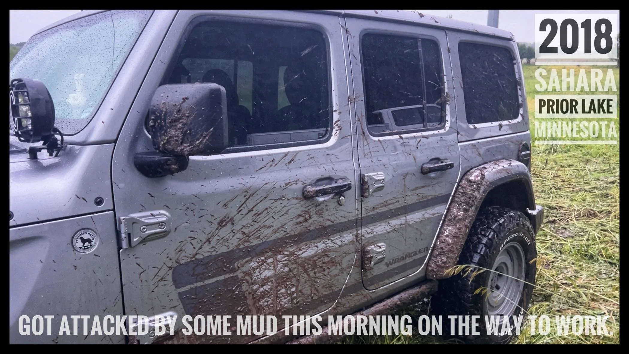

IMO:
Sport: Will get Wrangler owners 99% of the places they will actually go.
Rubicon: Once you own it you will no longer have to worry about passing another one and saying to yourself, "I wish I would have got the Rubicon."
Willys: Overall best bang for the buck.
Sahara: Not worth the added cosmetics
My ‘18 Sahara with limited slip in the rear and 4-Hi Part-time got me to work on-time this morning…painted fenders and all.
If I were buying again though, he’s right with the best bang for your buck. My next one will be a Willy’s.
