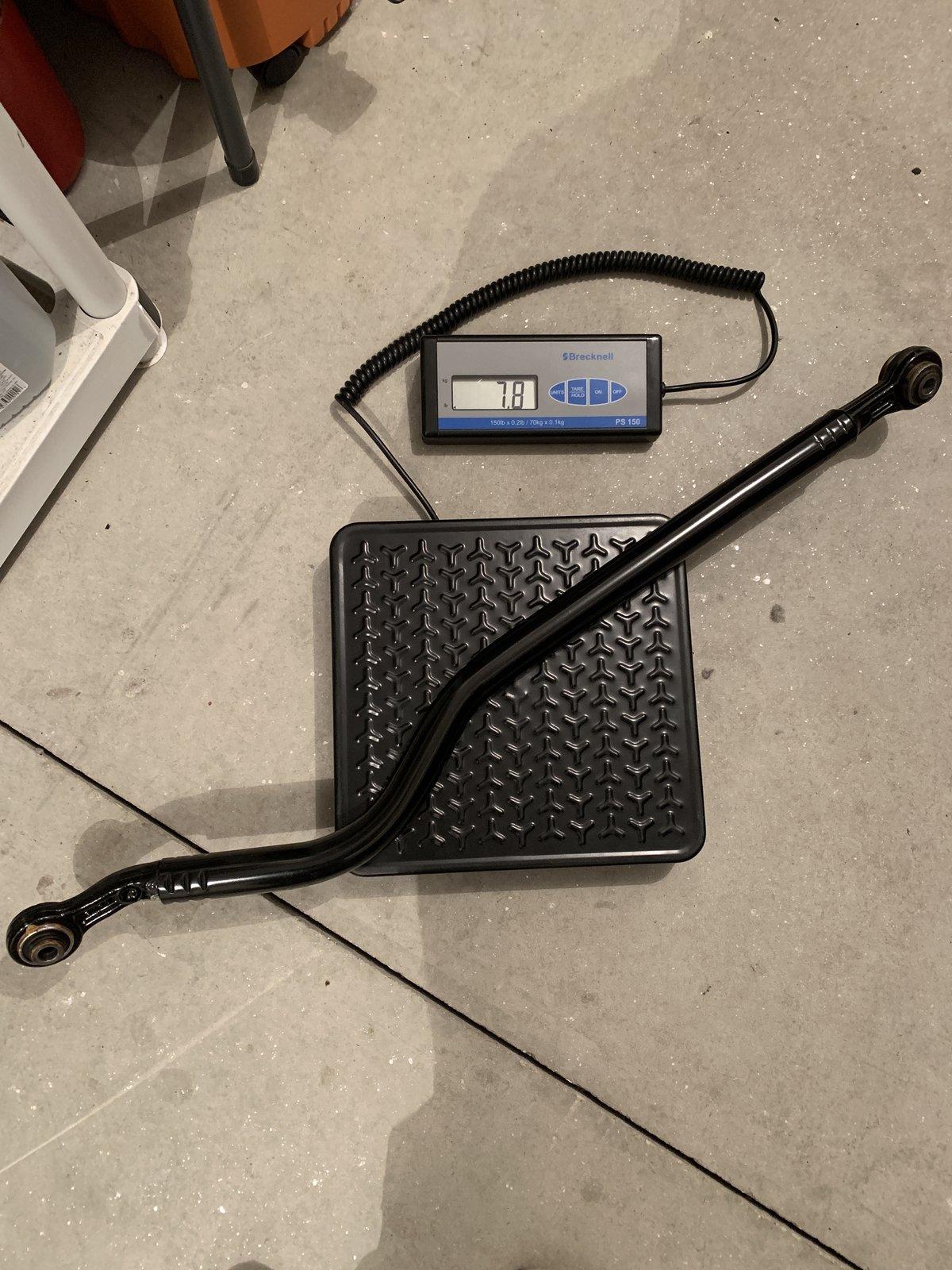

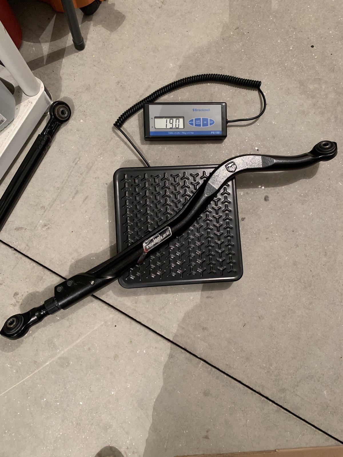

Your right it should come with front and rear adjustable track bars. Come to think of it mine would have been off even more because they were still adjusted from the 2” spacer lift I removed for the Mopar lift. The front was originally off a little over 1/2” so had I started from scratch it would have been off almost an 1” like yours. Start with the front and grab the rear later on, less important IMO. The Teraflex is a great bar, can’t go wrong with it, with any of them for that matter. I just like the ability to adjust it while it’s on the Jeep, and the fit and finish of Teraflex products are pretty awesome. They sell on Amazon with prime shipping so you could literally have it on Monday morning. Split the difference your off and adjust that over stock length and you’ll be good to go, straight again. Other than the axel being a little off center I couldn’t be happier with the performance of the Mopar lift. I absolutely hated the spacer lift with the stock suspension. Also, What are you running for tires and tire pressure? Here’s a couple pics of the difference in weight between the Teraflex and the stock front track bar.
Jeep Wrangler JL Track Bars Stress Me Out! 9FADCB2F-8ADE-4813-A338-B3B5275E5175
Jeep Wrangler JL Track Bars Stress Me Out! F70269C1-B5BE-4AA3-BDB3-45D5850E125A
