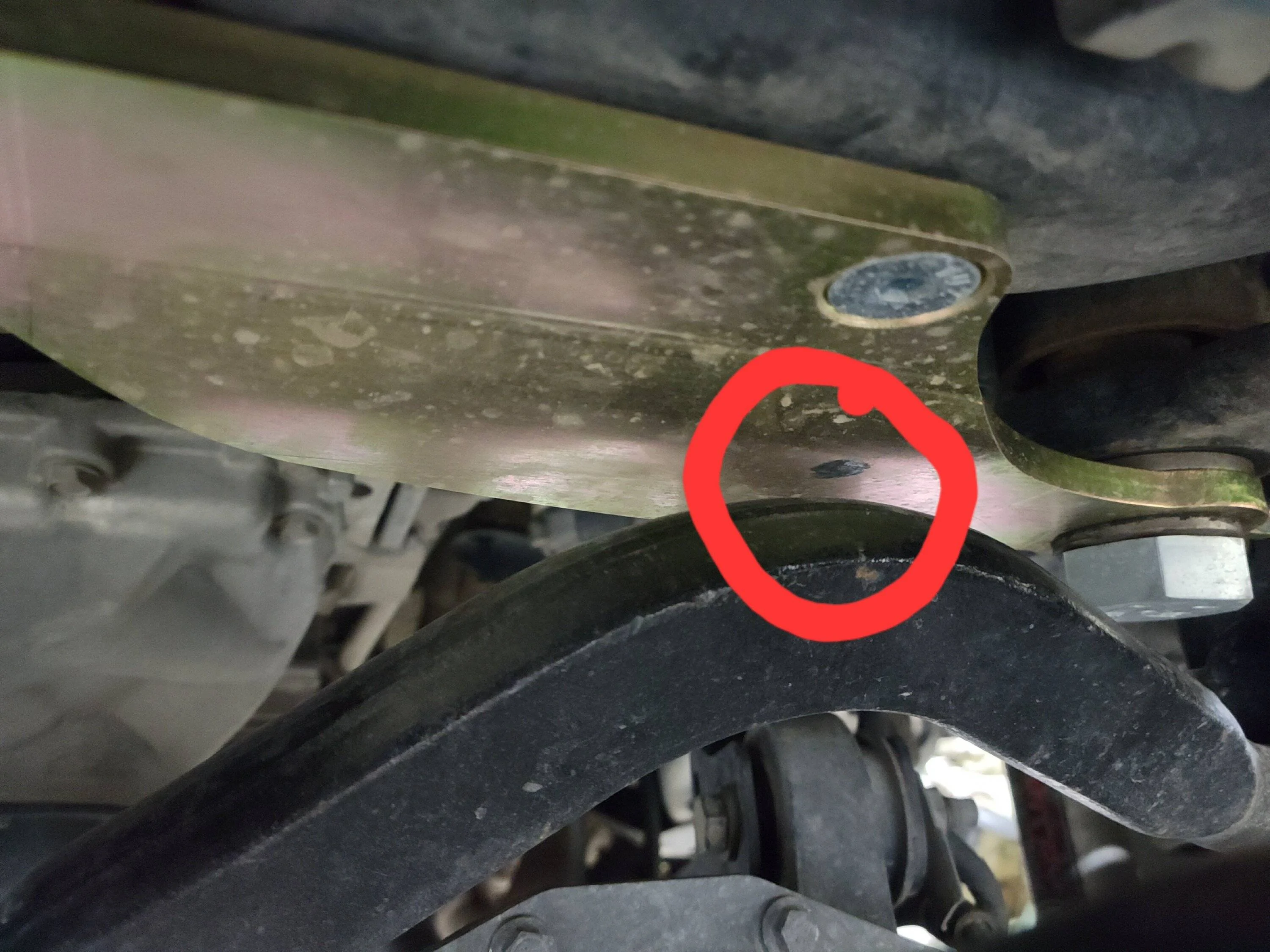

As title says. This can't be normal? Any solutions other than removing the brace?
Looking at the bar it does look like it comes up a lot higher than our bar does and maybe more than the stock one. It may not with with the bar without excessive bump stopping.

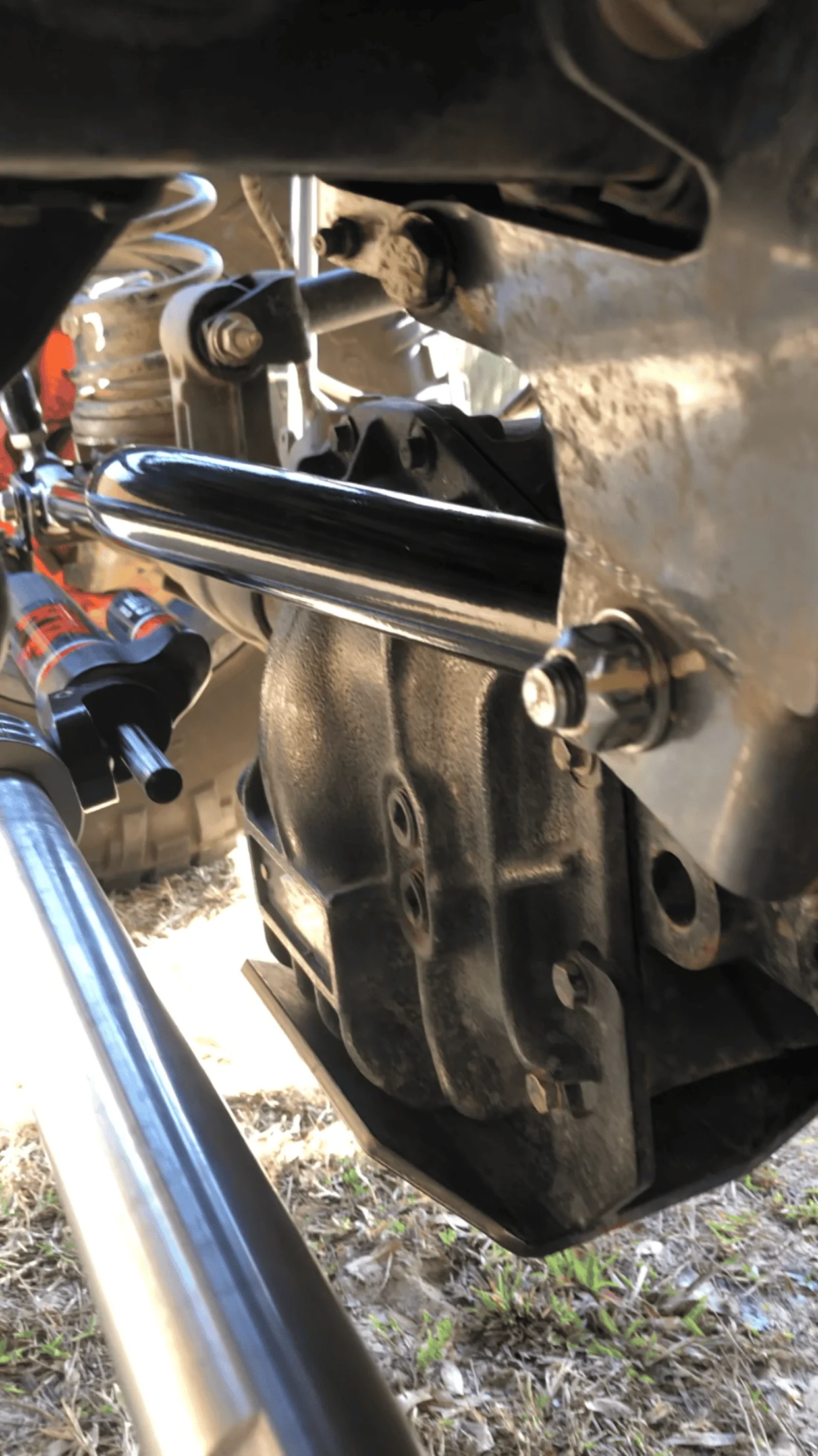

Metalcloak track bar:

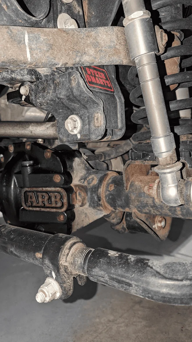

I run metalcloak trackbar but rest of my front components are Steersmarts YETI. The MC track bar works well with the tie rod mounted stabilizer setup. I only have about 2" of lift (Clayton 1.5 springs) and use the longer jounce bump stop from Teraflex 1.5 kit. I have not had clearance issues at full flex. I also use the ARB diff cover which protrudes a bit more that others.
Jeep Wrangler JL Track bar hitting secter shaft brace 1681409392770
if you have a sector shaft brace (i have the steersmarts one) it should still work.. very tight clearance though

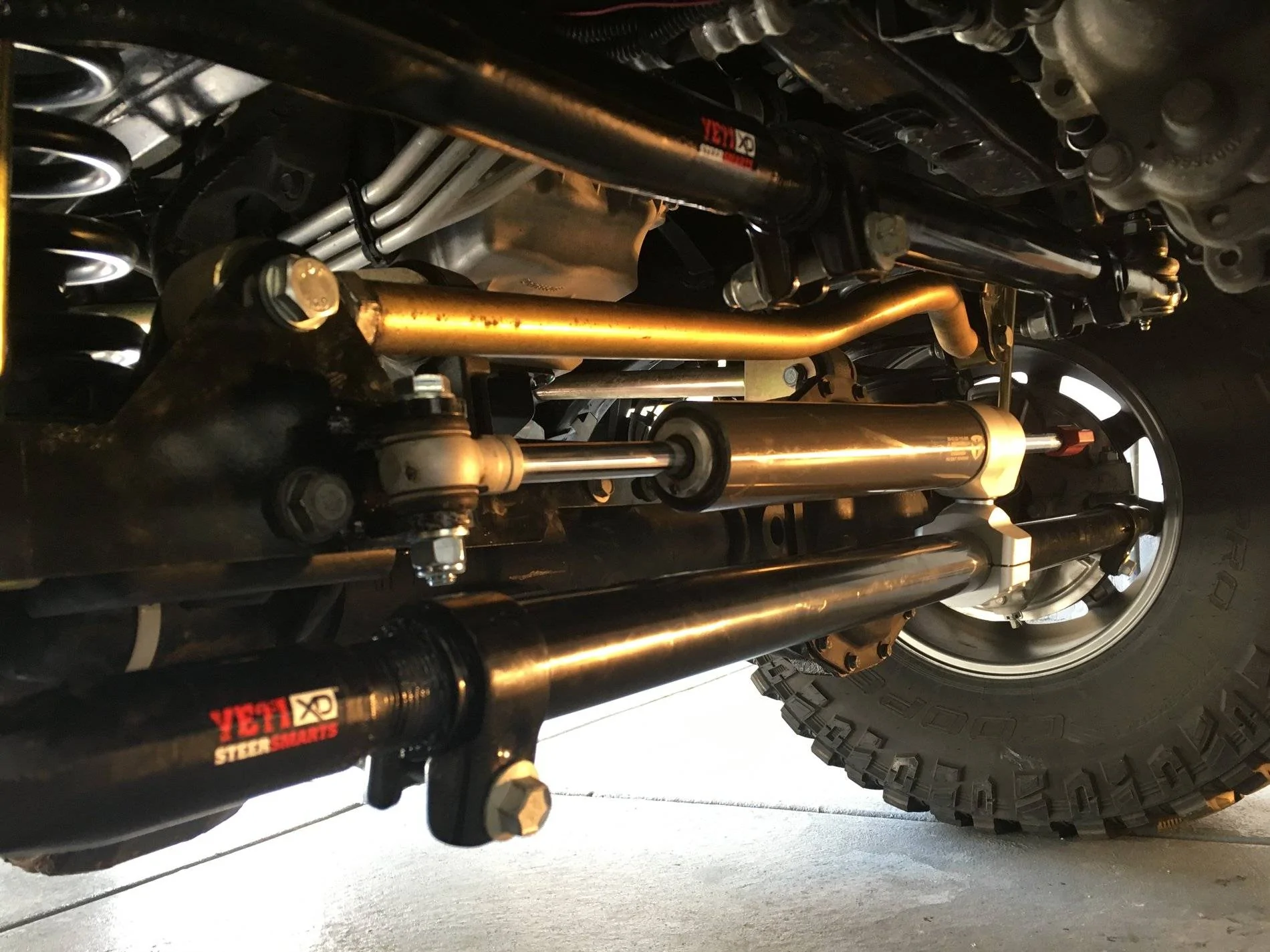

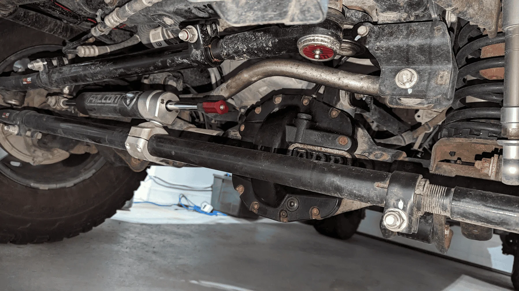

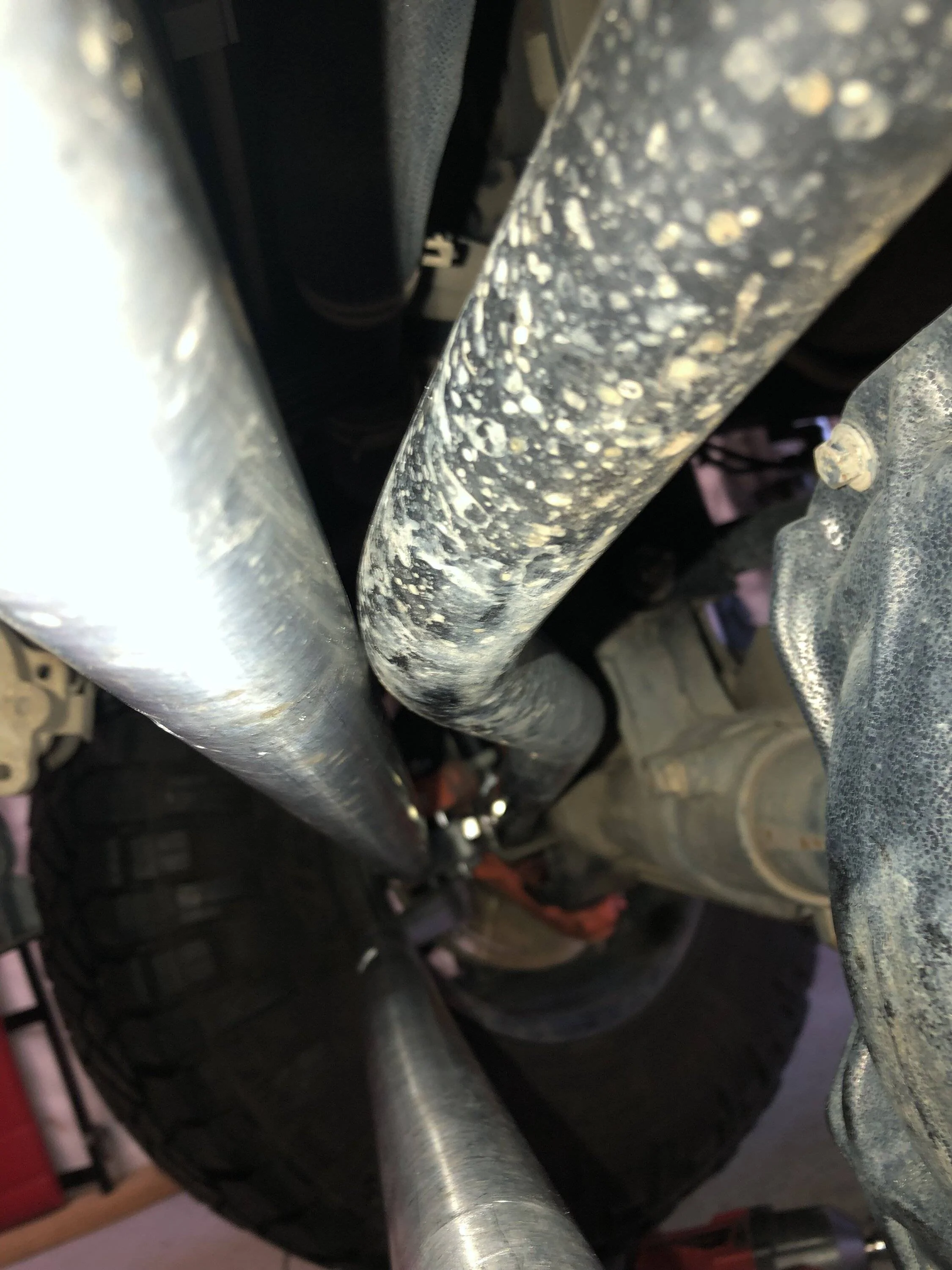

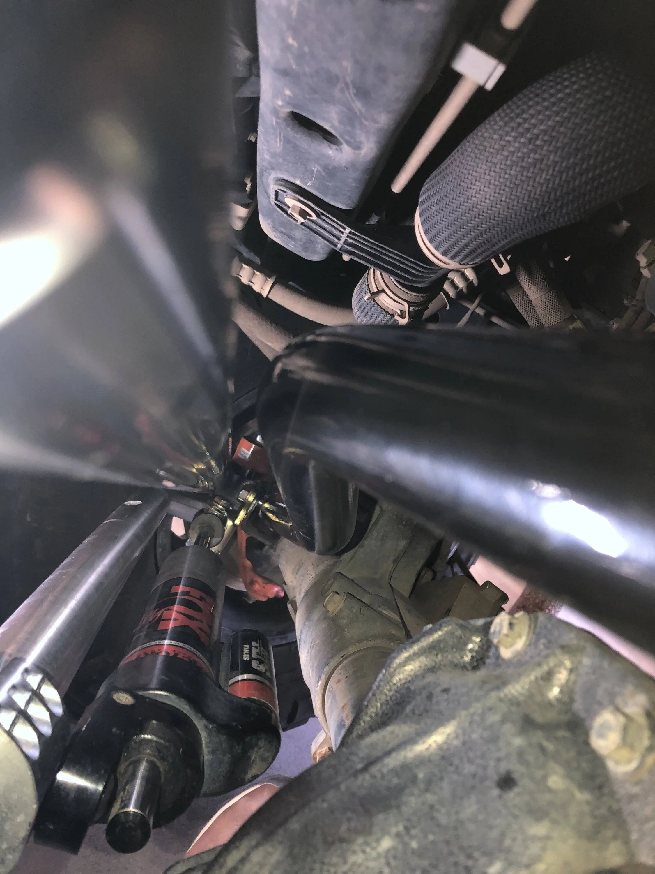

AnnDee, FYI, I'm pretty sure OP's TB is the RC. I found a pic from before I swapped it to the MC.
This is drooped at 28.5", looks like the RC bar has a higher bend as Will mentioned:
Jeep Wrangler JL Track bar hitting secter shaft brace 1681412101428
Jeep Wrangler JL Track bar hitting secter shaft brace 1681412181597
You are correct it is the RC TB. The bend is pretty aggressive!!

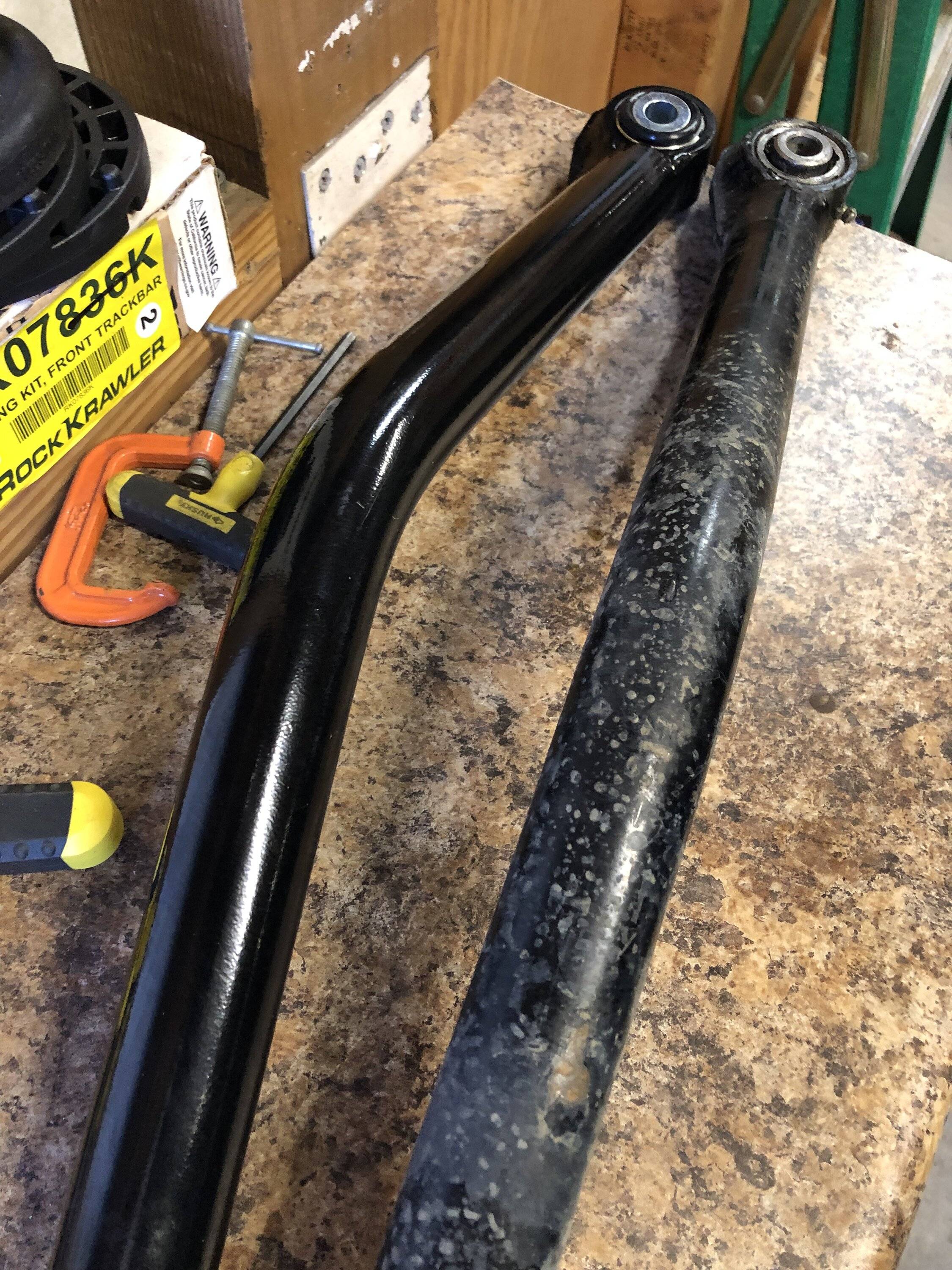

Yeah, I guess each company has its own philosophy on it…..The RK I had on mine was almost flat…., when they came out with their new aluminum steering they had to change the design a little, so now there’s a more up and around bend to it…….
RK was cool about it with me, they offered me a new tb for cost of materials…, but I wanted to make sure RCO keeps the doors open, so got one from Marcus, lol…
old bar…
Jeep Wrangler JL Track bar hitting secter shaft brace 749CFC91-0349-4E68-894F-70A9DF009C8C
Jeep Wrangler JL Track bar hitting secter shaft brace BAA15CB6-C1CD-426A-A82A-0171E31DB651
here they are side by
Jeep Wrangler JL Track bar hitting secter shaft brace BBD5E0C0-78D1-4EB8-9666-5942042A04BE
New bar……
Jeep Wrangler JL Track bar hitting secter shaft brace F1A7D0F8-D377-4102-B6ED-F60F9072BBE2
