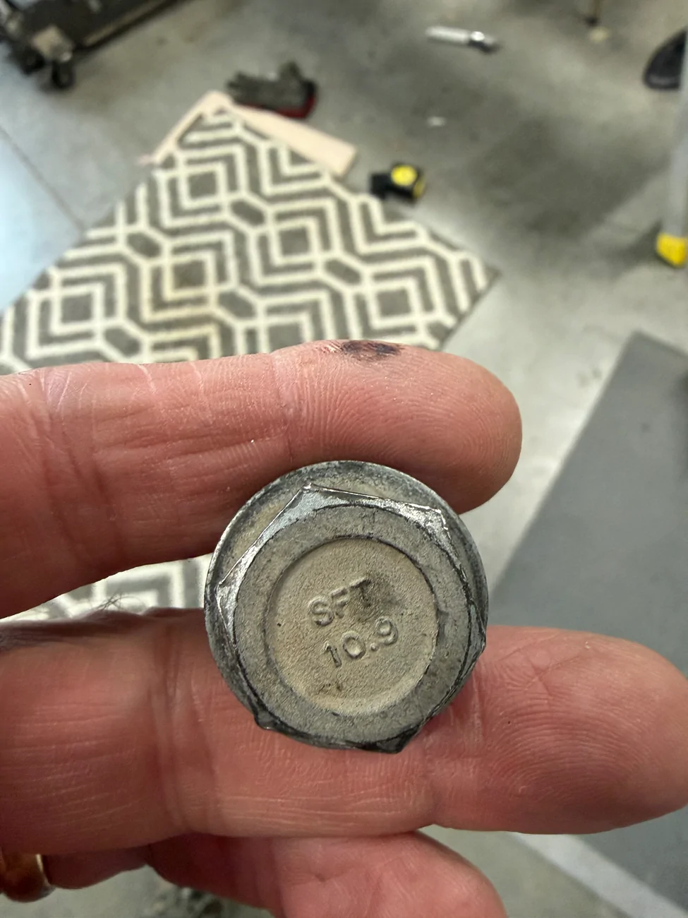

stock front track bar bolts are 10.9 not 8.8

I have done work on 3 of them in the last couple weeks a 23, 24 and 25 and all had 10.9. both ends of the track bar..this is from the axle end removed when I did a ss relocate.
Jeep Wrangler JL Track Bar Bolts Upgrade! tempImageBCuGRY
