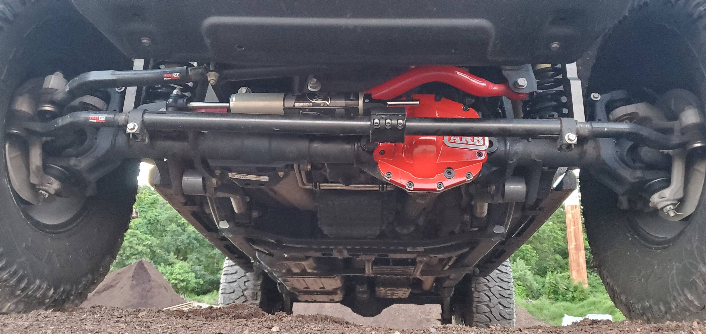

Steersmarts is a great company. I used to have their front track bar and steering linkages. Their track bars are very thick, and the adjustment clamps and pinch bolts occupy even more space. Elbow room in the front end is limited and there's a lot of moving parts, especially at stock ride height, so clocking those clamps to not hit other components is important.
Here's a pic from my original 2" lift setup...

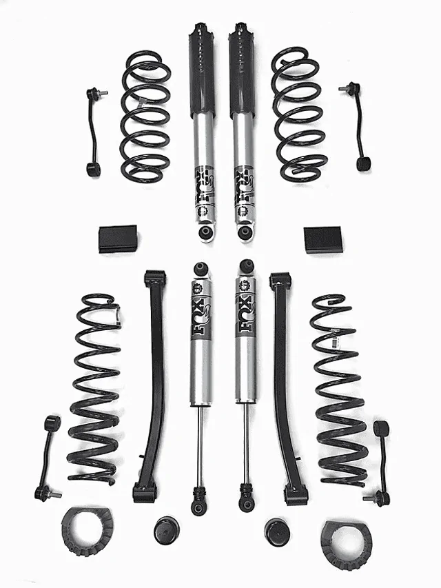

So, looking at your original post, you call them Fox Performance Products.
The Mopar 2" lift, which otherwise looks pretty stock, has Jeep Performance Parts branded Fox 2.5s.
Jeep Wrangler JL Track Bar upgrade 1687896339314
There are some aftermarket kits that may have included Fox "Performance Series" 2.0 IFPs:

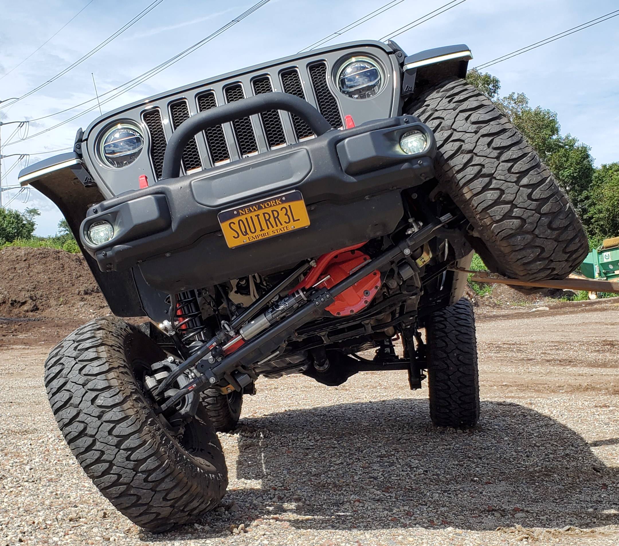

It's perfectly fine to use SteerSmarts track bars, and also their steering linkages, with other companies lift kits. I originally had those parts with a 2" Dynatrac Endurosport lift, and than the 3.5" Metalcloak Gamechanger lift...
Jeep Wrangler JL Track Bar upgrade 20200706_151830_resized
Jeep Wrangler JL Track Bar upgrade 20200831_111218_resized(1)
Just be mindful of how you orient the pinch clamps and bolts, to not interfere with other components throughout the range of suspension travel.
