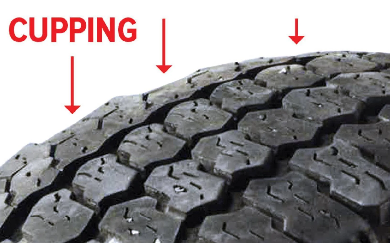

For my education, "cupping" means the center is worn out before the edges? If yes, wouldn't that happen because of over inflation?
No not exactly, what you describe is under inflation wear. Cupping is where the tire has dents in it.
