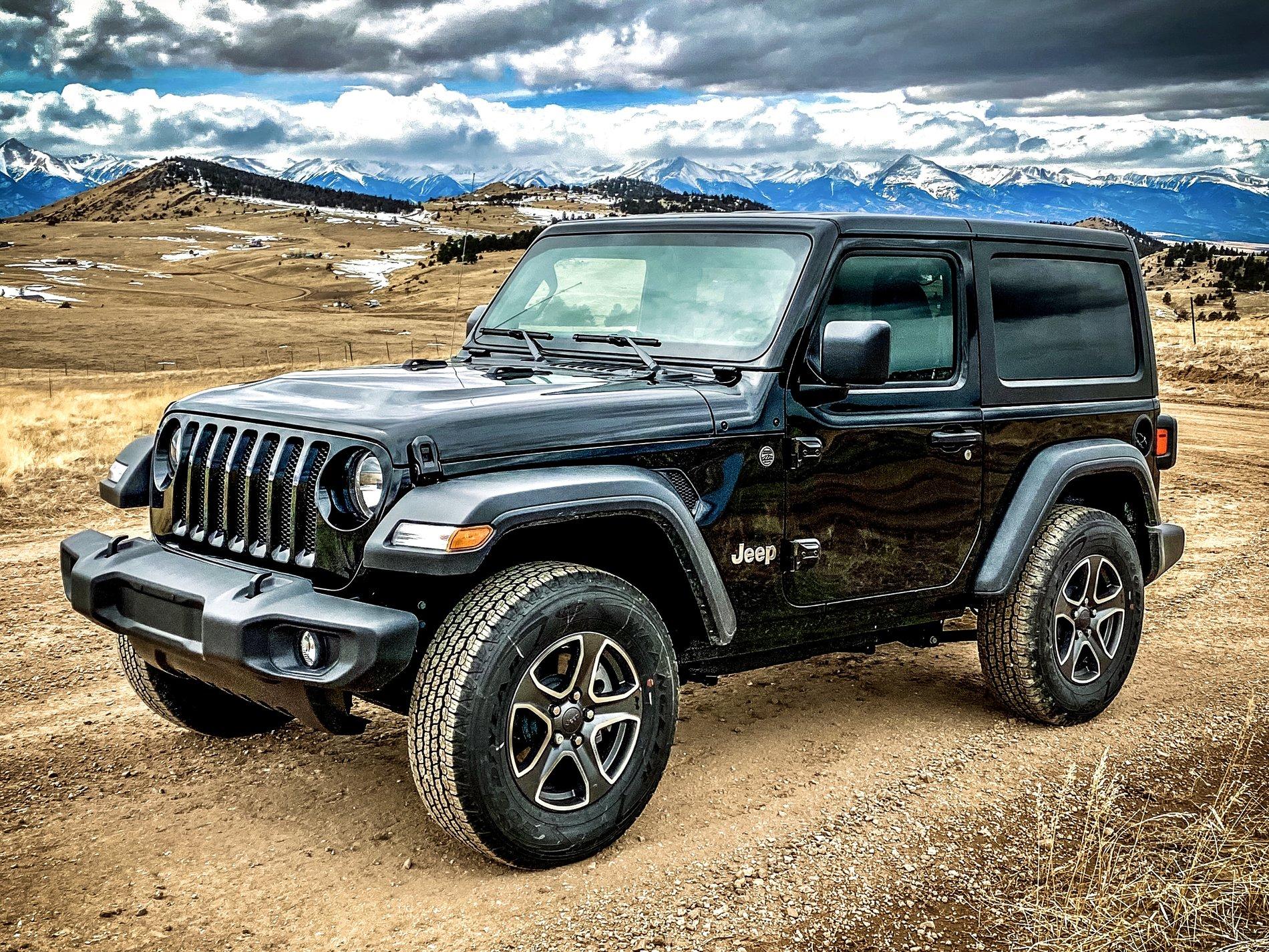

I don't think I've posted in this thread yet, so...
Bought my leftover new 2018 Bright White in June of last year and am having a blast with it. I was initially concerned about running a soft top in a typical Canadian winter, but the heater does a fantastic job of keeping the cold out. Even though it's a bare bones model (no A/C, pwr locks or windows, just the 8sp auto) I really like all the features and thoughtful, well laid out design. I got to use the Jeep tow strap and Jeep gloves a couple weeks ago when I got stuck after pulling over too far when stopping for a pic. Had to call a friend with a Ford F-150 to come pull me out, but at least he agreed that aggressive tires and diff locks probably wouldn't have got me out on my own.

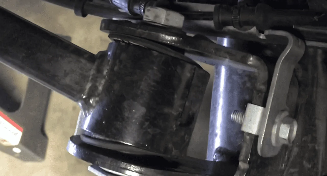

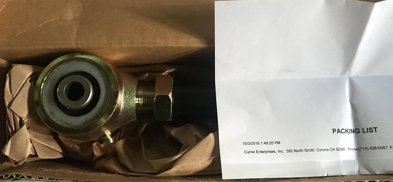

Hopefully all is well with everyone in 2 door sport land! I've been taking advantage of the corona holiday and have been going through my garage. I found a set of brand new rear uppers that I bought over 3 years ago for my JK and totally forgot about since i eventually ended up doing something else.
Jeep Wrangler JL The 2Dr Sport Only Thread OBBVwTd
I just ordered a matching set of rear lowers right now because there are a couple things I wanted to address, but wasn't planning on spending the money on.. until now since I already have half the parts!

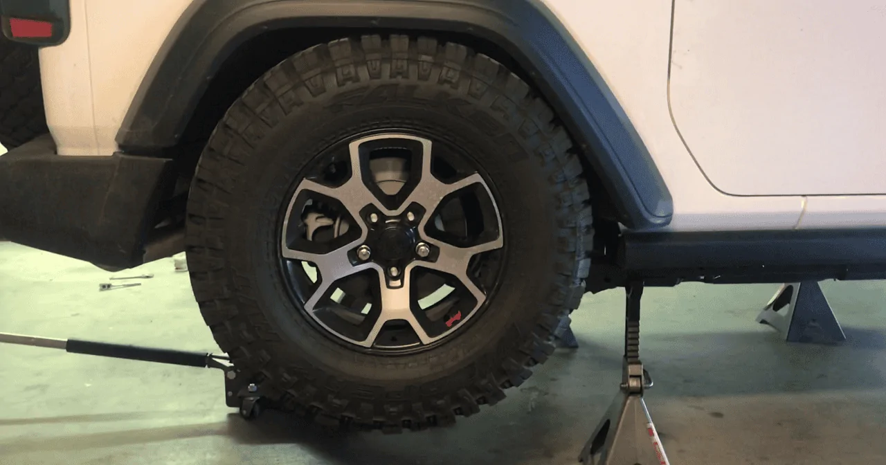

First, there is definitely some bind going on in the rear, even though I'm only running 10 inch shocks. I'm losing a couple inches of droop on one side, when the other side gets stuffed up. Once the axle gets to a certain degree of articulation, the drooped side starts lifting up. I'm like 75% sure this is the control arms, because they seem to be pretty maxed out. This is not even at full articulation, this is just as much as I could get before it bound up:
Jeep Wrangler JL The 2Dr Sport Only Thread 3ifIqxO
Second, the wheelbase could use some adjusting. Even totally stock, stock control arms, stock bump stops, stock springs, you can see how far forward the wheel is in the wheel well at full bump. So I'm going to push the rear axle back as much as I can. Once the lowers come in, I will document everything, and share my lengths and adjustments with you guys. The front doesn't have any of these problems, the axle position is perfect, and there is no bind. So I will be leaving the front stock until the bushings blow out or the arms get bent or damaged.

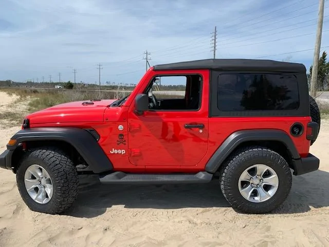

Just swapped the 35's for 37's this week.
SharkBite...37s look awesome!!! How do you like them so far?? You still running stock gears, axles??
