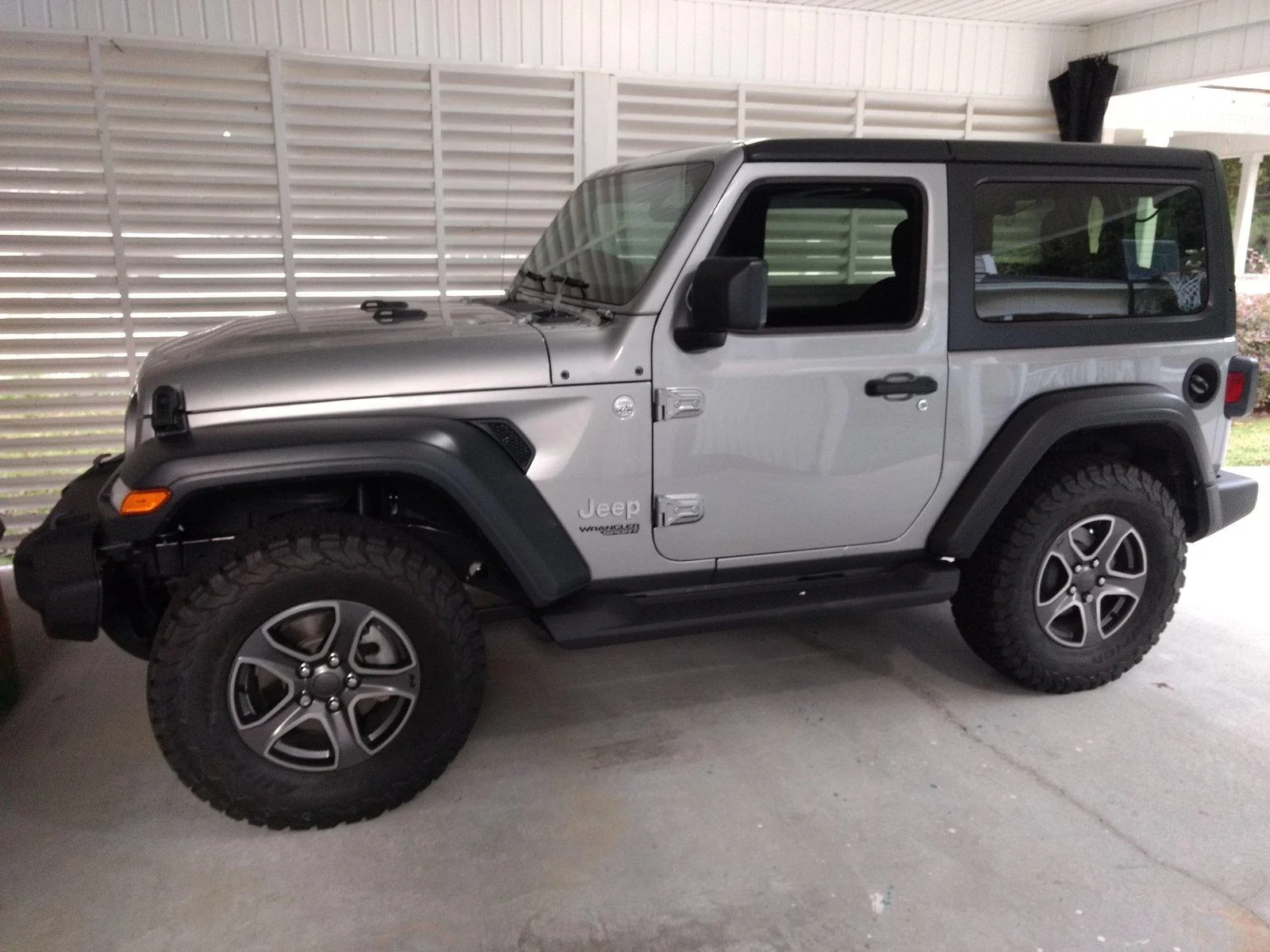

on my sport the rear is about 3/8" lower but with hardtop off it pretty much sits exactly level. I went with the teraflex 1/2" spacer to just get back the fender clearance I lost when I went to the rubicon takeoff bfg's, and for $50 the price was nice. I thought long and hard about going with the 1"-1 1/2" but it was $150 and for not much more i figured I could grab some rubi takeoff springs and shocks down the road. Overall the small spacer and tires gave me about 1 1/4" total lift

Here is my 2 Door Soft Top
  • COLOR: Punk'n
  • ENGINE: 3.6L V6
  • TRANSMISSION: 8-Speed Automatic
  • PACKAGES: Cold Weather, Trailer Tow and HD Electrical
  • MODS - WHEELS / TIRES / BRAKES: JL Rubicon Wheels and Tires
  • MODS - EXTERIOR: Mopar Aluminum Side Steps, Mopar Fuel Door Cover
  • MODS - INTERIOR: Mopar Sill Plate Covers, Mopar Grab Handles
