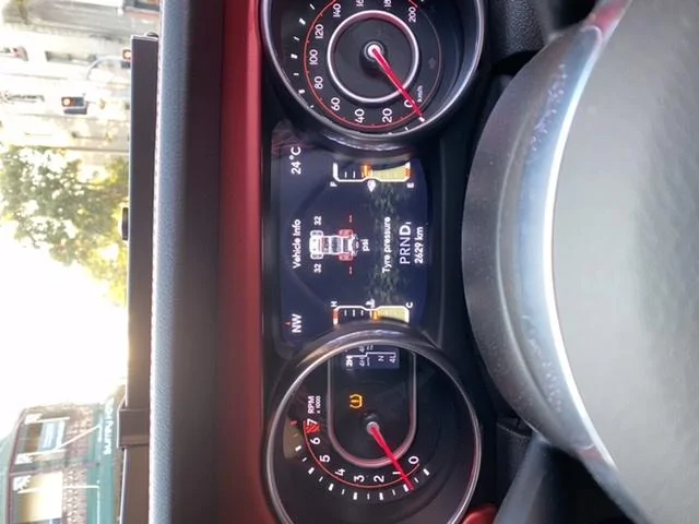

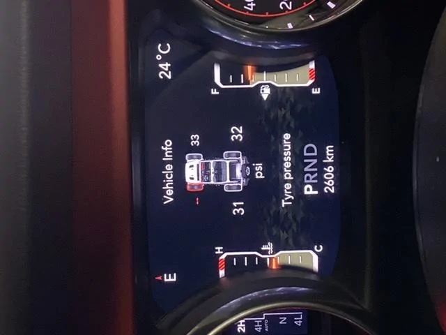

I purchased a JL lite and upgraded to a mini and had it installed after upgrading my tires to 37”. I was able to set tire size and psi settings. But the tire sensor warning never goes away. I’ve tried setting it between 28 and 30 psi on both front and back and have also unmarried and remarried the tazer. I have also noticed that I am getting the proper tire sensor readings; but those sensors have also gone out before every so often but then comes back after a while. I am not sure if it makes a difference, but I am also running weighted beads. This problem has never happened before the install. So wondering if it’s the Tazer or where to begin. Any advise would be much appreciated.

It's a common problem... happened to me not too long ago. Set the pressure higher than the threshold until the warning goes bye-bye, then set it to where you want.

Thank you so much for the advise. Will go pump my tires back up to 38 psi before bringing it back down. Having said that, did you leave your current Tazer settings at 30 psi (or what ever the setting was at before) when you did this? Or did you change that around first?

I put mine at 22psi & run mine around 28-32psi (fluctuates with temperature). I figured if they go below 22 psi, something needs a looking at.

I left my Tazer at the lowest setting (I don't recall what it is).... warning never reappeared.
