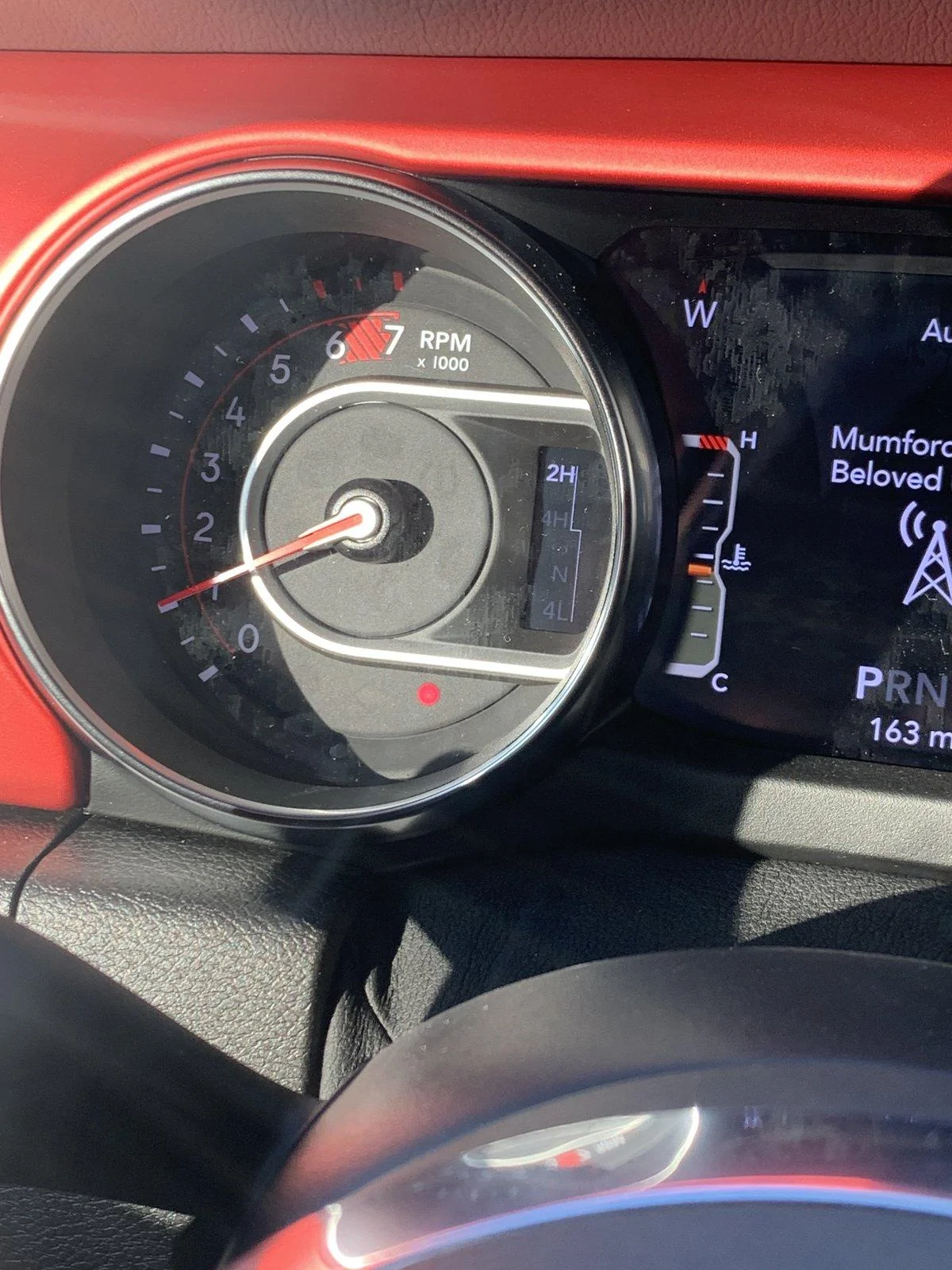

Anyone know what this res light is, has been on since I turned on the car this morning?

It’s the security ligh it’s support flash while alarm is arming.. is it supposed to stay solid red when vehicle is in use?
Sounds like you did not properly reboot after changing settings. I would reboot as written.
